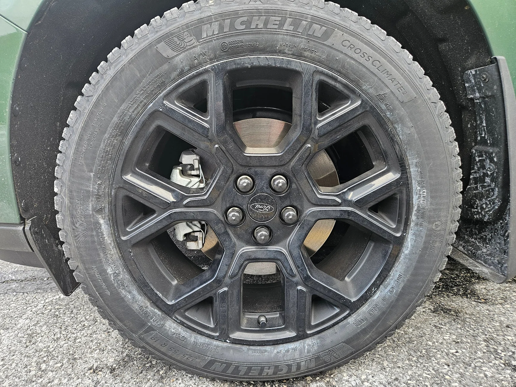

Been raining quite a bit in SoCal so I've started to get some wheel slip even crusing at 65mph while going straight.
Time for better tires, maybe give the Michelin Crossclimate 2 a shot? Sounds like you get freezing temps and wet, so the leading all-weather tire should be great for you.
Ford Maverick TCS off for rain/ice? 20260102_092220
X's 2. These tires are excellent in wet/slick/snow. Best all year/ all-weather tires i have ever owned.
How is the mpg hit on the hybrid?
Ryom
Aug 15, 2024
610
1,090
PA
2025 Maverick Lariat 4K BAP Eruption Green
I'm not sure, we've been in a cold snap here with the temperature well below freezing and I haven't filled the tank since I had them put on. But the trip computer is suggesting that the mileage I'm getting is pretty close to the Goodyear Territory HTs that came with it so far. The real test will be seeing if I can get a 50mpg trip to work with them in the summer, which is my record for the Goodyears 😁
That said, if you're looking for high MPG tires, there are definitely EV-focused tires out there that really spec for low rolling resistance. I'm OK with sacrificing a few MPGs for what the CC2s bring to the table however. I'd prefer the extra braking performance over getting another one or two MPG and sliding into something.
On WhatTyre, the Goodyear Territory HTs all have an 'A' rating for efficiency, while the Michelin CC2s are mostly 'B' rated but vary from 'A' to 'D'. So I'd expect to take a hit from stock.
