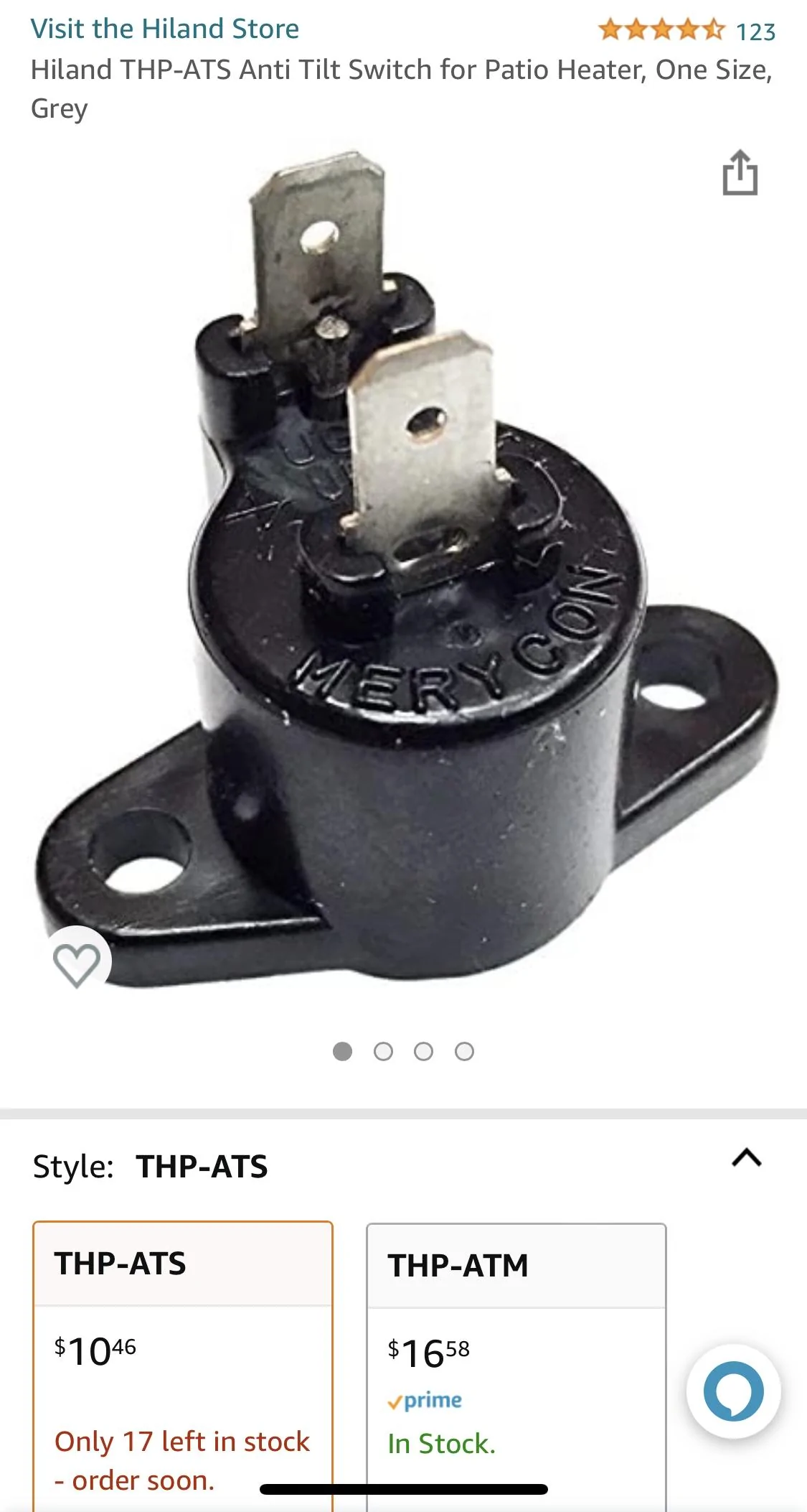

I plan on making my bed lights work with a mercury switch. The switch I got is from a patio heater so if the heater falls over the switch opens. So I’m going to place it in the tailgate so when the tailgate is flat it will close the switch turning on the lights. Then have a switch on the side so if I don’t want them to come on I simply leave the switch in the off position and if I want them to work with the tailgate just leave the switch on. This is the switch it’s very small like maybe the size of a marble so I think I will be able to make a bracket off of the handle inside the tailgate somewhere real easy.

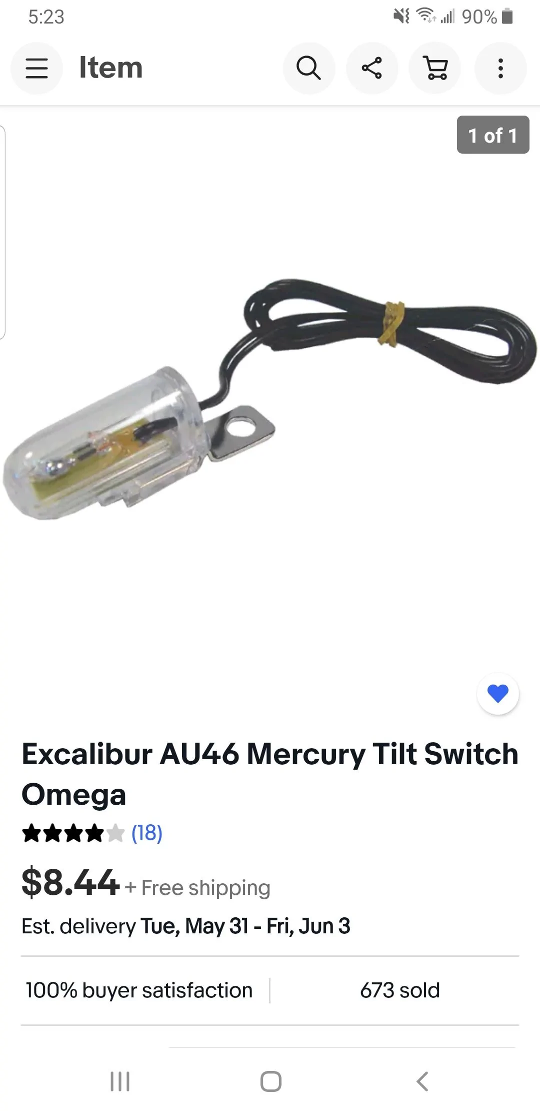

Yes a mercury switch. A simple bulletproof design that never wears out. Thank you for the idea. I do believe I will be going that route as well. I will route the wires out of the tailgate alongside the tailgate lock wires. I also planned on having a seperate on/off switch in case I didnt want them lit up. I will look at different ones till I find which one I feel will work the best for me. Heres a sample of one I think may work for me.
