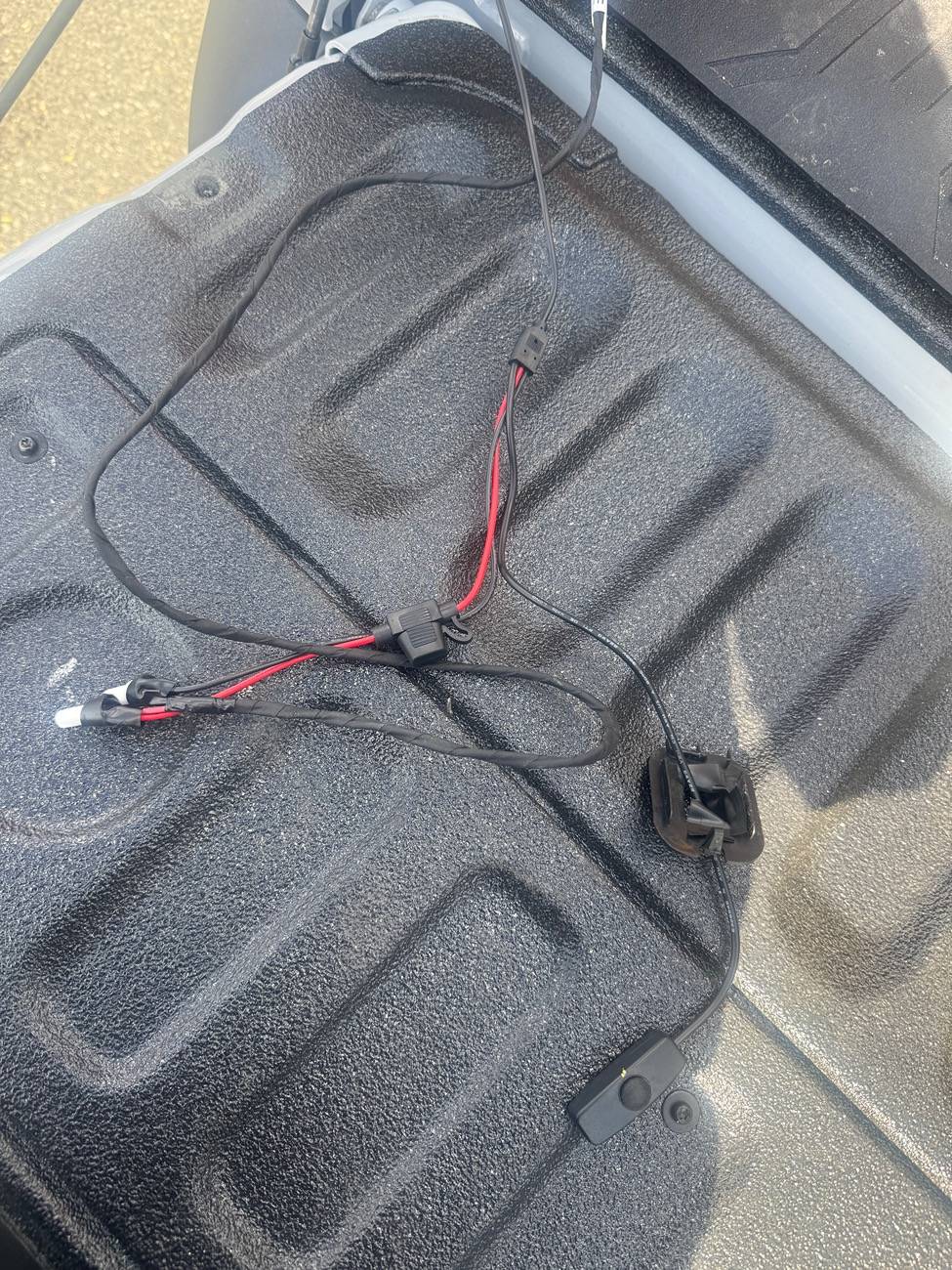

Hello I just installed a bed light(nilight)just following YouTube instructions lol went well but I was wondering how can I change the switch to toggle switch. Thanks.
current set up.

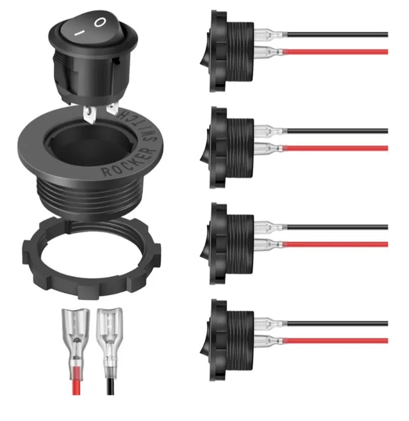

Toggle switch I want to put

I can go with that switch also. I just wanted to know how to replace it with my current ones. 😬

Where does the switch it comes with hook up to the leds?

If you cut that switch off right at the switch, and strip some of the black insulation back, you should find the (2) wires you need to add terminals to and attach to the new switch. No polarity to worry about.

This part right?
