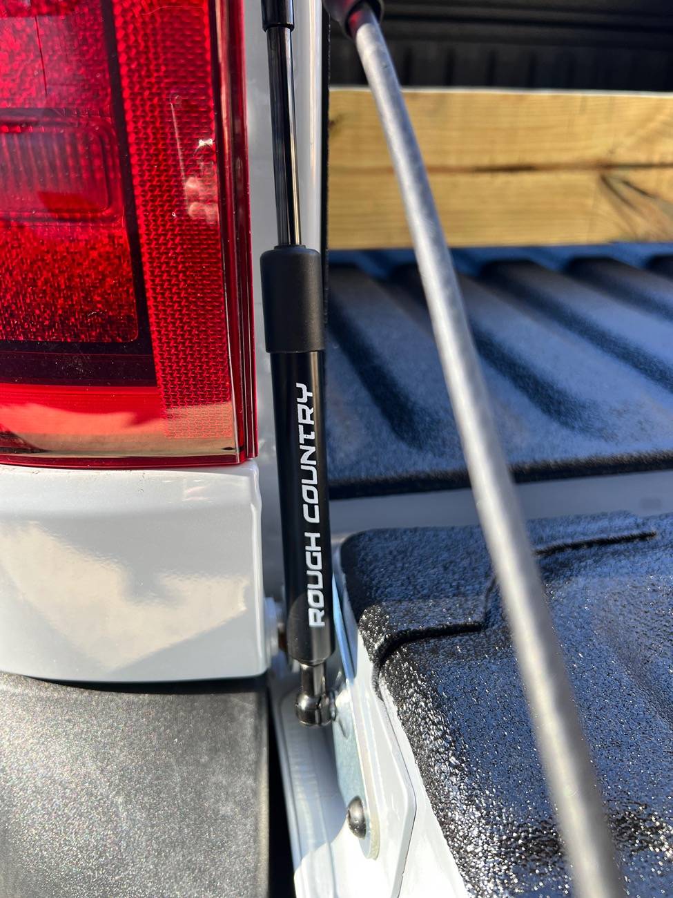

The linkages I was referring to would replace the cables for limiting the tailgates travel. I've noticed the tailgate seems to go past "level" when a load is on it, I'm nervous about cables breaking when the tailgate has a load on it, and Mavericks have had issues with the cables not being the same length. One cable takes a disproportiante amount of the weight when it's like this, and can cause a twisting stress is the tailgate when it happens.
The linkage (arms) I am thinking of were used for many years and seemed like a good idea. There may be a good reason cables are better, but I don't know what that would be.
In my example below, if the cable were to break my snowmobile would certainly be put in a dangerous position for me and other motorists. That's my fear. I'd be more comfortable with the old style arms in that instance.

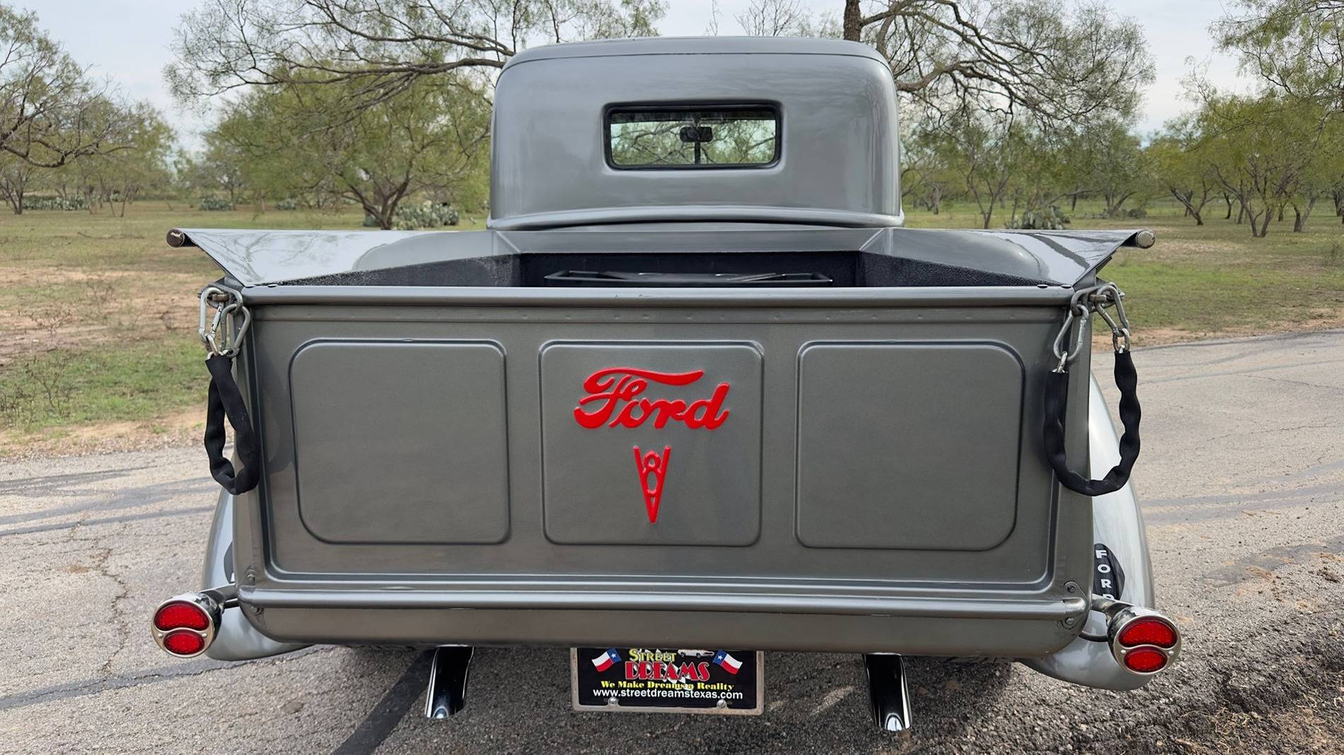

I remember on older trucks, atleast '70's and prior Chevys, they had metal arms that were used instead of cables. These seemed to work good. They could be disconnected and the tailgate removed easily, they were easily inspected for corrosion and wear, and they certainly could carry loads.
Why did they go way from that design? Was it cost alone? They didn't take up alot of room, as they were fairly narrow, and I believe they might even be able to fit in the same area the Mavericks cables do.
I had an '95 Chevy that broke a cable. It was corroded and I couldn't see the corrosion as it was covered with rubber. At that time I thought it was a poor design.
Perhaps I'm missing something? I'd be interested in replacing my cables, if an aftermarket design similiar to the earlier ones were offered for the Maverick. I'd certainly be less worried when carrying a load on the tailgate, which happens on the Maverick alot more due to the short bed.

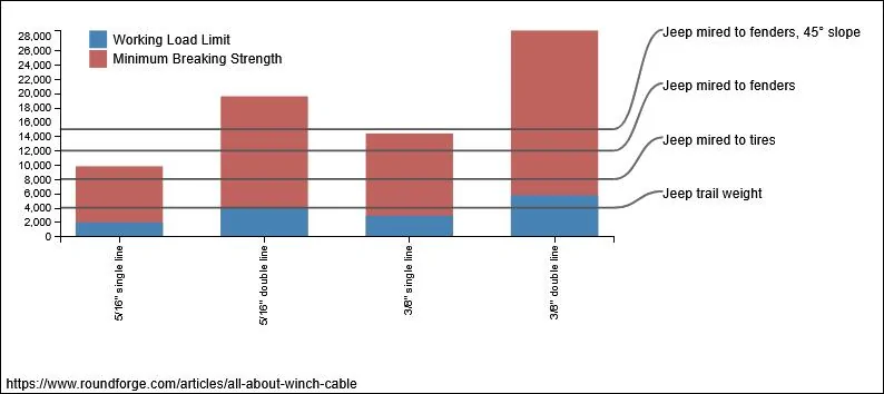

IMO cable strength on the Maverick is moot. I will bet the cable is far and away stronger than the attachment points and/or the tailgate.
Shock96
Jun 22, 2024
133
104
Olympia, WA
2025 Maverick Lariat Hybrid AWD
The thing with winch cables is not only are you pulling the truck/Jeep whatever but getting it unstuck.
