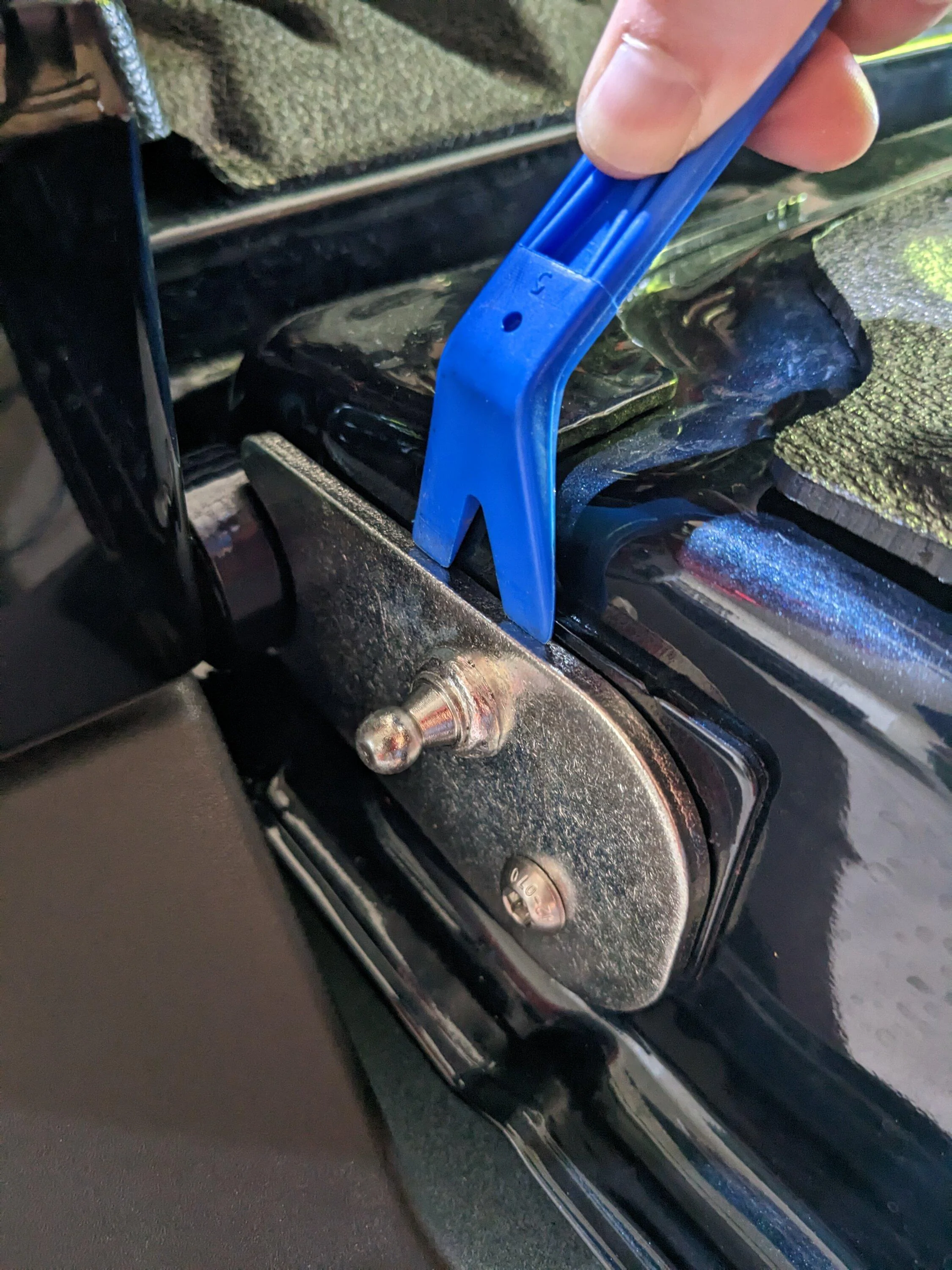

Finally got around to installing mine today. Was pretty easy, the trickiest part, as others have noticed, is the bottom plate and nut that goes in the tailgate. I found using a plastic trim tool between the plate and metal to keep pressure on the nut and plate made tightening it relatively easy:

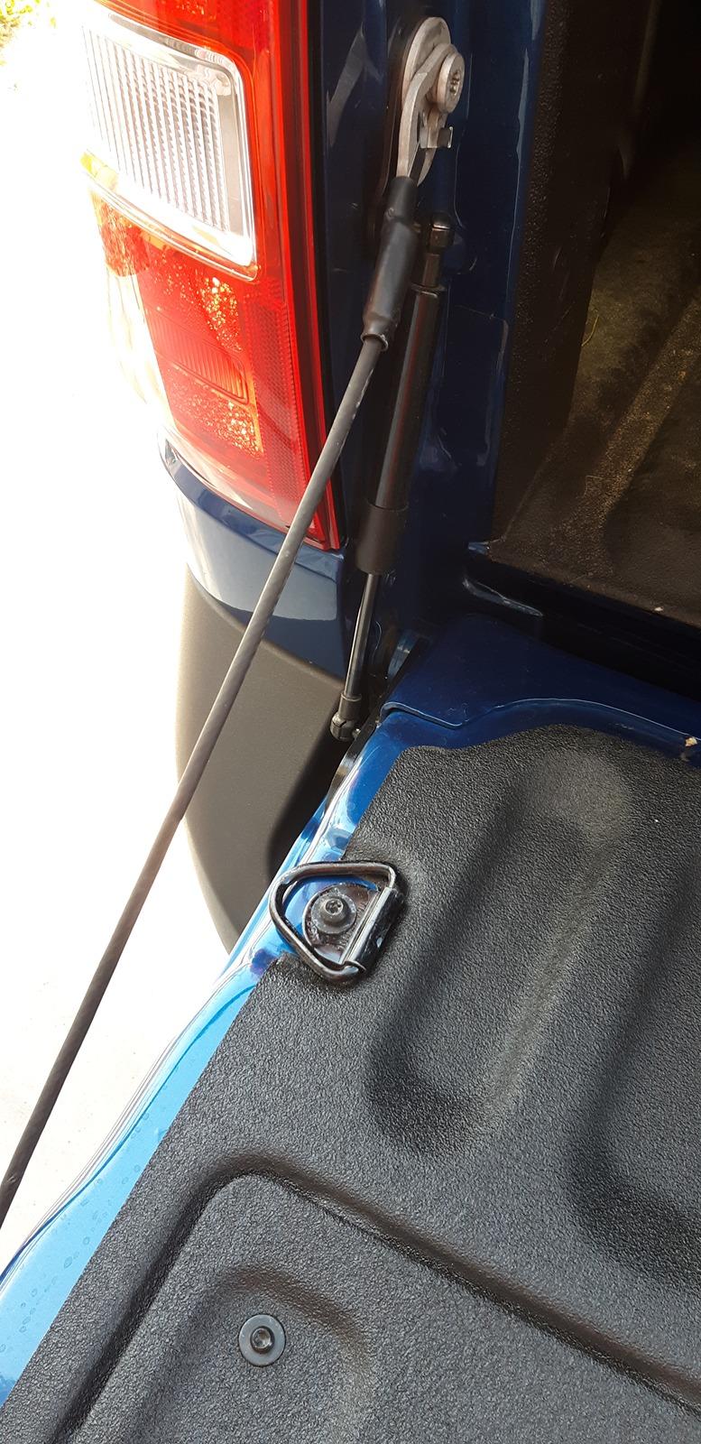

Lane
Lane
Jul 20, 2023
426
1,004
Central Wisconsin
photos.app.goo.gl
2023 Area 51 Hybrid XL, 2006 VW Jetta Smyth UTE
The cables get jammed by the bottle openers all the time. I'm planning to remove them just for that reason. If you've done the assist kit, do the cables catch on that?
I've had no problems with the assist strut contacting the cable.
If you'd like to re-add a tie-down bracket that clears the assist strut, I've made a few and have them for sale here.
Ford Maverick Tailgate assist image1-
Also doesn't interfere with the motion of the cable or jam it up, if that's a problem you're having with the factory bracket.
