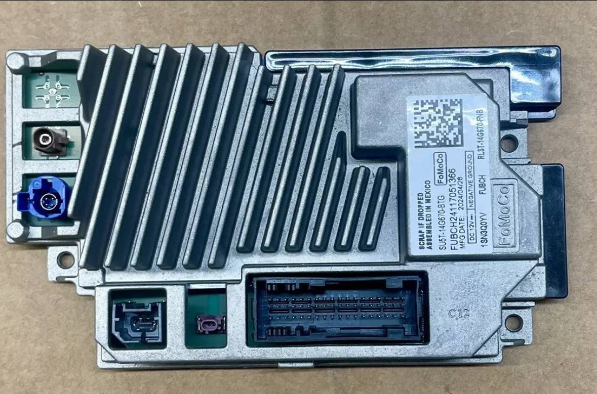

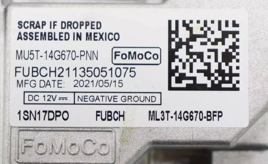

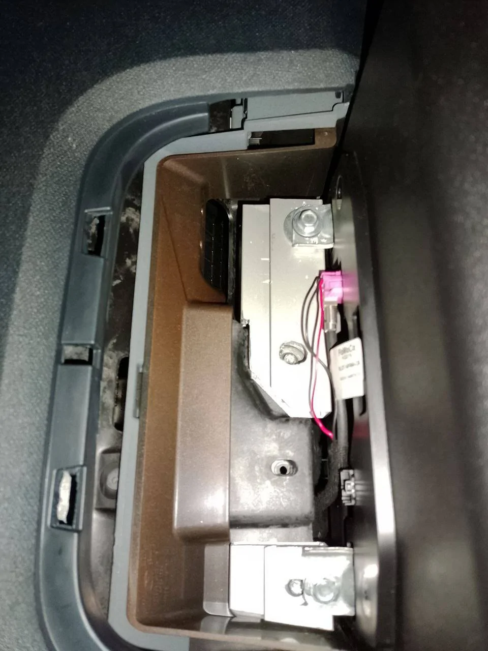

I think it's this antenna.
https://www.ebay.com/itm/353865070119
It is a simple GPS antenna.
The one you have linked from EBay was the one installed on my stock APIM for Sync 3.
I noticed the new one I bought doesn’t have the same antenna plug. Weird because I thought Ford built all of their APIMs with Nav now and had to be enabled via subscription. This one was built this year for an F150.
If it is built in, what antenna or part number would I need to install to possibly get the GPS function back?
Thoughts?

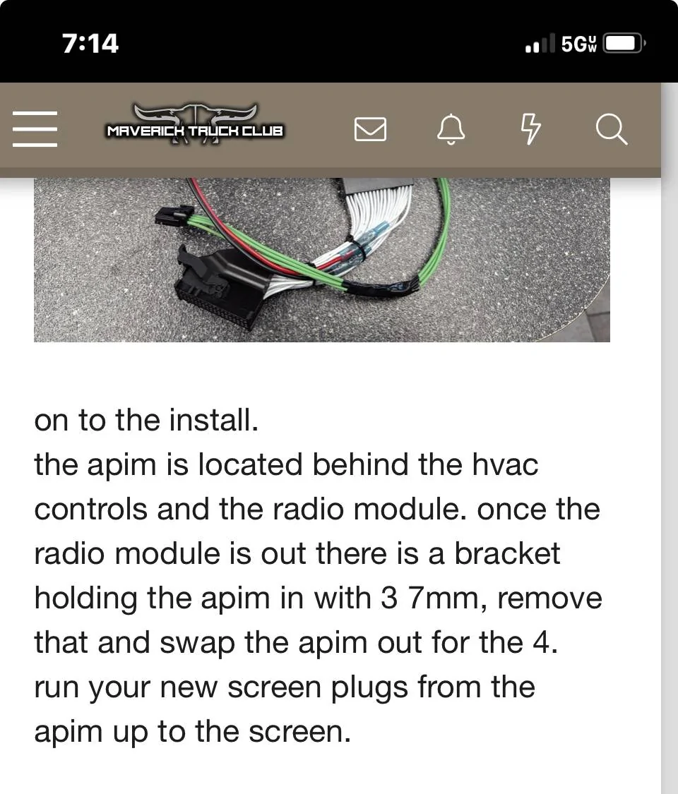

Ford Maverick Sync4 APIM and 13.2" Screen Installation Guide (Lariat Models) IMG_0545
Thoughts?
It seems that Ford makes APIM with GPS and without GPS.
The GPS antenna connector should be there, but this APIM doesn't have it.

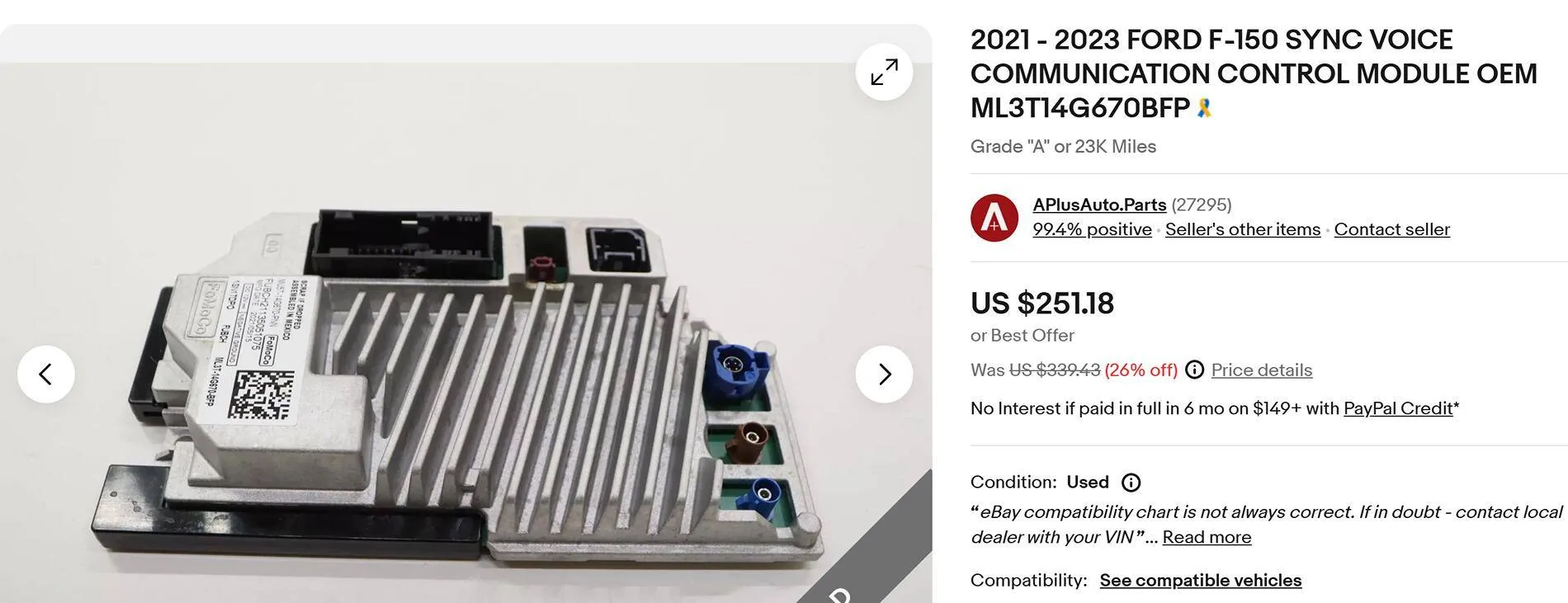

This is what I got on Ebay. Nav capability. Paid 250$, curious what ya'll paid.
Do we know what the middle brown connector is next to the display connector?

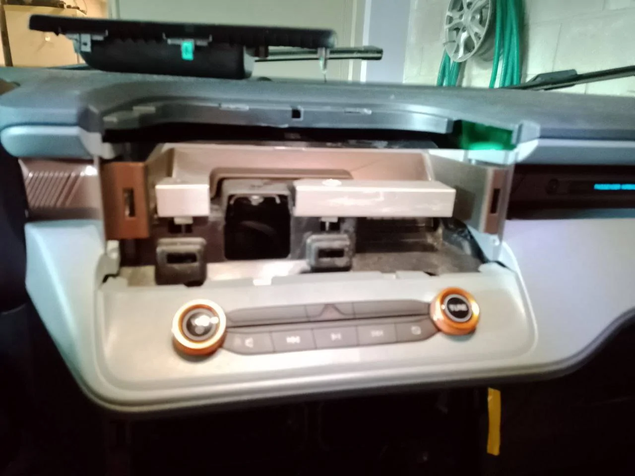

How did you guys who already had a Sync 3 APIM remount it? Did cables get in the way or were you able to use the stock bracket screw holes?
I'm asking myself the same question and no one can tell me...
I know it's an antenna connector, but I don't know which one.
Is it the satellite radio antenna? :oops:

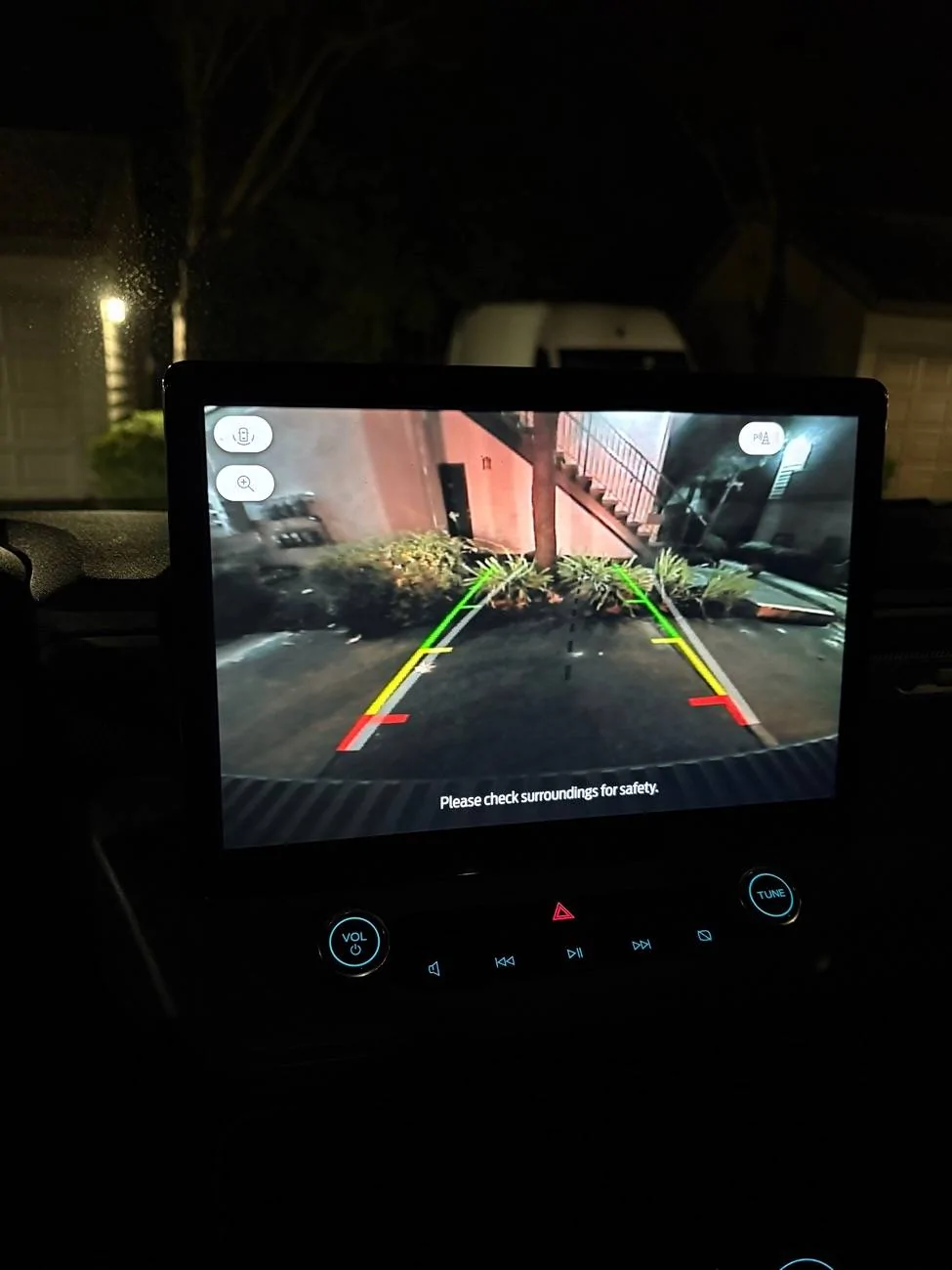

Big update!
The back up camera works! I remade a new harness today which entirely fixed my back up camera issue.
It also narrowed down my static popping issue to my biggest fear, it’s the APIM or the software version installed on the APIM.
I put my old Sync3 APIM back in and music played flawlessly, but even with a new harness this Sync4 APIM still has the faintest crackling sound.
Though everyone that’s been in the truck says they don’t really even notice, I am annoying and do notice. So it seems I will be in the market for a new APIM next month (and I can fix the navigation for the heck of it while I do).
Luck of the draw! But incredibly happy with the progress today. We are 95% of the way there.
