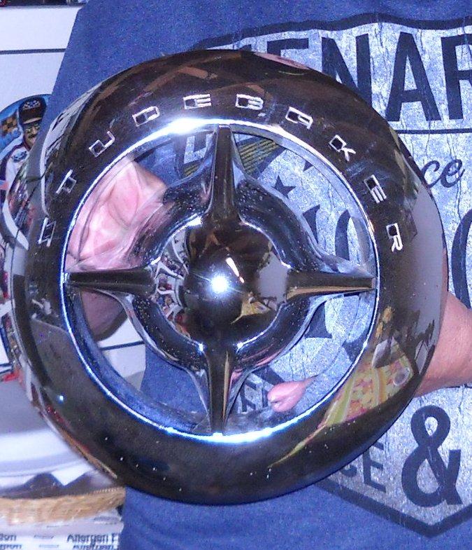

I love old Studebakers. I have a bullet nose from a 50's Studebaker. It weighs almost as much as most modern cars.
In the fiftys and sixtys, if you didn't have a chain saw, you could knock a tree down by running into it. My wife clipped of a telephone pole with our 55 Chevy. It had a small dimple in the bumper. A unibody car would have been totaled.
