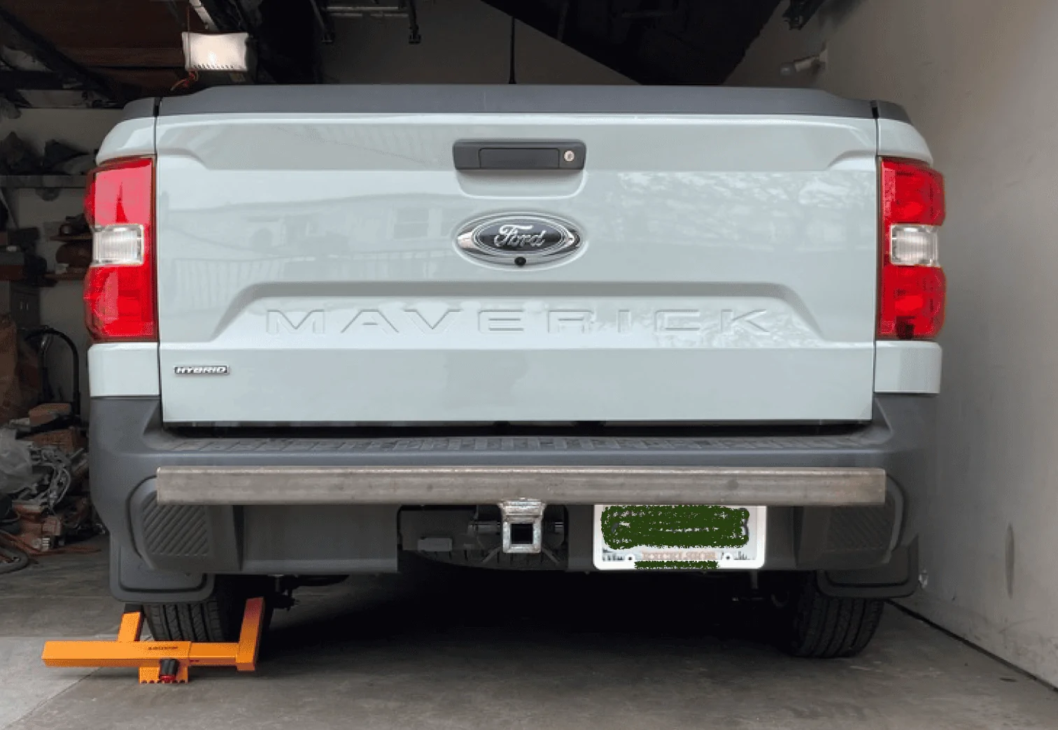

I commend your inventiveness and solution-oriented approach! I like the idea but like others have posted, this will likely create more damage with the shearing forces of even a small impact. Basically you are adding mechanical leverage to damaging your subframe, instead of plastic to plastic impact, you just introduced inflexible steel. Your better off looking for a rubber adhesive pad on the bumper and get taillight guards, more brush guard style. If you do intend on keeping it, keep it rusty and scary looking to hopefully intimidate them more! Good luck in the city.

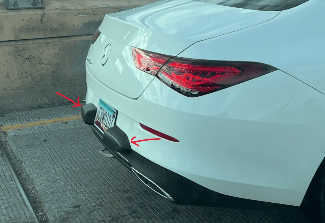

So, I was driving the other day and saw this:
Ford Maverick Custom Steel Bumper Guard Attached to Tow Hitch 1651085005245
At first, I laughed because I thought bumper guards went out of style decades ago, and yet here they are on a 2022 Mercedes. As I thought about it more, it made a lot of sense, especially for city driving, where you parallel park, or reverse into a parking garage spaces. And that's all you're after here really: Something to manage the little things.

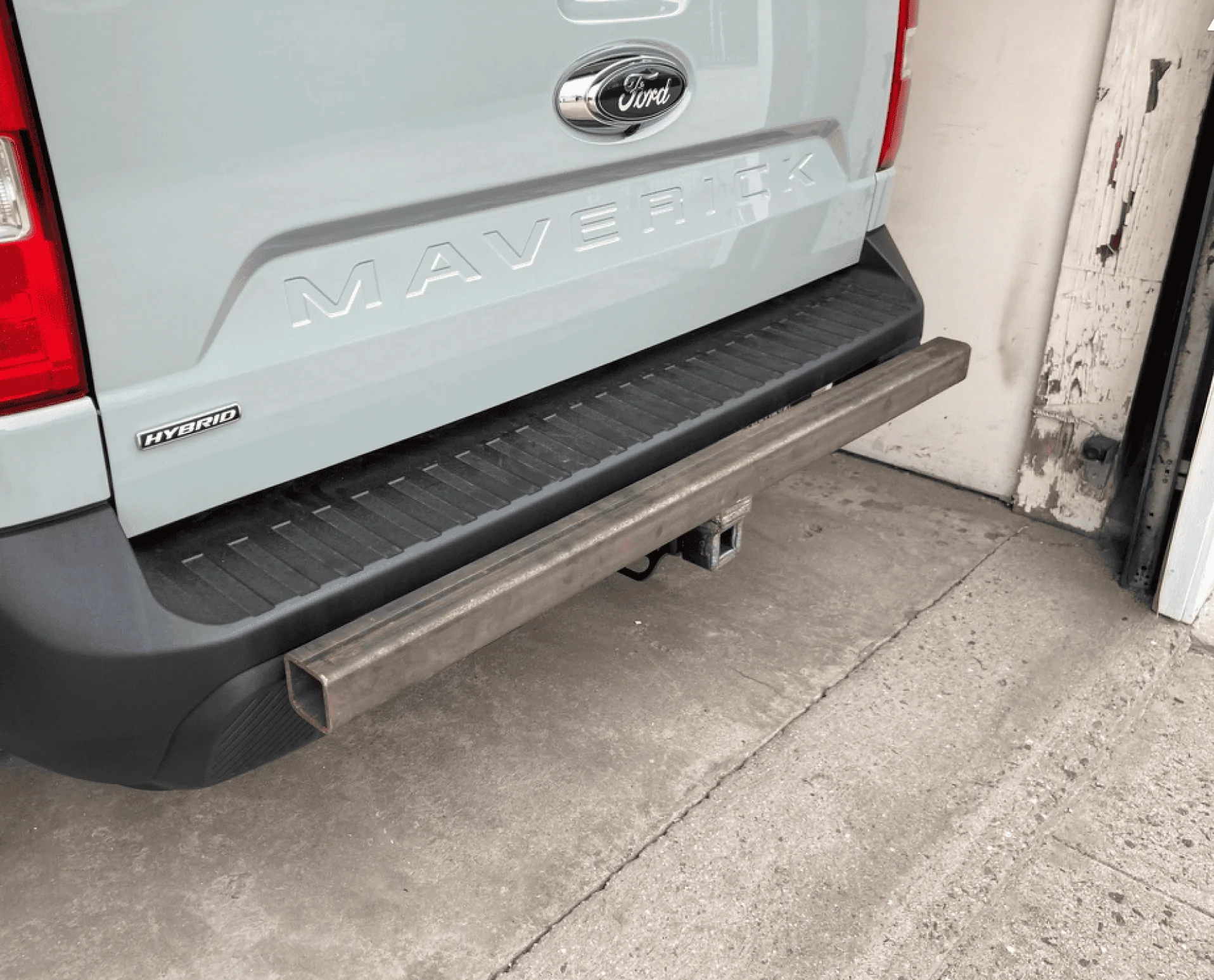

So here it is.... Steel guard which is attached to the tail hitch. I'm hoping you enjoy viewing. I welcome all feedback on this mod - both good and bad.

You sold me Maverick Man - starting my redesign now. I like the idea of bolting it together rather than welding.
Also like the idea of using a more pliable metal. You mean something like this :
https://www.homedepot.com/p/Superst...BgDn9a4xChygB2GW_mUaAgTsEALw_wcB&gclsrc=aw.ds
Yeah thats what I was thinking. Just give yourself more spacing since it will be designed to give a little. Also could put some thin rubber on the backside of it so if it contacts your bumper it may not damage it as much. Another crazy idea that would make it bigger but better. Would be to cut that 10 ft piece in half, and sandwich a a few junkyard valve springs in between them to make a springboard. Just run bolts through it should be fine and pre load em a little. I think there is alot you can do with that. For cheap. A good source of rubber is old tire sidewalls, just use a sawzall or hack saw blade with a towel around it(for your hand).

Biggest problem I see with your welded steel bar across the trailer hitch is if someone hit your rear bumper at any angle and your weld holds, the accident could and probably would cause damage to structural parts of the Maverick's subframe components attached to the hitch. Structural damage is top on the list to get a vehicle TOTALLED.
