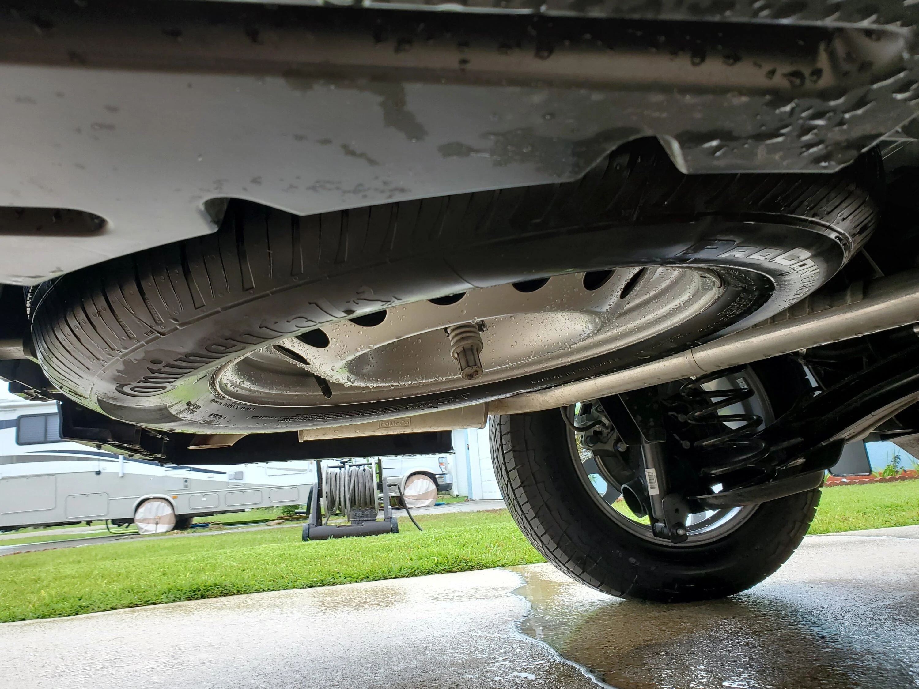

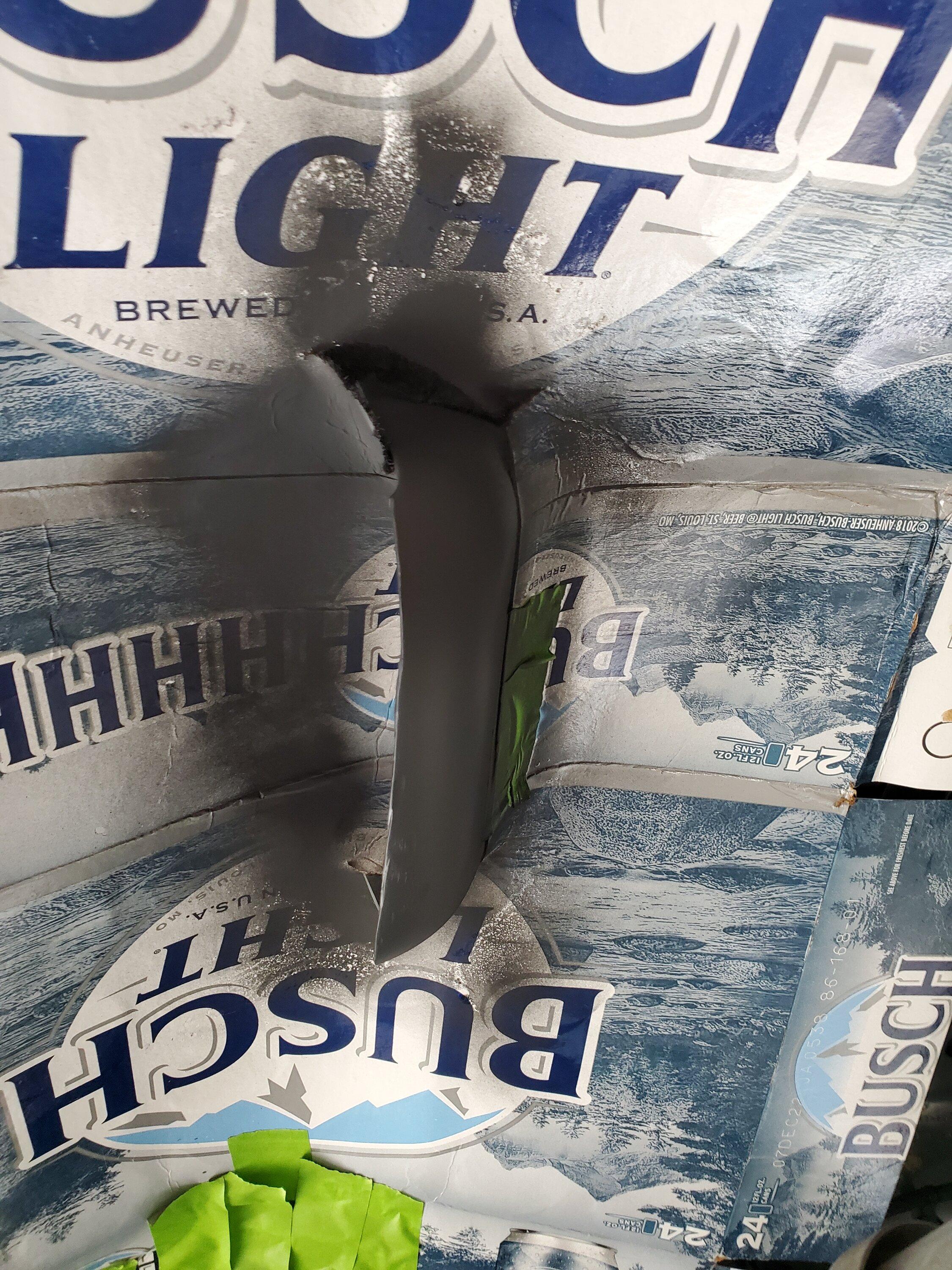

I just put Bronco Sport wheels on my XL and here is what I had to do to use a factory steelie and 225/65R17 as my spare. There is a bracket to prevent the spare from shifting forward. The space between that bracket and hitch was just slightly too small to fit the full size. (I believe if you don't have a hitch this entire process would be unnecessary)

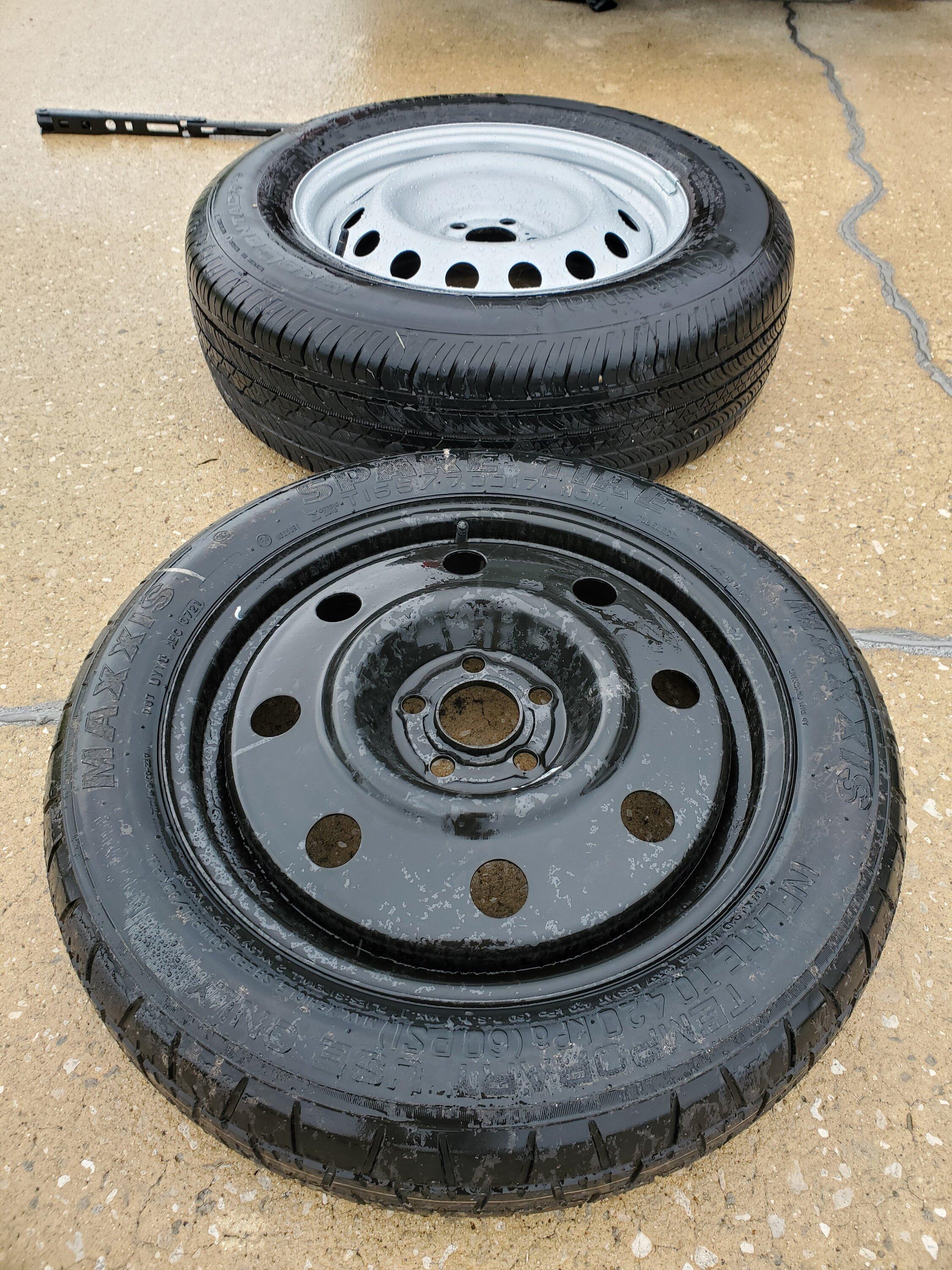

What I had vs what I wanted.

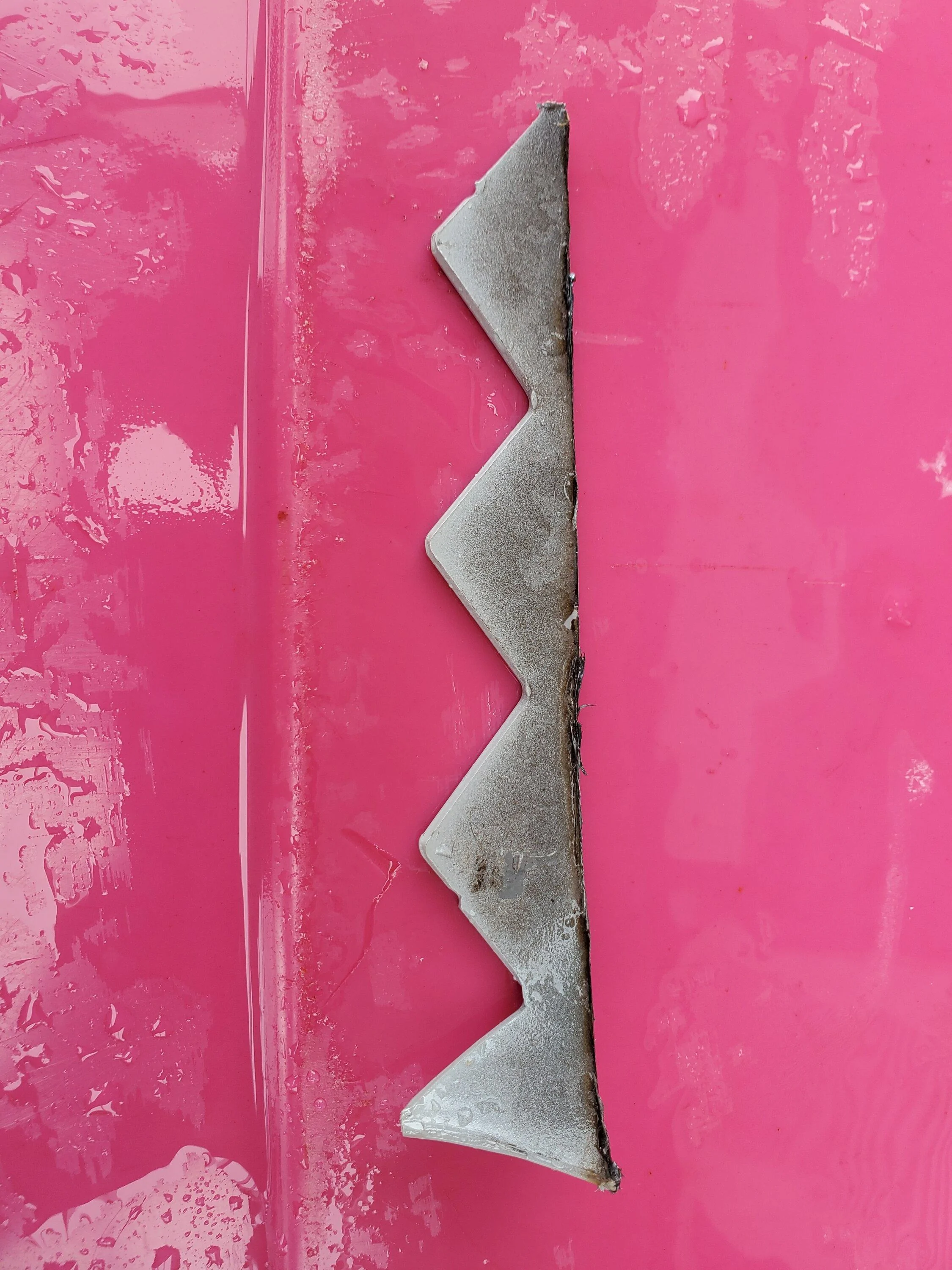

I gave the bracket a small trim and then filed it smooth and primed/painted.

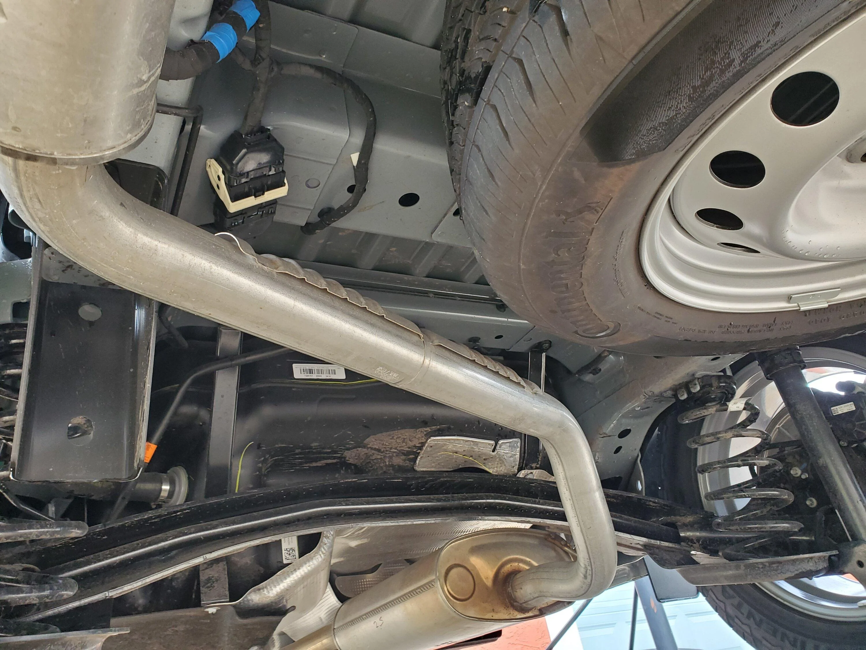

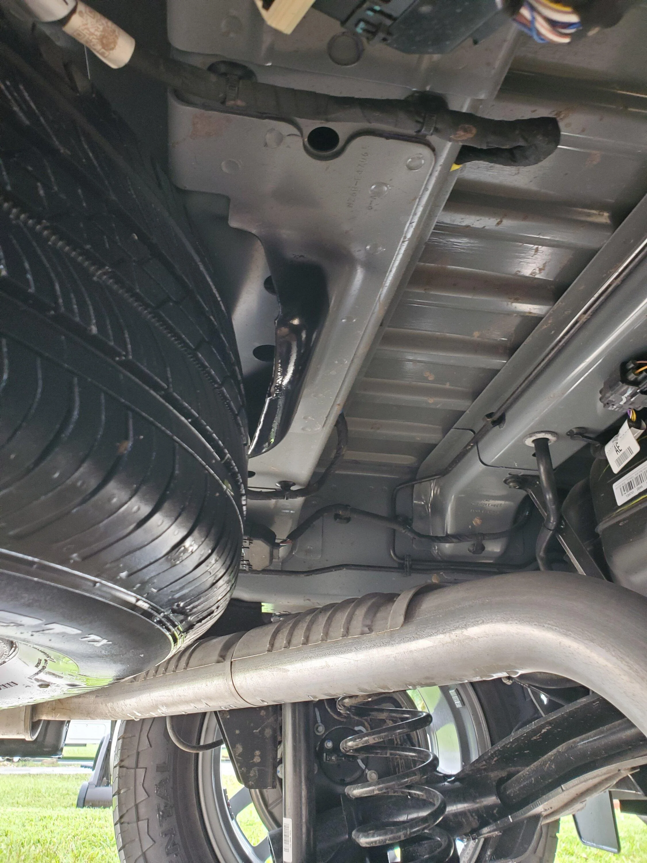

Finished product
Finished product! I know the paint doesn't match and my beer choices may be questionable, but it fits!
Finished product
