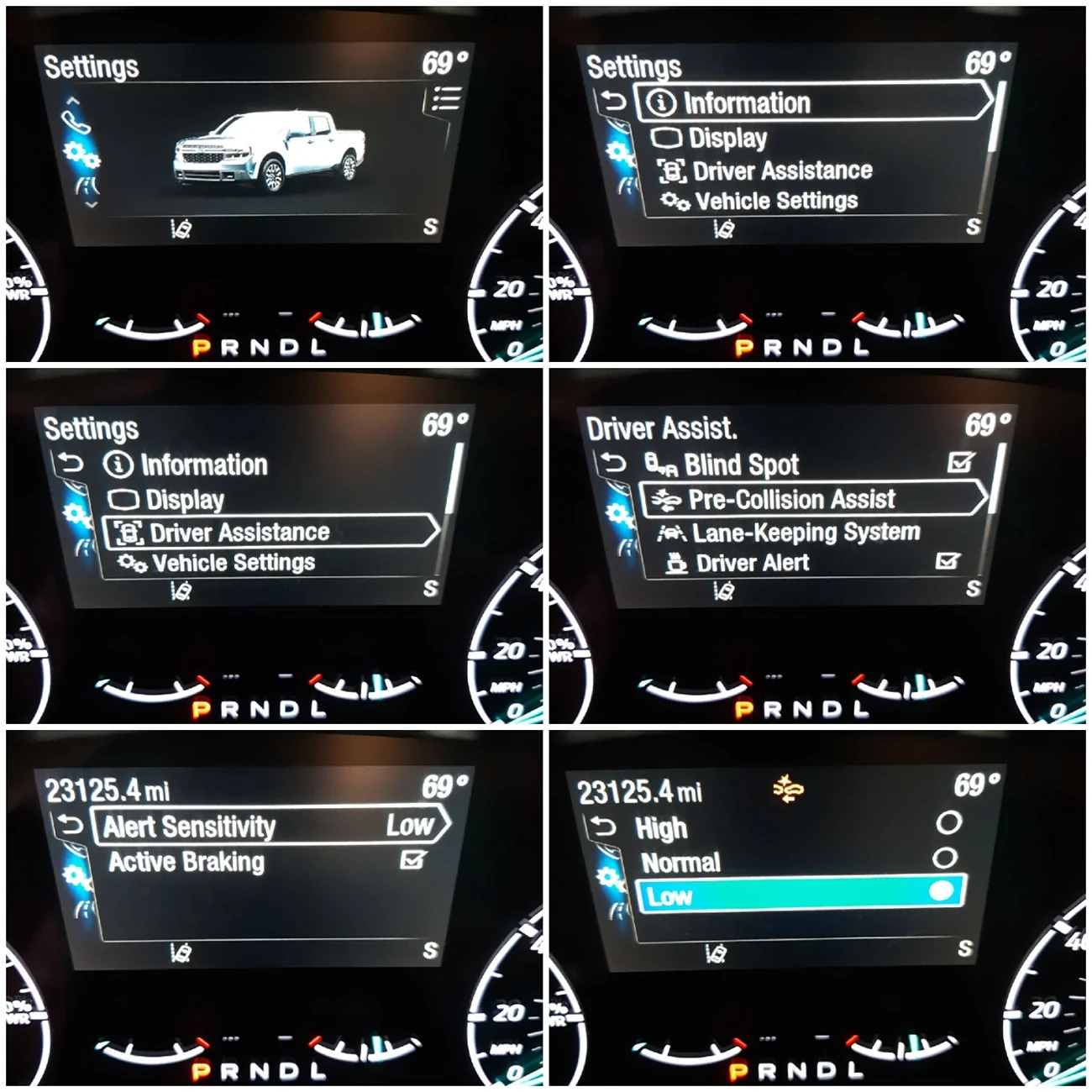

I did have to change the setting for pre-collision to the middle sensitivity. An intersection I have to turn left at almost every time I leave the house has 2 left turn lanes in each direction. If I am in the right lane of the left turn lanes, sorry if this is confusing but don't know a better way to describe it, when I turn I am so close to the left turning vehicle from the other direction it was putting on the brakes. With it at the middle sensitivity I will get the flashing warning if there is a semi in the oncoming turn lane. I try to use the left lane of the left turn lanes, sorry again, when possible.

Correct. But after it slammed the brakes on once and almost got me rear ended to avoid the turning semi I changed the sensitivity. In this area when the left turn arrow turns yellow cars 3 or 4 back FLOOR it to make the light. I don't understand why they are in a hurry to get to the accident 🤣

Agreed - I suggested the same setting be reduced.
The last thing you need is a safety system causing an accident.
