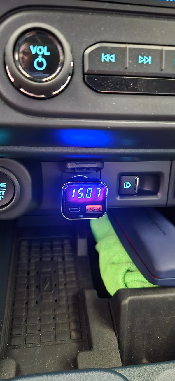

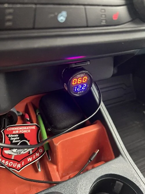

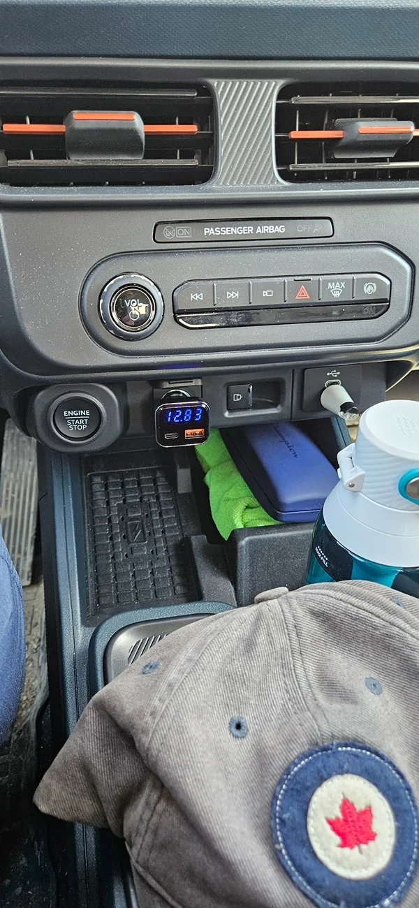

I have noticed in the past the battery voltage was below 12V most of
the time when I get in to go somewhere. I have one of the
cheap ass voltage and temperature displays that plug into
the cig lighter. The thing does seem to be relatively accurate.
Checking against my Fluke the voltage was with in a 10th.
I also noticed when it was colder the charging voltage would
be at 15 which is a bit high but not too high.
Then I noticed that the auto start stop was disabled (not by me).
It said disabled due to charging. I don't do a lot of short trips
so this was concerning to me....

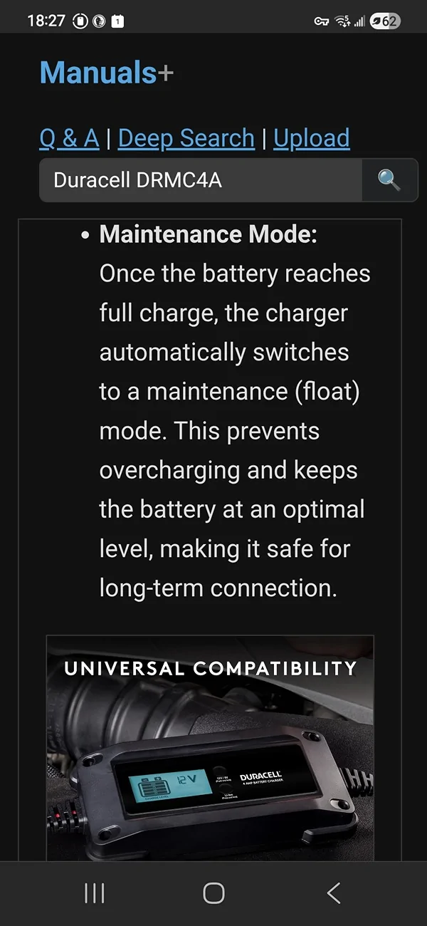

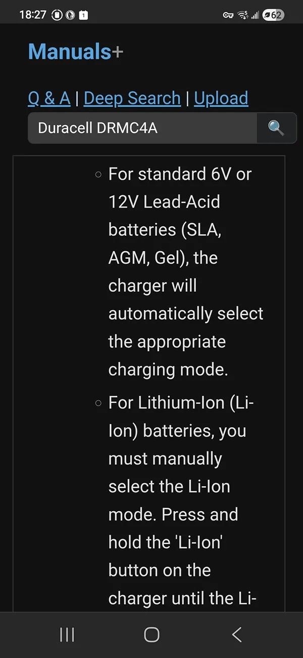

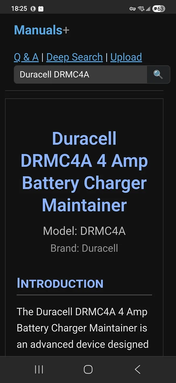

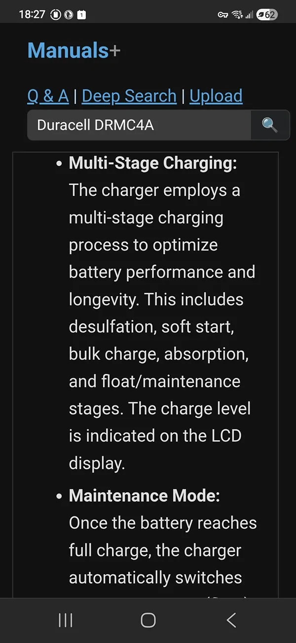

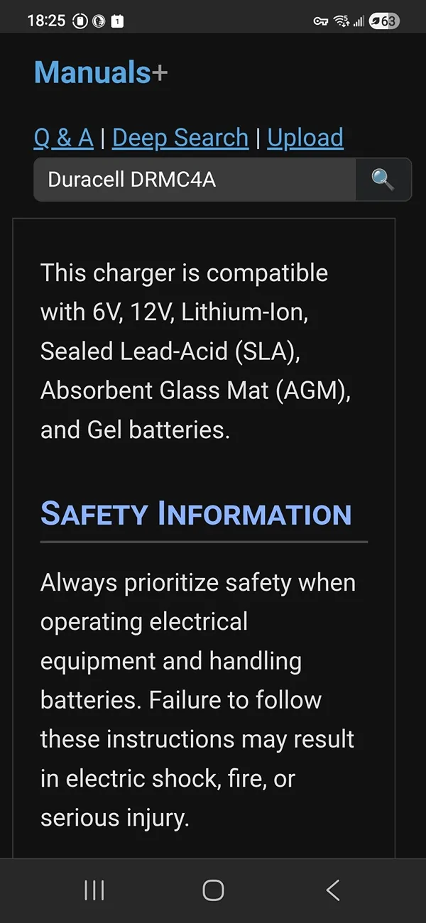

I looked up your charger and though you say it is old, it seems competent and says it is appropriate for Sealed Lead Acid batteries, AGM, GEL and last but not least, also Li batteries. Does not mention FLA batteries.
It has a de-sulphation capability.
All batteries are different in construction and also vary in their needs when charging!
From discussions in this forum I believe all our Mavericks are already programmed for charging AGM batteries, not FLA or SLA as charge profiles are very different.
This leads me to believe that other FLA/SLA batteries if they are used in our Mavericks will have their lives shortened.
AGM batteries can take a far higher charge then FLA/SLA batteries. This will contribute to their shortened life if installed.

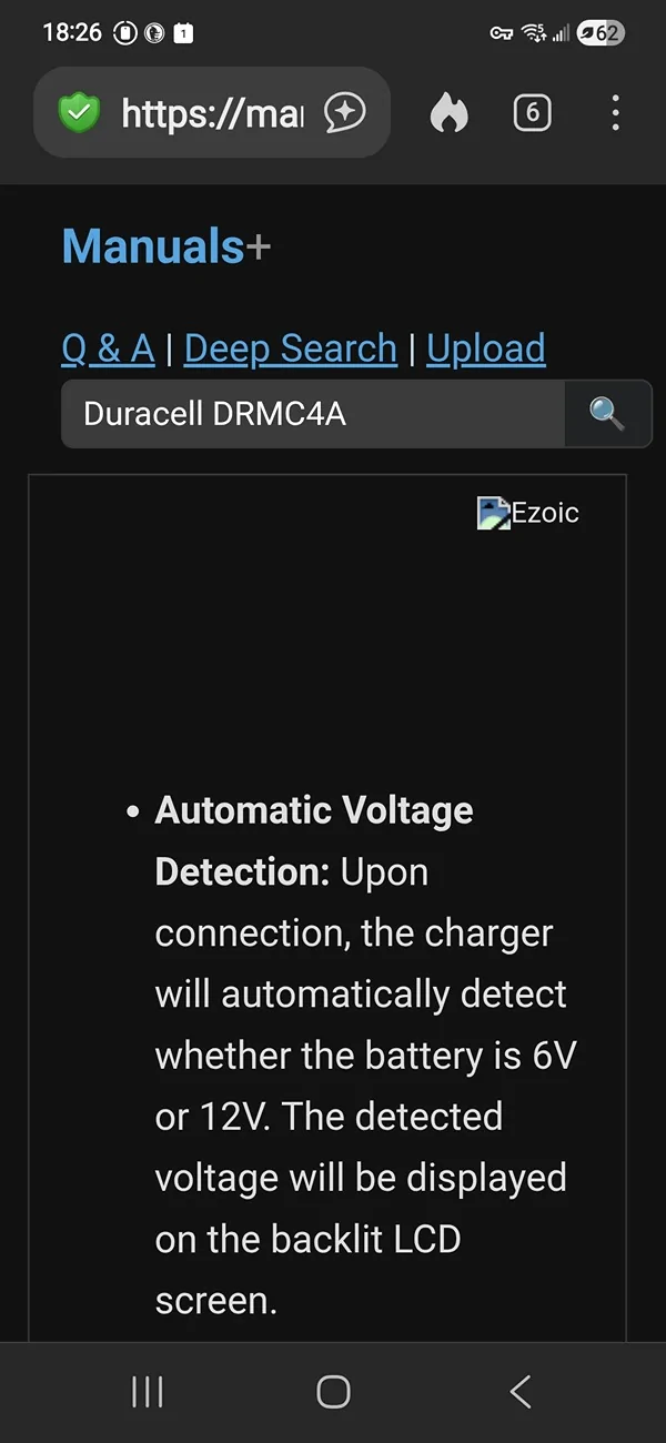

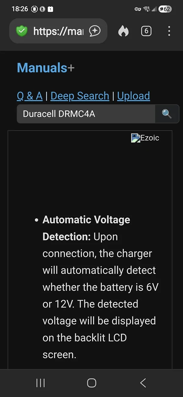

Here is some of the info I found on your charger.
You stated that you see 15 amps when charging...it is my thought that this bears out your truck thinks it is charging an AGM battery.
If you do have a FLA/SLA battery in your truck, then this is slowly killing your battery due to too high of a charge voltage. They are more sensitive to the high voltage meant to charge an AGM battery!
Phew, sorry for the long post, but we had to cover a lot of ground!

HOLY ISH DUDE - WOW you pulled a crap load of info on that charger...
Yeah I suspect the battery is on it way out...
It was / is an experiment - like I said this charger has kept the old and I mean old Optima battery
up to par. Granted the old Mustang does not get out of the garage in the cold and snow hardly ever. It was out in January for new tires but, that was out and back...
The notes you found stage desulfication - interesting ! I suspected as much because of the
"reviving" of my optima battery.
Anyway the battery in my 2.0 EB is (BAGM-48H6-760) and says AGM Tech.
Great info thank you.
The info on the charger where did you get that???
website?
app?
Thanks again!
website?
app?
Thanks again!
tlp
Of course it isn't a problem, just trying to help out another Maverick owner!
Here is where I found it on a Manual site. Copy and paste it onto your browser and you can see all the info they have. Interesting stuff, eh?
https://manuals.plus/asin/B0C46Z446K

Do you have one of these voltage indicators thst fits into the trucks cigarette lighter/12 volt port...?
I just got one from my wife for my birthday from Amazon and it works great.
I just did just did a battery charge cycle all day to day and doing a battery relearn right now, overnight.
Just a thought for you to see what your charging system is doing easily and cheaply.
Have a good one, and if you have another mystery battery dump, further investigation of a sudden parasitic drain may be in order.
Andy
my USB port device shows voltage.
