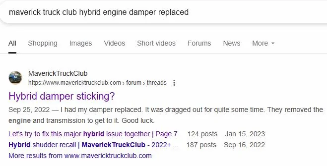

Has anyone gotten their engine damper replaced? I've seen many complaints about it here but haven seen anyone saying theirs got replaced. Just curious.

Mine is FWD only (I'll edit my signature) and it does seem to occur when the gas engine engages under light load, going from electric motor only to both running.
I listened to your recording 2x.
Could not hear anything recognizable.
Engine damper was VERY obvious in mine and occurred when engine shut off. Almost like "dieseling" effect.
Did not hear that in yours.
Mine got more prevalent with time, not better, and was replaced under warranty.
