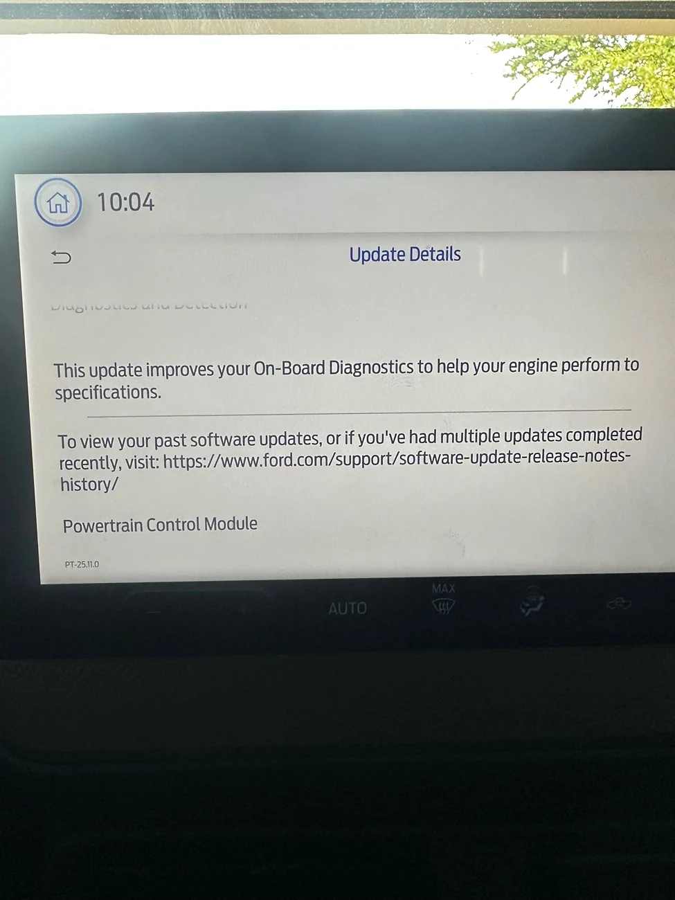

had an over the air system update a couple days ago. It seems to have stopped the noise on my 25' FWD hybrid.
I just got done driving it and was really trying to listen for it. It might still be there very very slightly.
The best way I could describe the previous noise was similar to a catalytic converter rattle.

May have helped. May be coincidence.I have a 2025 since late May. I haven't had any updates other than a TCU update a few days after purchase. But my noise seems to have disappeared also. I wasn't worried about it because I thought it was the nature of the beast. So I tuned it out. But after others noted that they no longer heard it, I started paying attention. And it seems to be gone.
