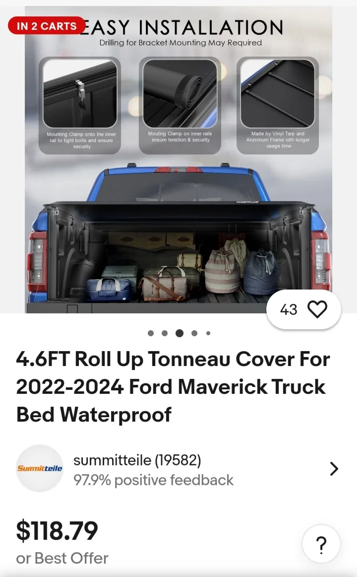

Bill,
If it is for temporary use. You can find soft tonneau covers for around $120.
Ford Maverick Simple reliable bed cover? 20251125_093652
Now you just have to decide whether or not you want a one-time use cover or spend the extra money for a better cover and keep it on.🤷‍♂️
Decisions, decisions
