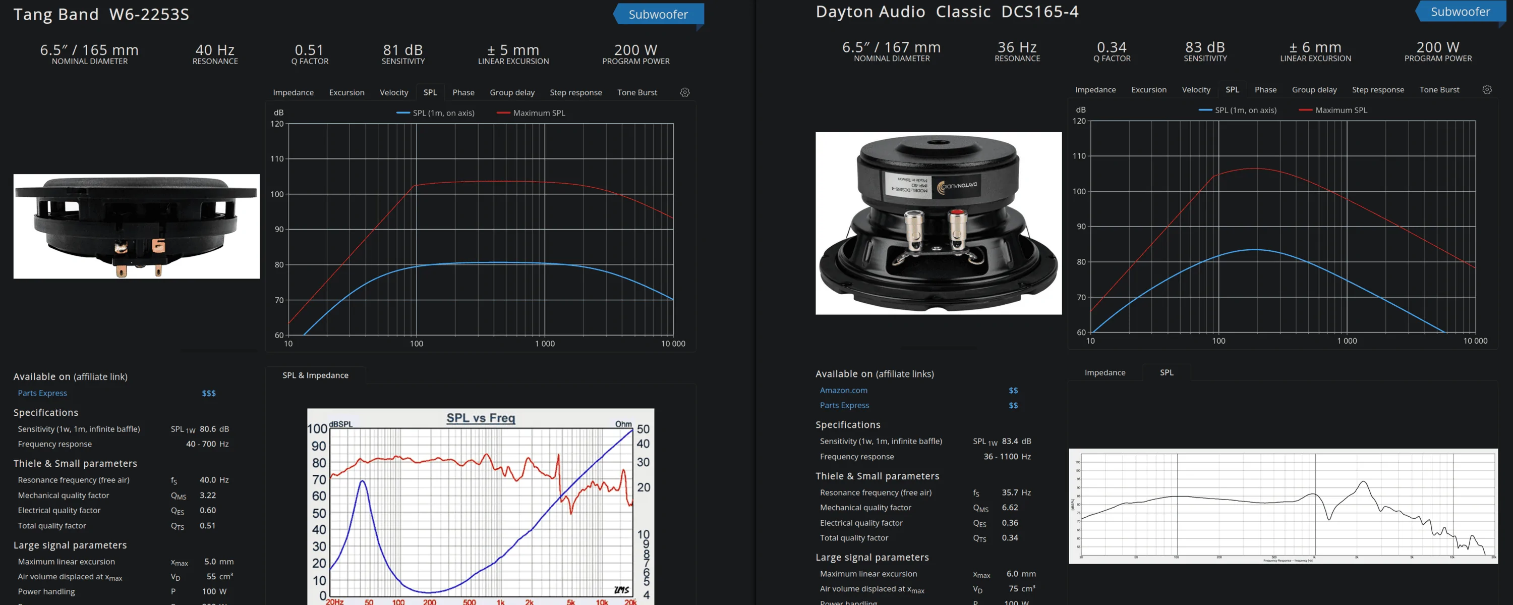

TangBand makes a low profile 6.5" sub. Would this solve some of the clearance issues, ie, use a thin adapter plate and this sub but still have clearance behind the rear seat?
https://loudspeakerdatabase.com/TangBand/W6-2253S
It might help with clearance! But it's really just stuffing that is being pushed up against. I can't imagine it making a huge difference with bass and my seat closes correctly 🤷‍♂️
Edit: Interesting differences here vs the Dayton

While the Tang Band might fit better, I imagine the Dayton would still perform better. The Dayton has a lower Fs, and is more efficient(which is better for the low power factory amp). I'm not knocking the TB though, and it is still probably better than factory. I just think the Dayton should do a little better going by the specs listed. I'm not getting into the Q stuff and which is better for a free air application. I love this thread either way. It's such a simple, cost effective solution that works :)
I like TB too. I tried TB, Dayton and a Goldwood. But it all boils down to sound. To my ears, the Dayton sounded best. And it had the most punch by far IMO. Despite QT, it did not like the enclosure sealed. It could be that there wasn't enough volume, but the point was to use the existing enclosure. Whatever the case, and despite the tight fit, it works.
I listened some of the small bass module released by TB. The small form factor intrigued me. I had planned to buy a couple of them for the slots on each side of the back seats, using them with a good amp, mostly for MID bass. Couldn't find any actually for sale.
Also looked at the 5-1/4" TB subwoofer with a 3-D printed enclosure or a laminated enclosure. Again, couldn't find anyone with the 5-1/4" subwoofer speaker in stock, including the Chinese sites.
I'm probably better off with the powered sub I installed.
