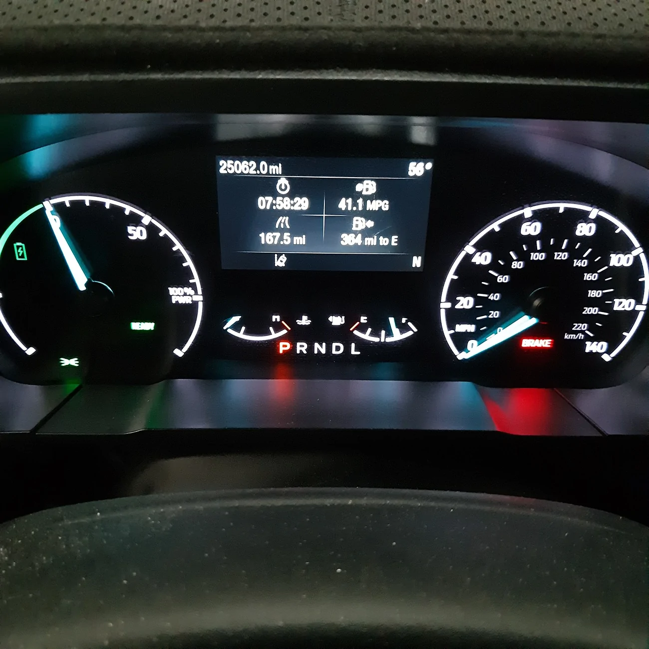

I've gotten used to pushing the mode button 4/3 for slippery mode. I consider the mpg that I get perfectly normal. I prefer the easy coasting profile in Slippery mode then I do the more aggressive regen profile of the ECO mode.
Trip 1 👇 is current tank.

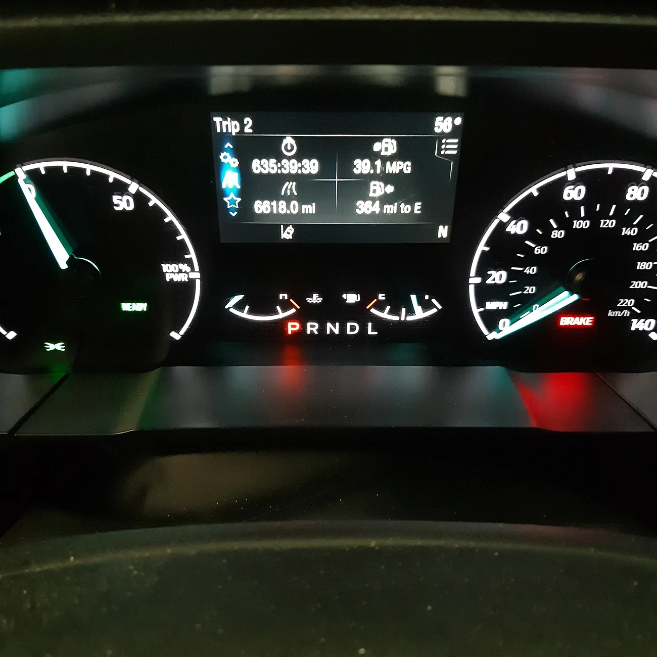

Trip 2 👇 is long term.
Yeah, this is what I am getting now, which I consider bad. I would consistently get 44 to 45 and 700 miles per tank if I really top the tank off I find it hard to believe that a temperature change in 20 degrees or 25 degrees can cause this
