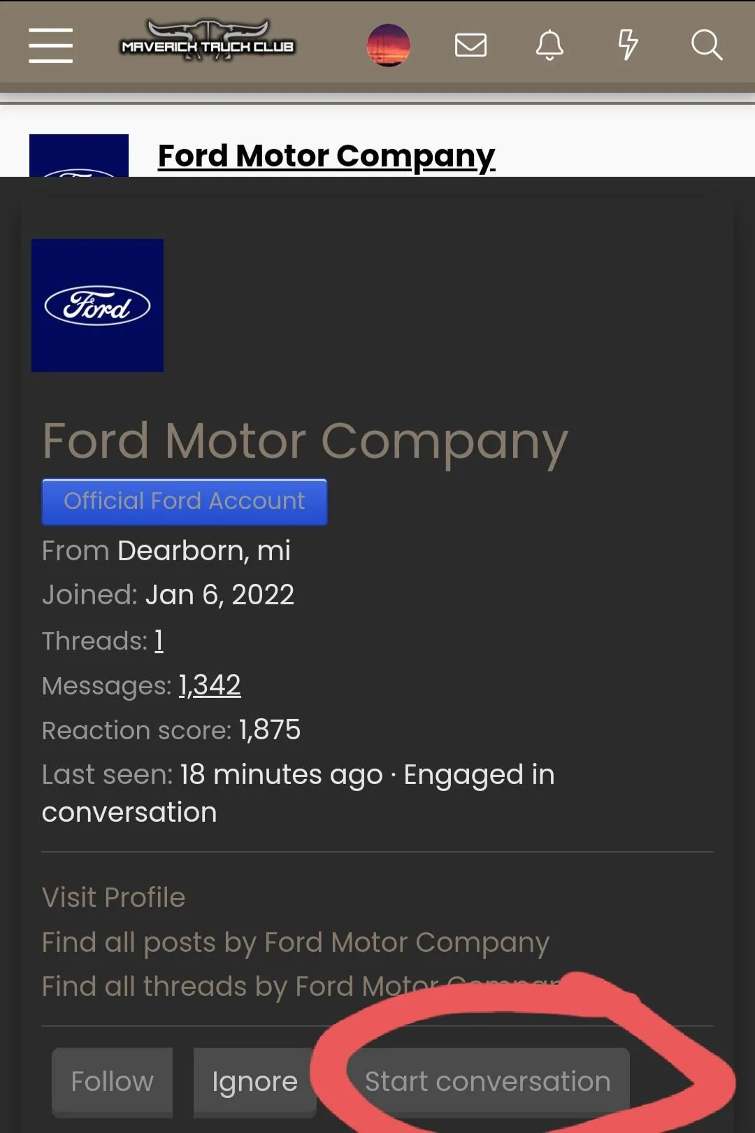

Not seeing an option to do that. It’s is at Coconut Point Ford in Estero Florida
Click on their profile and select "Start Conversation"
Click on Ford Motor Company and click on Start Conversation
