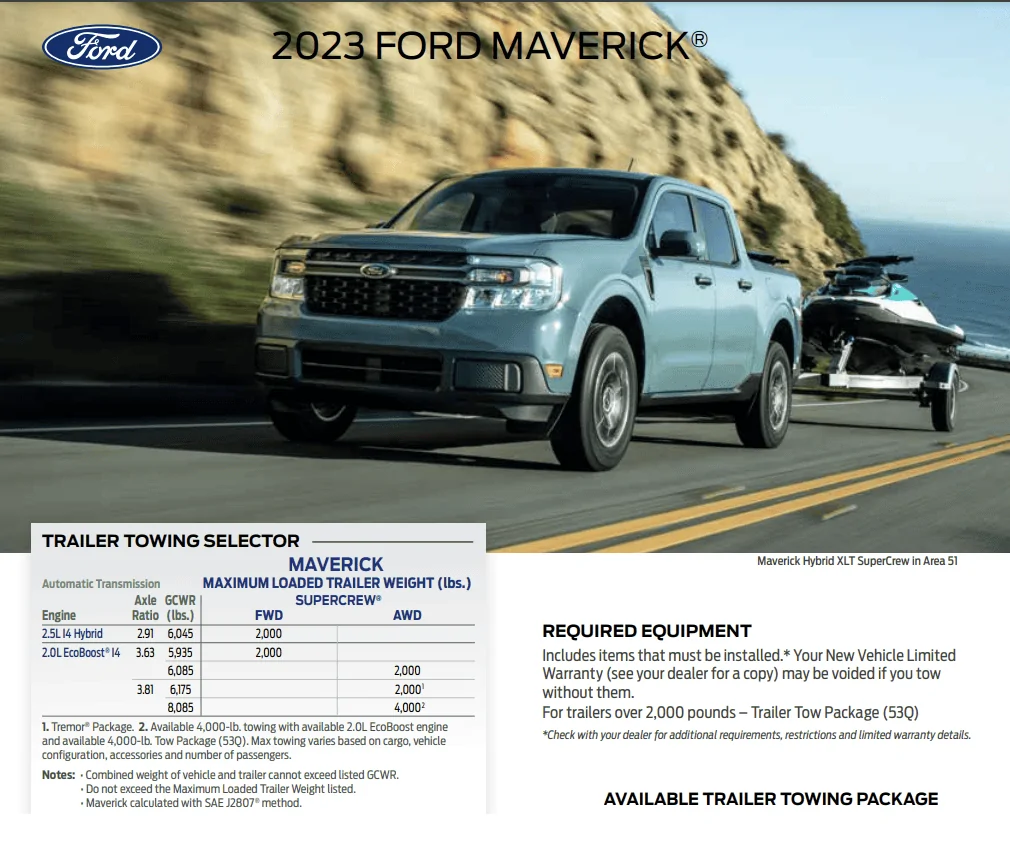

3. Comment: I have the factory tow package (Lariat Hybrid). Not that I plan on towing anything quite yet, or approaching any limits, but the owners manual says see door tag for towing capacities. The door tag says see owner's manual for towing capacities. Seriously? The capacities must be somewhere in or on the vehicle, yes?

The seat belt warning is a safety feature. To the best of my knowledge there is no way to disable it. Since you have a hybrid you don't have a tow package you have the hitch. The hybrid only comes standard with a 2000 pound towing capacity.

3. 2,000 pounds if not 4K Tow equipped, which is not available on the hybrid.

3. 2,500 pounds if not 4K Tow equipped, which is not available on the hybrid.
Are you sure the hybrid is rated for 2500 pounds? Everything I see points to a 2000 pound capacity for the hybrid.

My point on the trailer tow was that the manual says go to the truck, the truck says go to the manual, and in reality the accurate data is in a third location. It's about what I expected. If I wanted a 3500-5000 pound capacity I would have bought something bigger!
Corrected.
