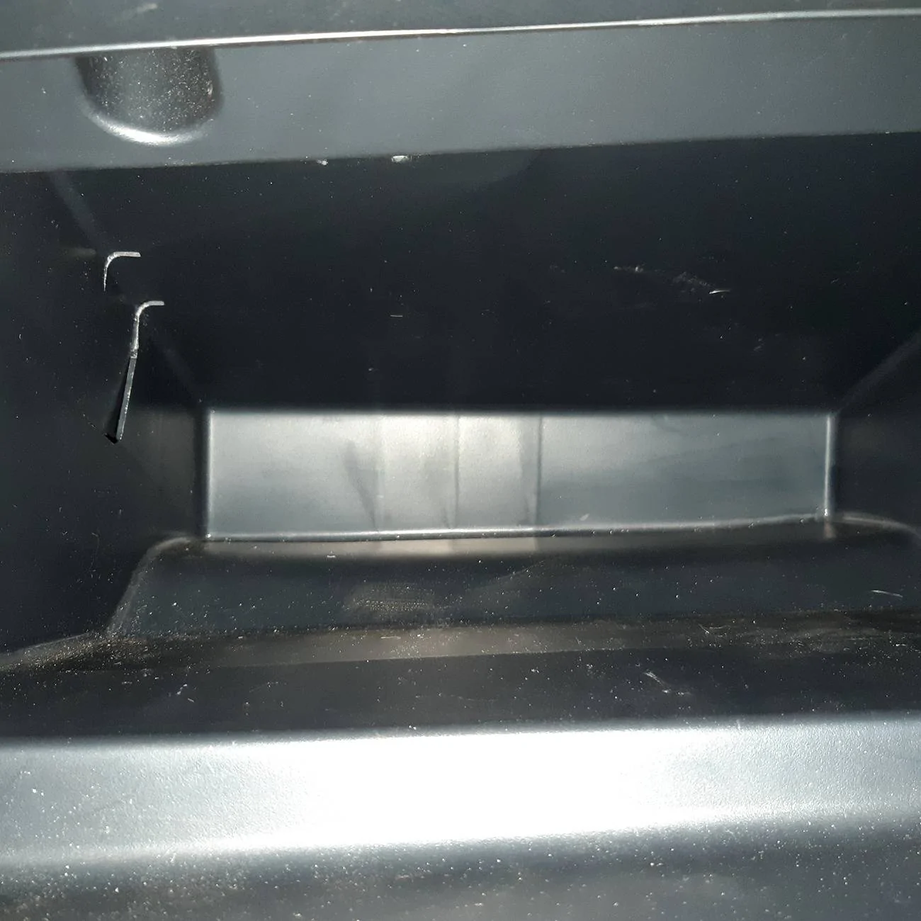

One location is on the BCM which is located in the front of the passenger footwell underneath the plastic panel and there's a sticker my finger is pointing on it the first five digits is your code
It is too late tonight, but tomorrow morning, I'll take a picture for you.
As promised her the pictures, plus a video.
👇 Here's the panel you must remove
Ford Maverick Keyless Entry Keypad 20250509_081607
My finger is resting directly on top of where the code is.👇👇
Ford Maverick Keyless Entry Keypad 20250509_081538
