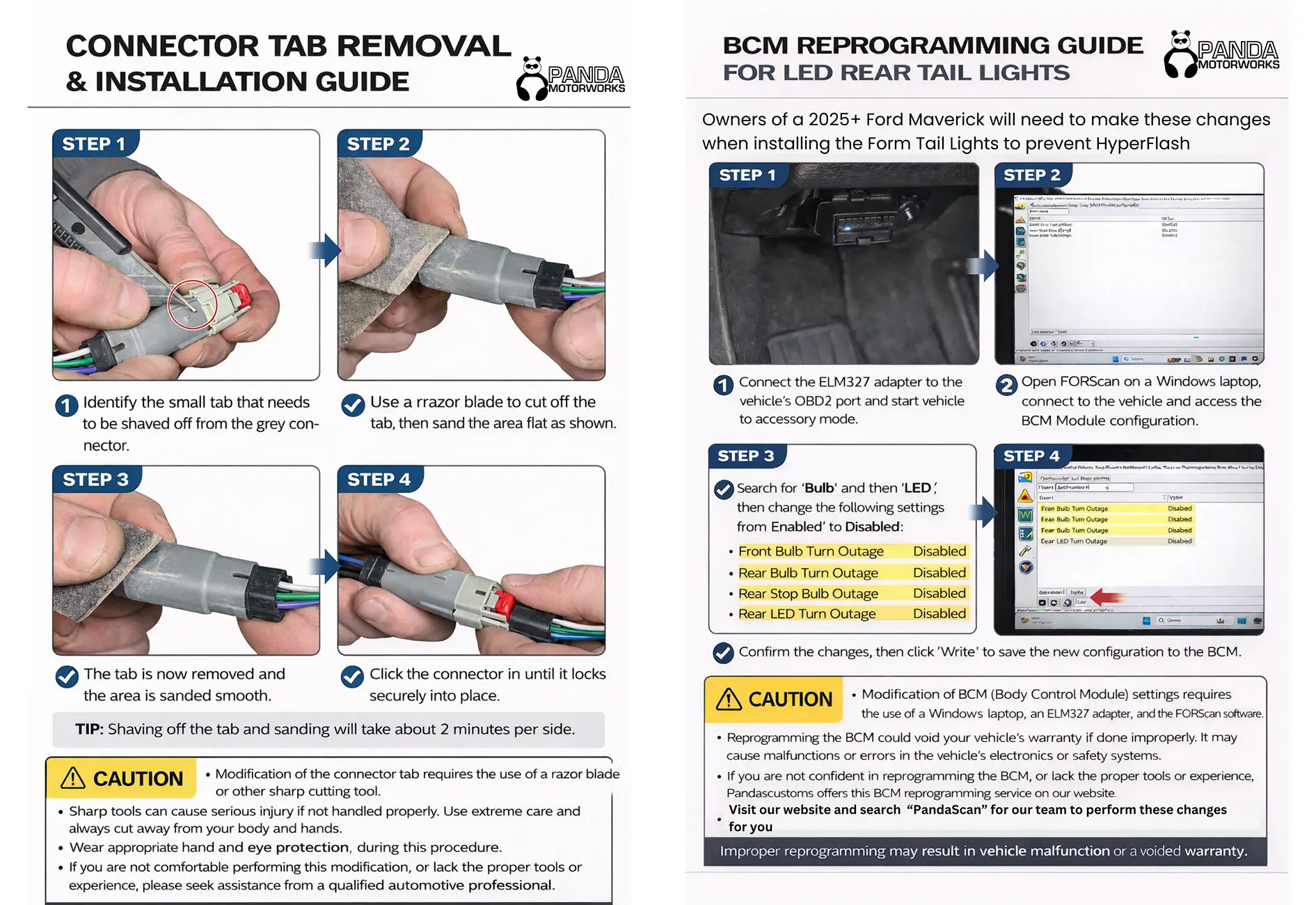

I have a 2025 and will be finding out next week if the taillights work
The answer is directly above your post. It does, with some modifications.

If someone can confirm that the tails work on the 2025+ (no reason it shouldn't IMO but you never know...) I would be immensely grateful
Alternatively, I'd be happy to be the guinea pig if y'all would be willing to issue a refund in the off chance that they don't work @Panda Motorworks
I CAN CONFIRM THEY WORK , WITH A SMALL MODIFICATON AND INSTALL IS EASY ONLY TAKES A FEW MIN.

How long did they take to install?
About 15 minutes but I don't have that splash shield they talk about in the instructions. Only slight issue I ran into was with the harness that runs side to side, they didn't give any extra slack. I wanted to run it behind the spare tire against the bumper but I had to go over and pull it really tight.
