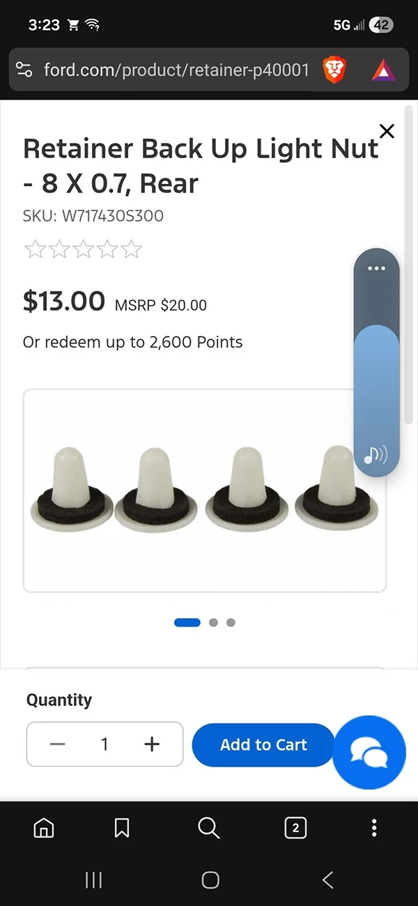

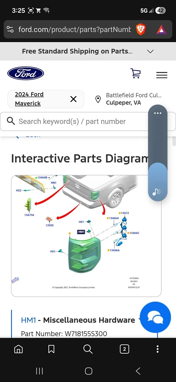

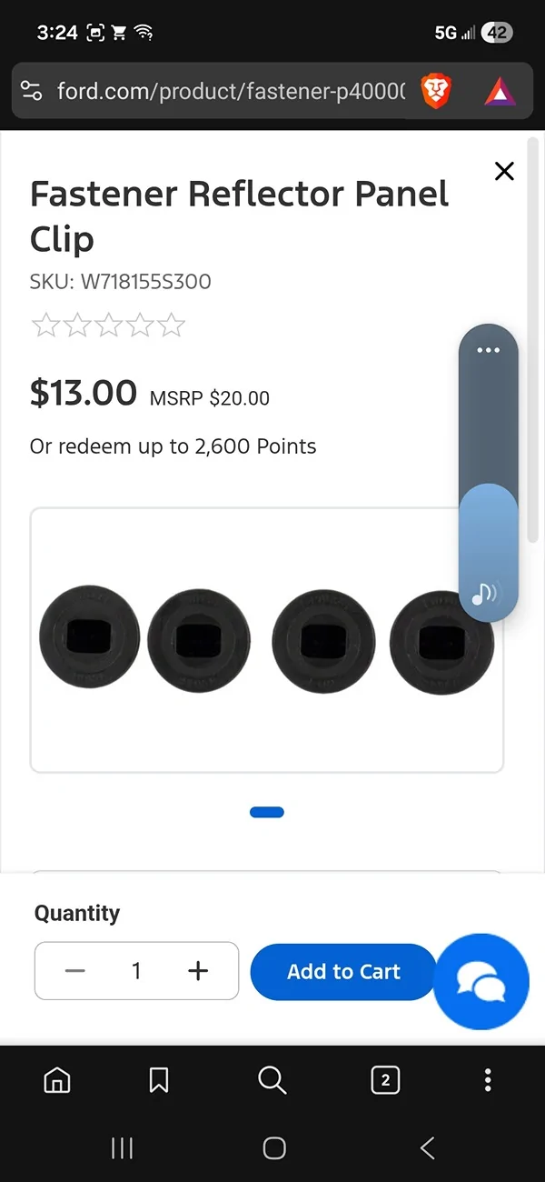

The lights don't sit perfectly flush with my truck's body, there is a gap of maybe 1mm on the outer edges. I think this might be due to them not locating into the ball push clips as well as the OEM ones? Any tips to tidy this up appreciated.
Replace the plastic fasteners, HM1 and HX1.
