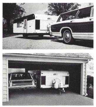

Thank you for making this post and showing this absolutely gorgeous trailer!
My parents had a trailer like this in the 1970’s and I thought this breed went extinct because I never see them around. I didn’t have the right vocabulary to even Google search for them.
But I kept thinking that a low-drag telescoping camp trailer would be perfect for the Maverick. Not a vintage 1970’s one, but a modern 2025 version of a telescoping trailer.
And here one is! I will defitely
Be checking these out.

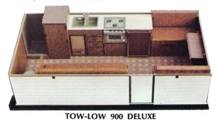

And I think this is what my parents had:
Ford Maverick RV - Towing Trailmanor 2720QS hard-sided pop-up trailer IMG_2691
clockwise: shower, pantry, sink, cook top / oven, refrigerator, dinette / hide-a-bed, door, couch / hide-a-bed, toilet.

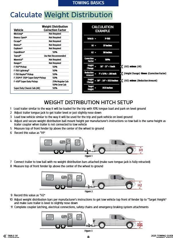

In the latest (2025) Ford towing guide, they do show weight distribution hitches and they list the Maverick. https://www.vdm.ford.com/content/da.../2025-Ford-RV-and-Trailer-Towing-Guide_v1.pdf
what I find most interesting about this table on page 8 is that the Mustang is listed and says no correction factor, same as the Maverick. then we see the Transit actually says that a WDH is not recommended.
most manufacturers don't have a guide this robust. Ford does, and to me it looks like they think a WDH is fine on the Maverick.
Ford Maverick RV - Towing Trailmanor 2720QS hard-sided pop-up trailer Screenshot 2025-06-25 090042
