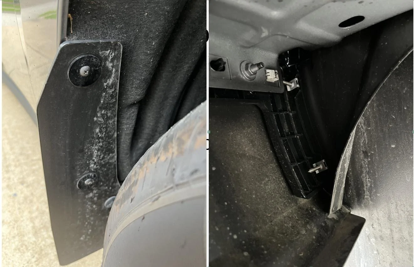

I have had the mud flaps for a year and all the screws are rusting. You would think for $150, the screws wouldn't be rusting.

Yes, I replaced them with stainless ones from the local hardware store.

Anyone know the spec's on the size of the screws? I'd like to source true stainless steel screws that won't rust but I want to make sure I'm getting the exact thread size and number needed.
I used 8 x 1.5"L SS Truss Head Phillips screws I had for front & rear Rok Blokz

You can get black corrosion-resistant-coated steel screws too. (Yes, there is such a thing)
