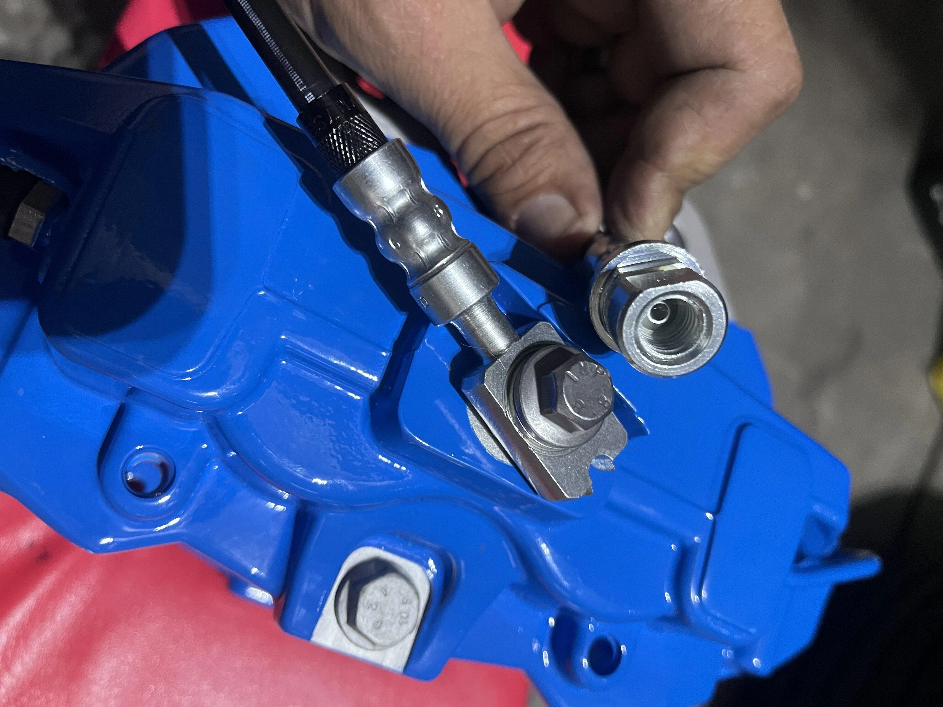

These bolt to the Brembo and the Maverick hard line.

Is it just me or does it look offset a bit? It doesn't look centered. Is it just the pic?

the only issue i would have would be brake balance, these are going to shift the brake balance further forward i would expect.
Yeah, would need to take a look at the area of the pistons to roughly compare.
It’s not bolted in place

im waiting on a Maverick knuckle and rotors so I can have the bracket made. Already have the brake lines that will connect these to the Maverick.
2 things.
1. Any updates on the progress 😁
2. Being the Focus RS is the same bolt pattern, wouldn't that be a better option than the Mav rotors?! Unless they are both the same size.
Thanks

2 things.
Thanks
it’s on the back burner until I get all pending orders filled and finish the intercooler pipes.
the picture is the Mav rotor for reference only. I will be using the RS rotors but although they are the same bolt pattern, the studs are thicker on the Maverick so the holes need to be drilled out a bit.
