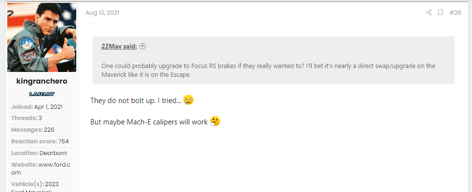

I can't be the only person that has wondered about the compatibility of this kit with the Maverick front end. Especially for those of you already squeezing more power out of the 2.0 motors. From some very surface level research on the Escape forums, it does look like the calipers and rotors will fit the previous generation, which I'm guessing is pretty similar to the current car from a suspension standpoint. The included brake lines are apparently an inch or so too short for that platform, though.

Good find. I didn't even see that thread in my research. I guess I shouldn't be surprised they went for parts commonality with a beefier car, but that RS kit would've been such a great bang for your buck upgrade.

I'm working on the Focus RS front BBK upgrade for the Maverick. It will happen. 😉

I know it's been a while, but any updates/pics of the brake set-up?!
Thanks
The Maverick has an interesting brake setup, larger rotors and beefier calipers than anything else on the C2 platform that I'm aware of. You would think at the very least bronco sport brakes would be a plug and play swap but they're not. It's part of the reason why bronco sport owners can go with a 16" wheel and tire package but they will not fit on the Maverick.
