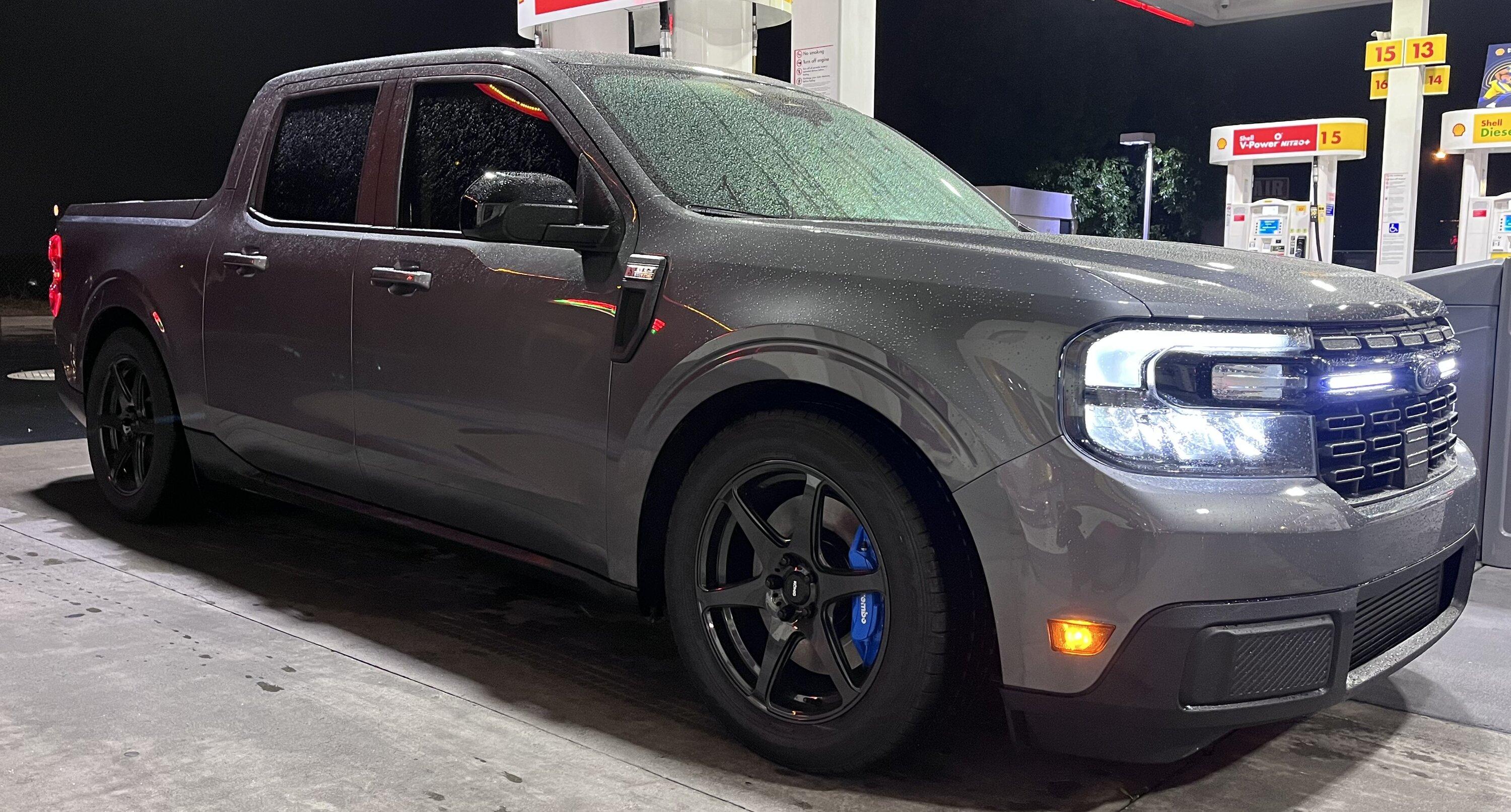

Some of you know I’ve been working on front Brembo kit. Well they are now in the testing stage and will be ready for sale soon.

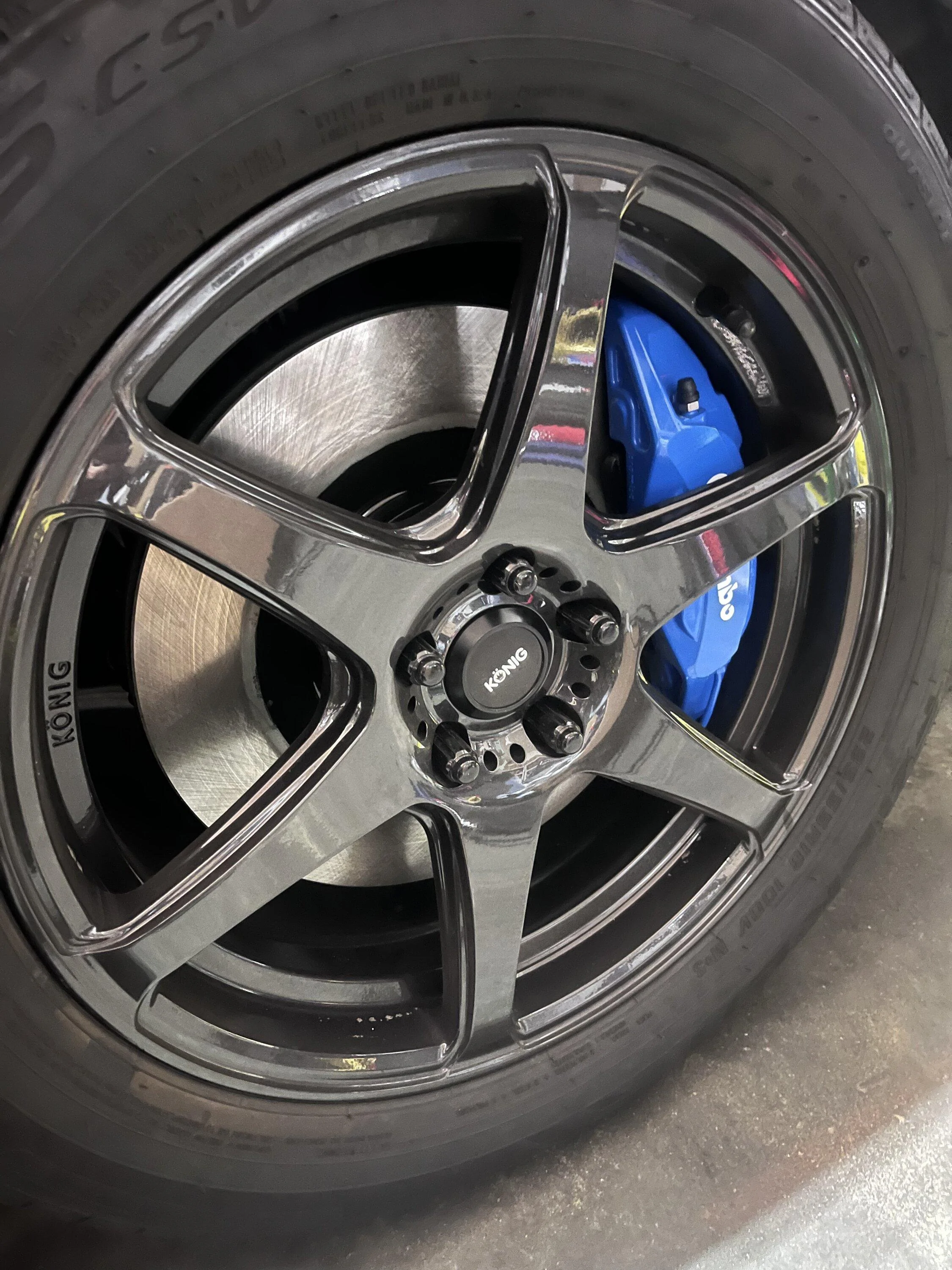

Larger rotor size?diameter and thickness?
Or aluminum hat section?
Fits stock 17” alloys?

Focus RS rotors and calipers.

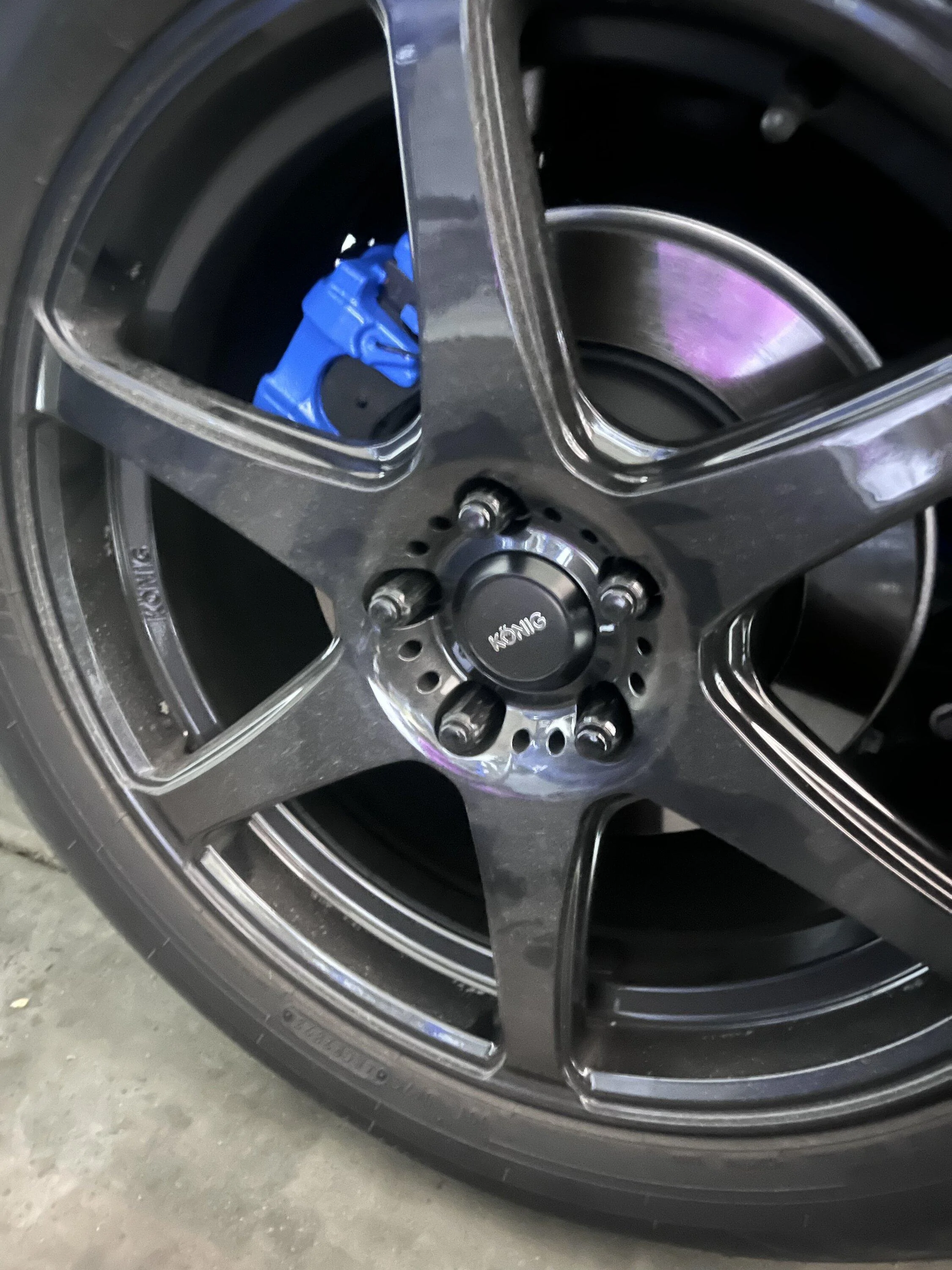

I painted the rears to match the front calipers. A few more weeks of Street testing them and by then I should hopefully have the first run of brackets for sale.
I can say that the stopping power is significantly improved and from what I can tell brake bias is not an issue at all.

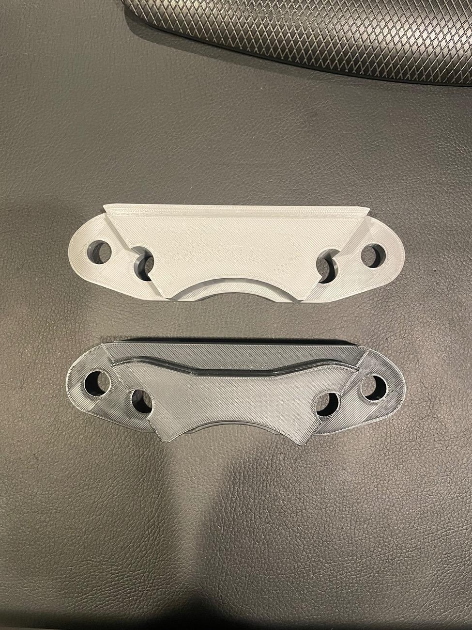

On another note, the final bracket version is done. These will require no Caliper machining whatsoever. First batch and brake lines will be done next week. So if all goes smoothly, complete kits will be shipping next week.
