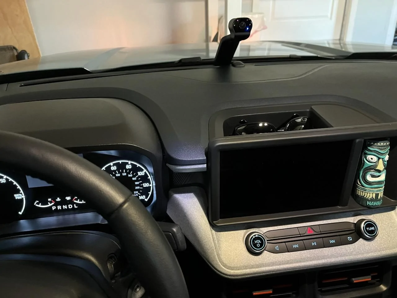

Where DID you got your Tiki totem?

Not a big fan of how it sticks up in the center of the window. I like my Garmin 47 Dashcam cause it can hide out of sight behind the rearview mirror. Also paid for itself when a lady turned left and cut it tight driving into me while I was at a stop sign and tried to leave.

Are you going to use Ring Protect Go?
I'm curious as to how long the truck can be parked somewhere busy - with the dashcam active using Ring Protect Go - before it goes into deep sleep.
Ring comes with a 30 day trial of "Protect Go". I will try this out and see if it is worth the subscription fee.

Where did you pull power from?
And are you able to adjust the angle of the arm so it is lower to the dash? It looks like it would annoy my OCD for an unobstructed view of the road
The power comes from the OBD-2 port. The dash cam is plugged into the port. It has a battery safety feature if it sees the battery power is going too low.
Yes, I can adjust the angle of the camera. It does not block vision out the window.

Pretty sure it's not adjustable, that was one reason I decided to not get one. Plus the fact of the high monthly charge, which would be a separate bill from my other Ring cameras. Not to mention a high number of negative reviews (suggest anyone thinking about getting one to read those reviews) and the spendy price of the poor-quality camera. Also looks like an easy target for thieves.
The camera has motion detection. If someone was approaching your truck, the camera begins recording and the footage is in the cloud. So even if they broke into the truck, it would record them. Although the damage would be done and chances of catching a thief would be small.
You do not have to have a subscription to have the camera to work.
I love my Tiki Totem! I got it in Hawaii on the big Island. They had it in a tourist shop and I thought it would be a good choice for the cubby. It is made of plaster and I had to grind the little guy at an angle in order to get it to fit snug in the cubby. The Totem is the other half of my securely system. :)

I agree. Had the camera active for a few days now, and I have no issues with it obstructing my vision out the windsheild. I barley even notice it anymore.

Today I installed a ring car camera. It has front and rear facing cameras. Easy to install.
And the purpose of a Ring car camera is? Security? Anti-theft?
What if a crash is your fault and the camera shows this? Not so good, right?
