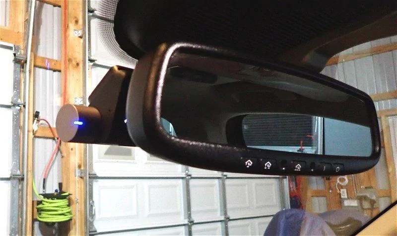

Got new dash camera installed today.. look below

I am so happy with it

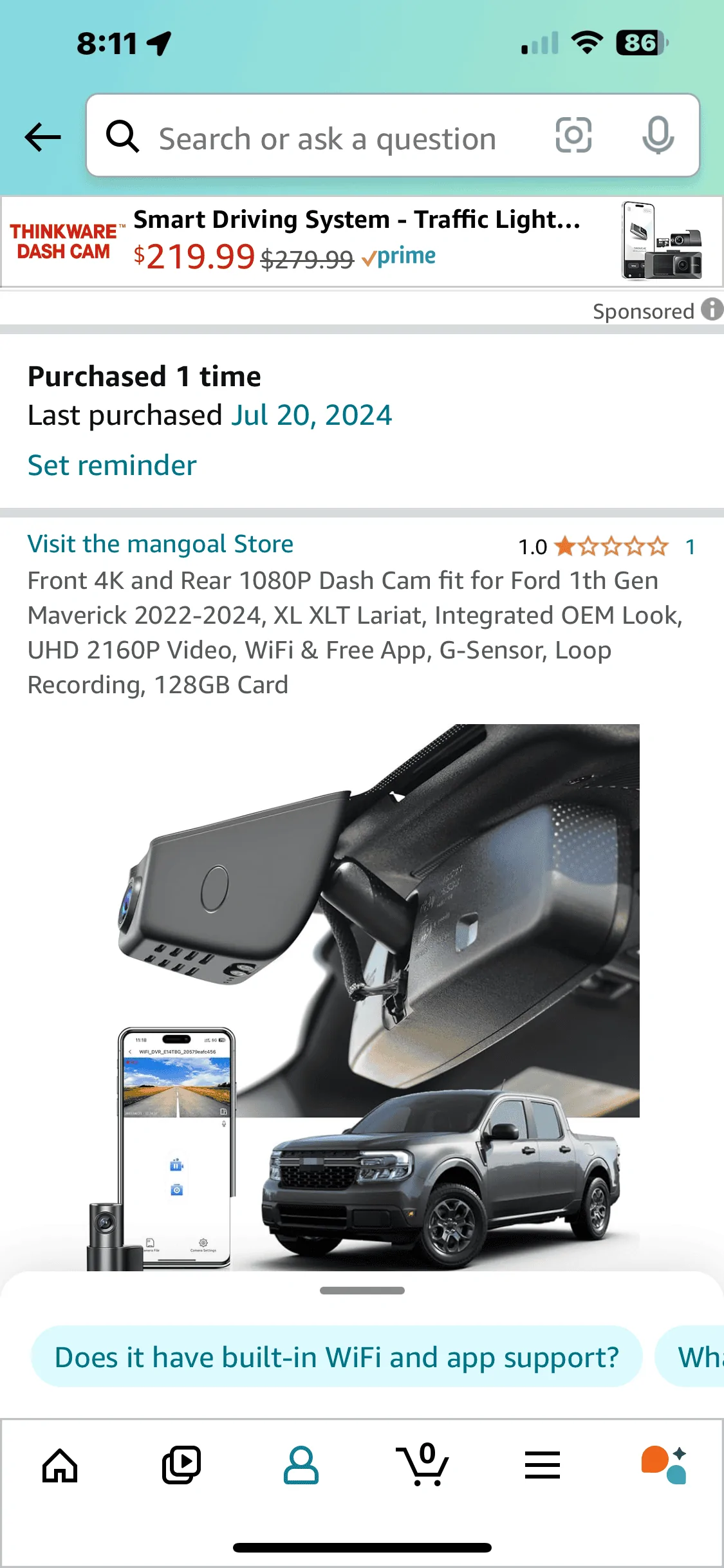

CREDIT: B. Slaughter [AMAZON Review/ 09 April 2024]
This package has a patch cord to use with a powered mirror. However, NO trim level of Maverick has a powered mirror!
My wife asked about the wires and the manufacturer responded only saying to use the long cord (included) and plug into the OBD II port if no powered mirror. The Ford Maverick manual specifically warns AGAINST plugging items into the OBD II port.
There is power nearby in the Ford plugs above the mirror and a patch cord could easily be made to use between the Ford Image Processing module, connector C9039, or the interior dome lights, connector C928, but there is no guidance as to the wiring requirements of the camera.
The camera has 3 wires:
A Black wire (which I know is ground), but also a yellow wire and a red wire. There is no information in the manual as to what these other 2 wires require. If the manufacturer would respond as to the requirements of these 2 wires, it would make the camera usable. I suspect the RED wire needs a continuous 12 volts and possibly the YELLOW wire needs 12 volts that is switched on with the ignition, but I would like confirmation before attempting to make a usable patch cord. Until the manufacturer identifies what these wires need, the camera is unusable on a Ford Maverick.
I will be happy to edit this review if the manufacturer can provide the needed information to make the camera work on a Maverick. The kit should actually include a patch cord for one of the two existing connectors, instead of one for a non-existent powered mirror.

Plugged mine into the inside fuse box and the rear camera plugged into the front camera. Same with my mirror. Pretty easy runs. They came with long enough wiring to reach the fuse panel. My OBD II port already has my scangauge II that I use for towing.

This is the FitCamX style camera (I have one) -- looks like a couple companies are using similar or the same. Been really happy with mine as well.

Ive only used FitcamX for my dash cams of late and they have performed flawlessly. I wired mine up to the OBD port and had NO issues with it no matter what the manual says. after I traded in my Maverick with the cam still attached the dealer said it was a sale point when it was sold to another buyer.
Black: ground
Red: 12V battery (always on)
Yellow: Accessory (active when ignition is on probably for a parking mode).
