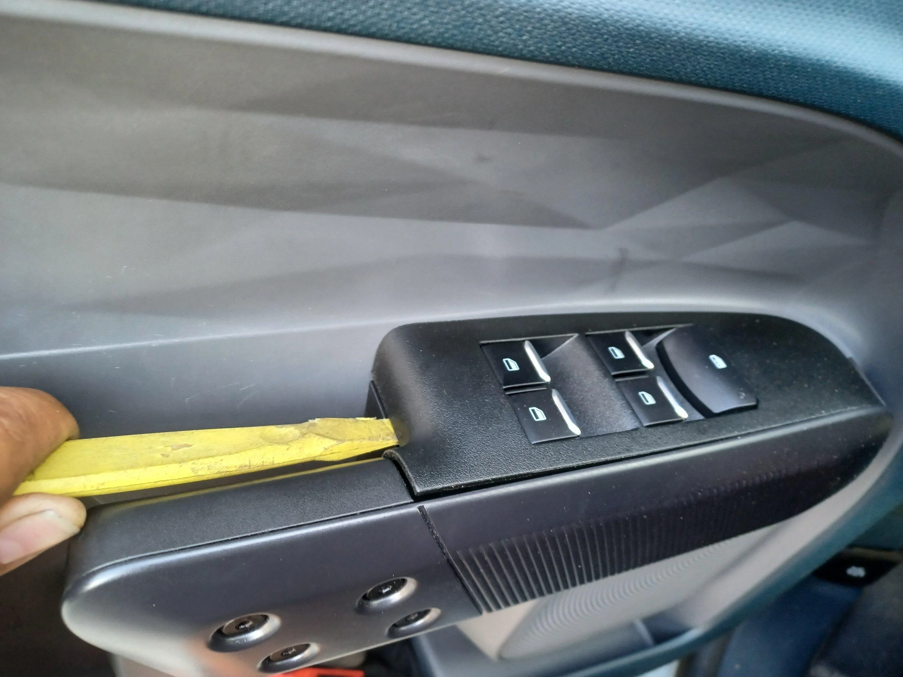

First remove the RIGHT REAR window switch - you will need a plastic pry tool. I don't recommend any metal tools as it will indent the plastic however in a pinch it works as long as you're careful. Find the seam of the switch assembly that faces the rear of the vehicle
lift the back end up then slide rearward. The clip is very snug so it may take a bit of effort

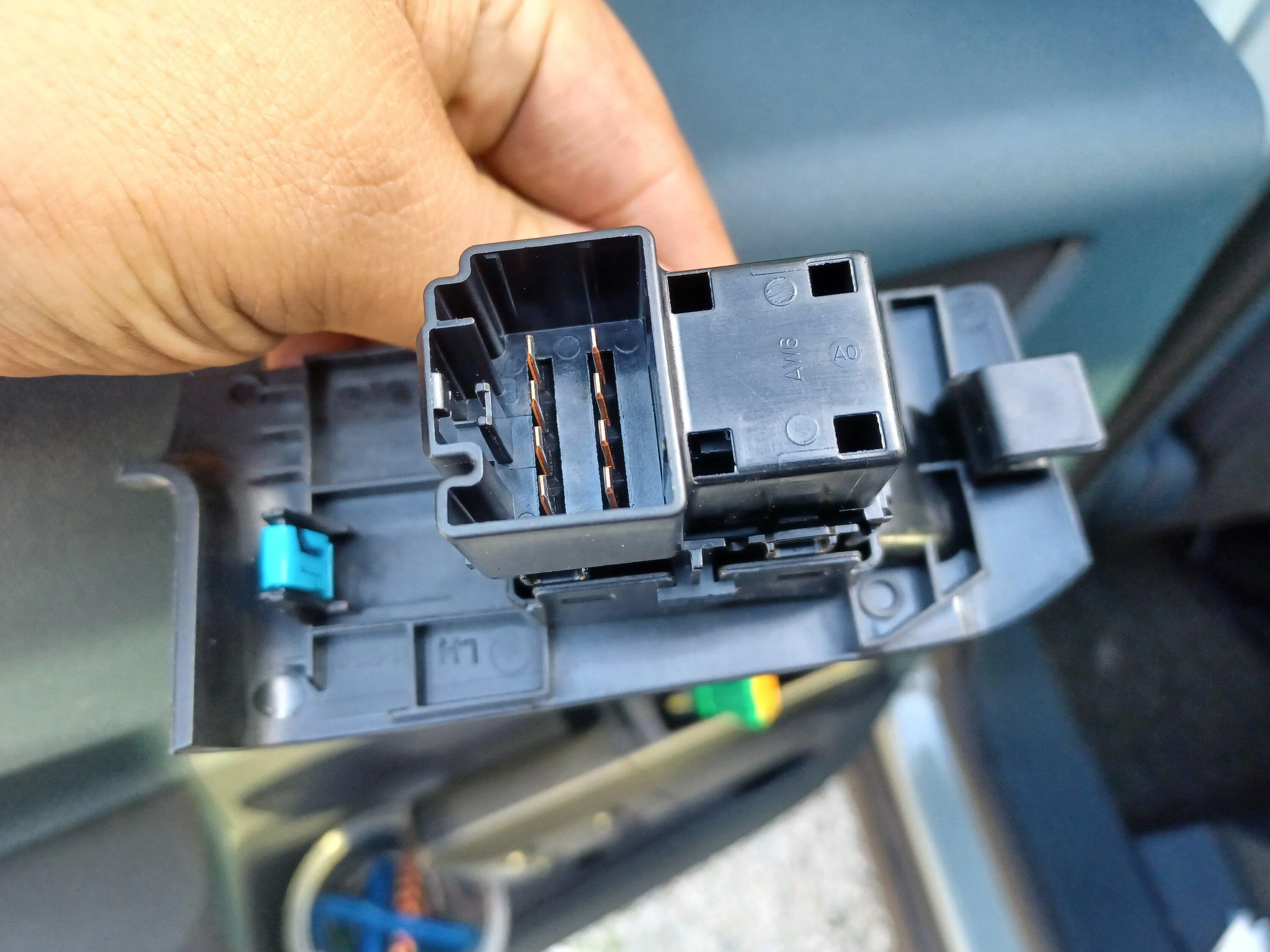

notice the blue clip and black tongue to get an idea how it's held down (left side pictured)

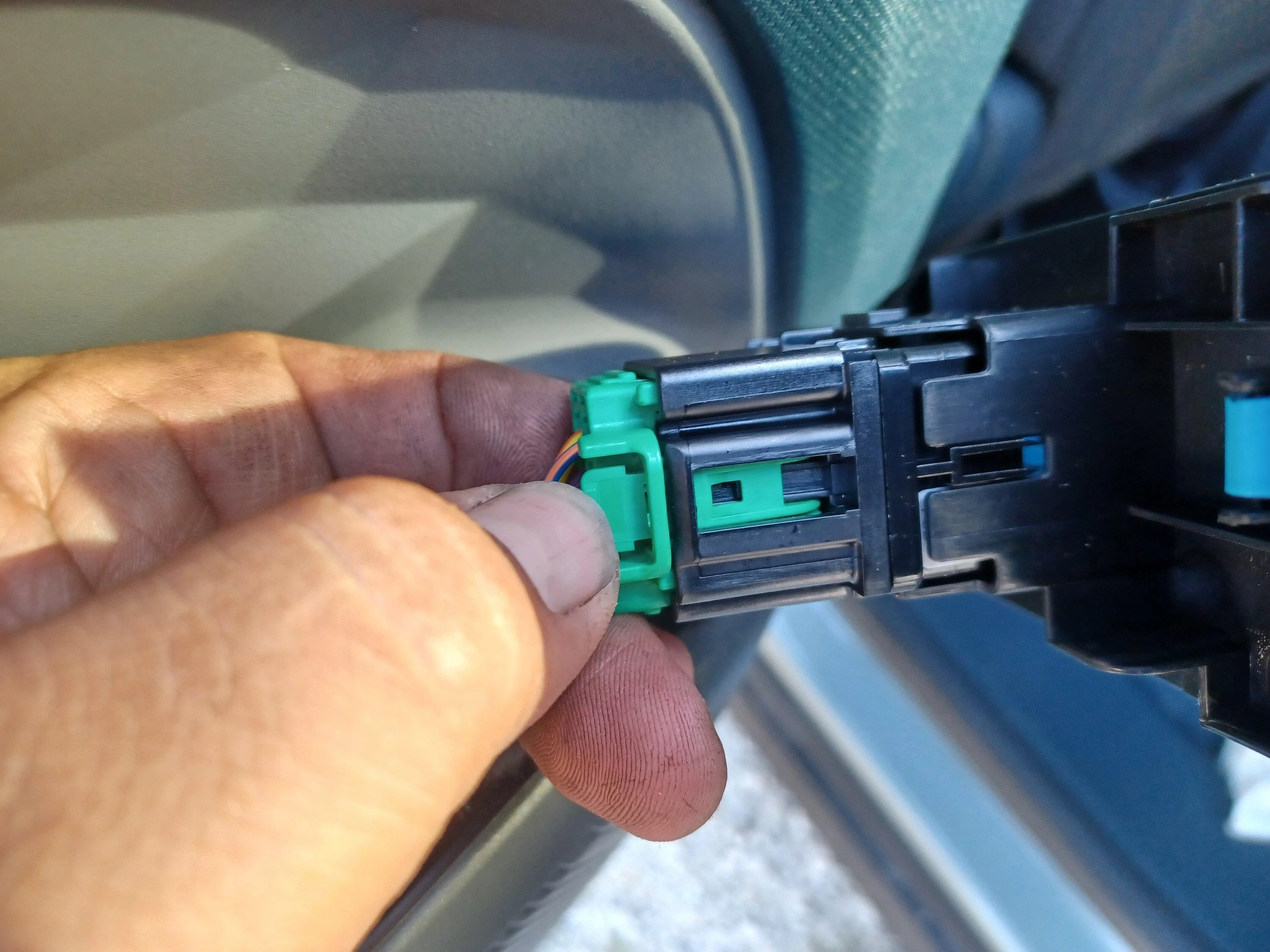

unplug the green connector by pressing the tab with your thumb then pull outward
PLEASE READ THIS NEXT STEP CAREFULLY!!
Count the number of wires at the connector! if its 8, then proceed to the next step, if there are only 4, skip over to the auto down section.

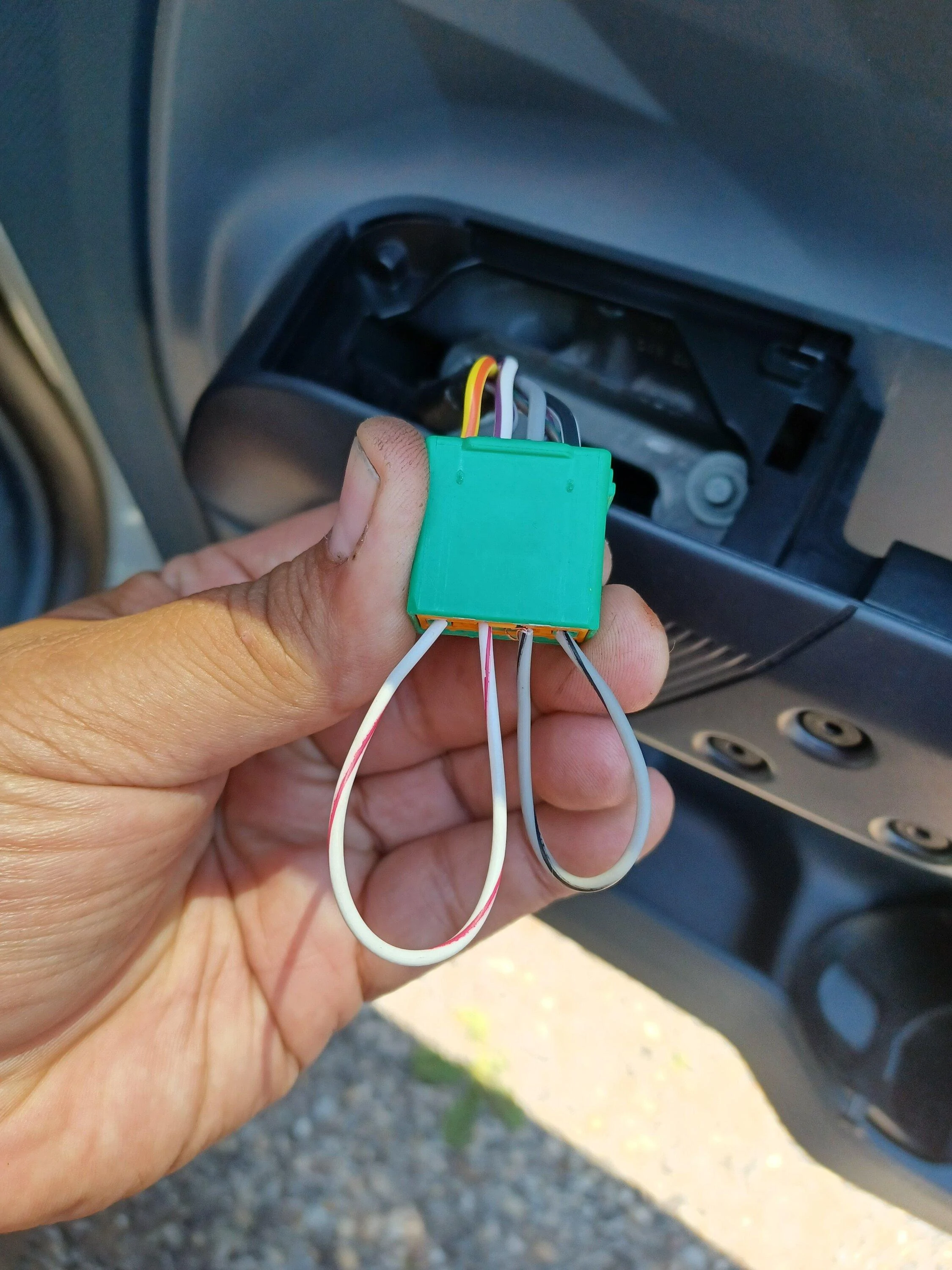

MAKE SURE THE IGNITION KEY IS IN THE OFF POSITION! DO NOT DISCONNECT THE BATTERY!
Identify the LARGER 4 wires. They will be in a row and in the following colors:
Yellow/Orange = 12v key on battery
Violet/White = window motor (positive up, negative down)
Gray = window motor (negative up, positive down)
Black/white = ground/negative
Those four wires are significantly larger than the other four. DO NOT use the smaller four wires. These colors only apply to the RIGHT REAR window.
Jump the Yellow/Orange to the Violet/white, and jump the Gray to the Black/White
Use the terminal side, I found it's easiest that way.
I do not recommend paper clips but if you are in a pinch, make sure they do NOT touch
Once you have made the connection, go to the driver's seat, LEAVE THE DRIVER DOOR OPEN, then turn forward the key (do not start), the window should go up. Once it's fully up, shut the vehicle down.
Undo the wires. DO NOT plug in your window switch, leave it off OR reinstall it WITHOUT plugging it in. DONE!

Pry up and remove the Driver's window switch by inserting the pry tool at the seam facing rearward
it will take some effort as the clips are tight. Lift the backside then slide rearward.
Once removed, unplug the main connectors and remove the switch.
the switch may not come with a bezel, there are small tabs along the body of the switch panel itself you will need to pry to get the switch out of the bezel.
