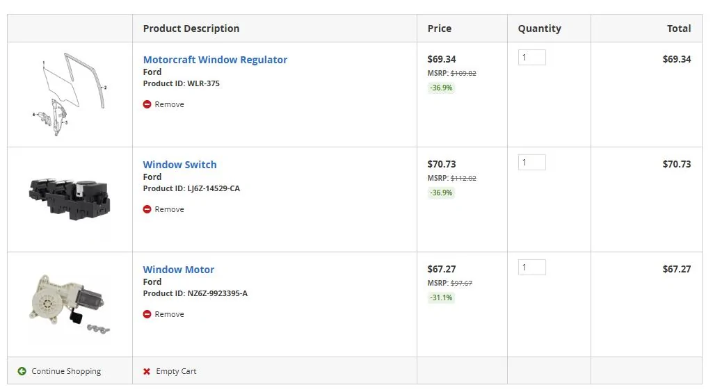

A couple of weeks ago my LEFT REAR (drivers side passenger) window stopped rolling. At first, it was sluggish and kind of loud, then it got completely stuck. Thankfully, it is stuck closed, so I haven't been in a rush to fix it. When I press the window button down, the door still makes a sound, but the window doesn't move. The motor in there is still turning somewhat. I read up on here and have seen that this is probably a common issue caused by the driver's window switch. I do plan on replacing that, but I'm not sure if I need to replace the motor and/or regulator. My mechanic friend listened to the sound it makes and thinks it's the regulator, but other forums I've read on here have said that the motor can burn up because of bad voltage sent by the driver controls.
Which of these 3 parts most likely should be replaced?
Where should I buy the parts? (I tried Rockauto but they don't have the motor)
I found these on Ford.oempartsonline.com

I presume you are past the warranty mileage?? Process of elimination: I think do the window regulator first. Let us know what turns out to be the solution. Good Luck!

UPDATE: FIXED
I bought the regulator, motor, and driver switch online and had a mechanic friend help me replace them. The cables in the old regulator were bent up an out of place. It did appear that I was having the same issue as others, in that the driver switch was sending too much voltage to the window. Out of caution, I replaced the motor, though it may been unneccesary. The switch and regulator are musts. Everything has been working normal for the past week since repair.
