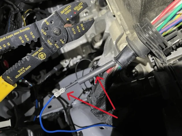

That said, the DRL circuit would be where I'd probably have gone first. That taps off one of the three wires coming out the headlight connector. Very easy to reach. Depends on if you want it on always or just during the day...
Lariats are a different case. They utilize the accent lighting on the top of the headlights for DRL and the BCM or the headlight's internal module monitors either the current or resistance of their circuit. As a result if you tap directly into them to power additional lights it detects it as a fault and disables the circuit.
Ah gotcha. So tap into the accents then?
No. As mentioned, the controlling module sees that extra load as a fault and will disable the accent lighting (and whatever is attached to them) after a few cycles. So it needs to be powered off some other key-on power source.
I've only seen one person get away with tapping into the Lariat accent lights but they were using switchback lights that had a control box with a separate power feed so probably didn't have the extra draw that'd trigger the overcurrent disable.
https://www.mavericktruckclub.com/forum/threads/how-to-wire-switchbacks-on-lariat-drl.13388/
Oh was it? I hadn't gone back to look at that post for a bit. What's the amp draw on these accent lights? This thing isn't a factory installed option?
