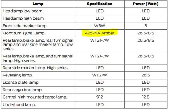

So I don't have a Maverick yet, but those amber bulbs reflecting off the front blinkers or orange/amber even when off bothers me aesthetically. Figured I'd share this should be an option to fix that issue.
1) LED Option:
2) Chrome bulb option:
The proper size are the first ones, as factory are 4257NA, but you should be able to modify 3157s to fit in 4257.

Slice the little nubs off the sides
FWIW 3157 LED do not work with the tabs removed. The body is 2mm wider and will not fit into the lamp slot.
