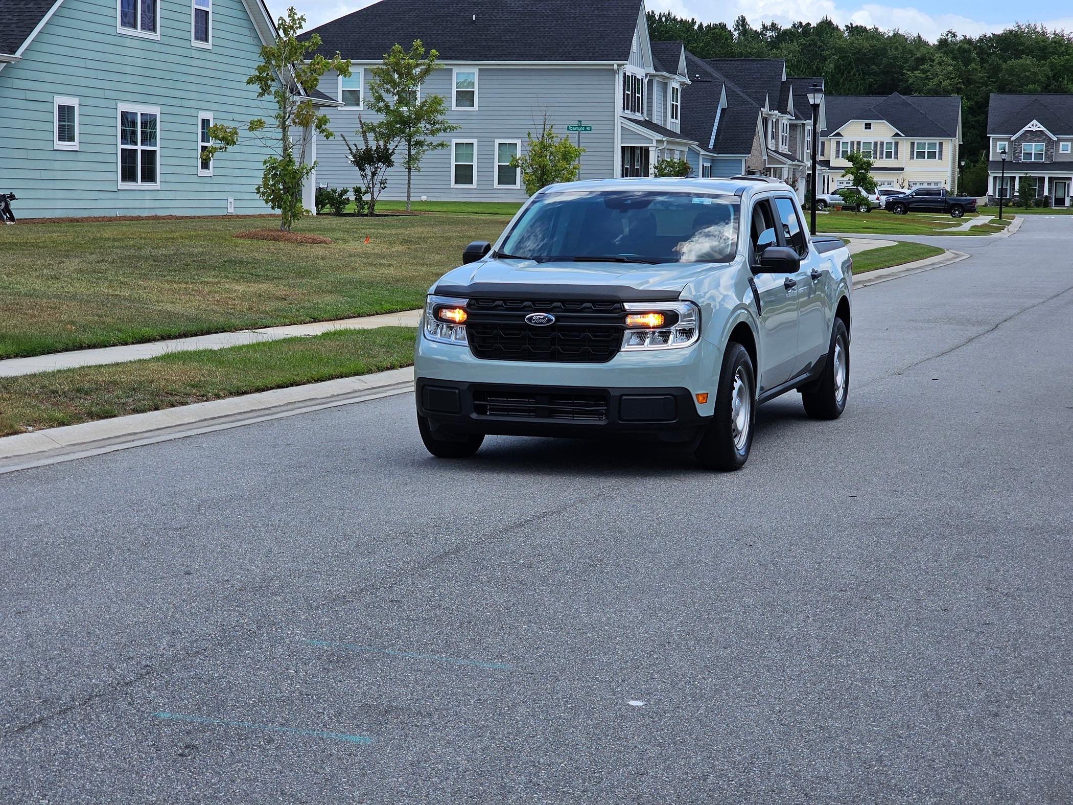

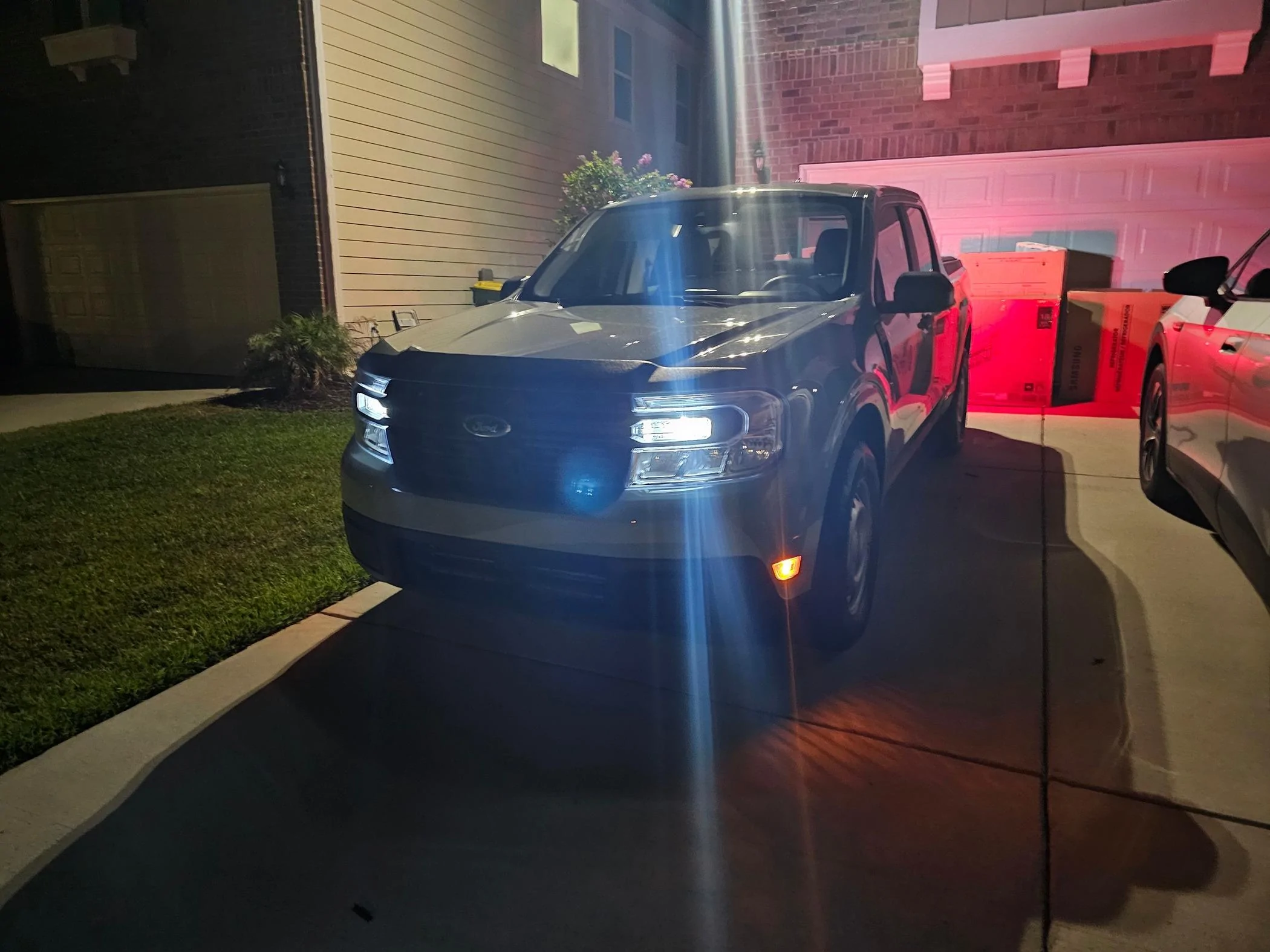

Hello, I just followed the excel document on the ForScan page on settings for the hyperflash.
My question is, during daytime, is the DRL supposed to be yellow, but at night it's white?

I believe they're suppose to be white anytime the parking lights are On, when the blinker is engaged they switch to flashing amber. As why they're called Switchbacks.

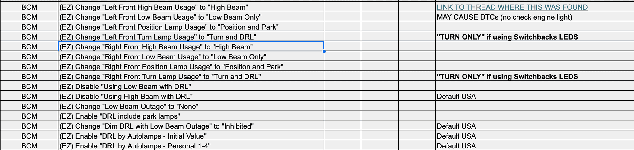

Hey make sure you make these two settings "TURN ONLY" instead of "TURN AND DRL"
Ahh, that's probably why.
So if I use "turn only", it will still using the turn bulb as DRL? Just using white color, right?
