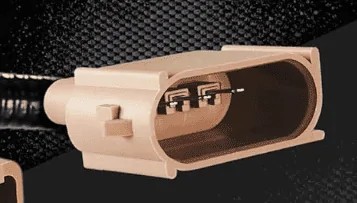

Does anyone know what type of connector that is. Like I know the 6 and 16 pin ones are molex but what type is the one used for the blinker.
trying to find both male and female ends.

So the plug on the harness is the wpt-1167 connector but I cant find what the one that plugs into it is called.

I did exactly this. The harness gives you Left + Right + Ground, brake is unused. I used the 4 pin with an adapter to my wires, but you could just theoretically cut the 4 pin and use whatever you want. I spent ages looking for what you were, and then came across this.
You can see a video my comment history with what I wired into mine ( 2 sequential running board + hood led sequential )
Yea, I'm not seeing any way around buying this one. From what ive found on other ford forums. I think the male end is actually 3d printed by a company and they must mass buy.
At least the 16 pin one can be had on ebay with all the pins. I've got a tool for crimping them already so I can at least make the connector for vastly less than opt7's price.

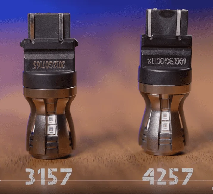

@Dmat @OXHB619 Do you think it's possible to replace the socket for the turn signal to get away from the 4257 and back to 3157 or 4157? It seems like the 4257 is mainly only for the newer trucks in the US market so they're harder to source.
So just from a quick google. It appears that the 3157 and 4257 are fairly similar in nature but do have some differences. For the 3157, there are tabs that stick out wider than on the 4257. They would have to be ground down. I've also read some people comment that the 3157 bulbs may be bigger but im not sure if thats true.
Replacing the socket could bring up issues if the opening to insert it arent the same. But otherwise I dont think anything electrical wise is different. Just form factor.
