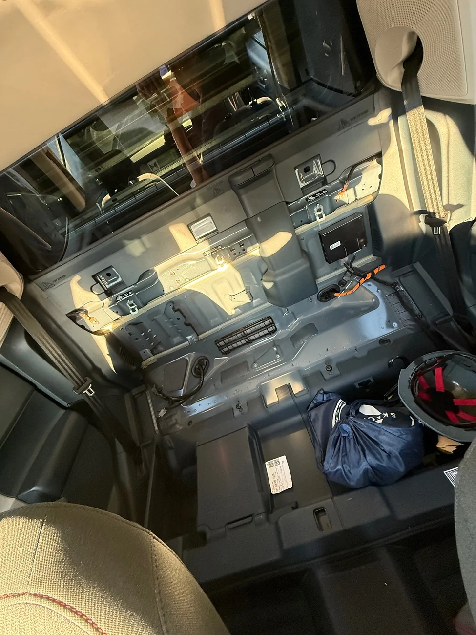

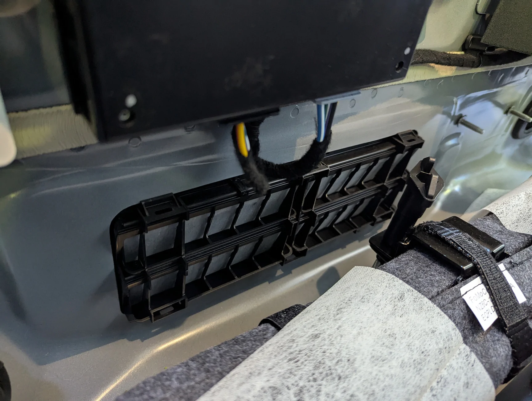

Hello everyone, sorry for the late update. So in fact it was that center filter/vent that was making the noise. Noticeably as it would open whenever the car was in motion.
I don’t plan to go down the box with foam part, many have suggested. I most likely have foam pads pushed against it with a storage bin.
It was some what expect that it was the vent, but I didn’t know how to address it. As the cabin would be so loud when driving with the vent open. Leaving the driver window open slight on the road would actually allow the vent to close making it quieter even with the driver’s window open.
Thank you all again.

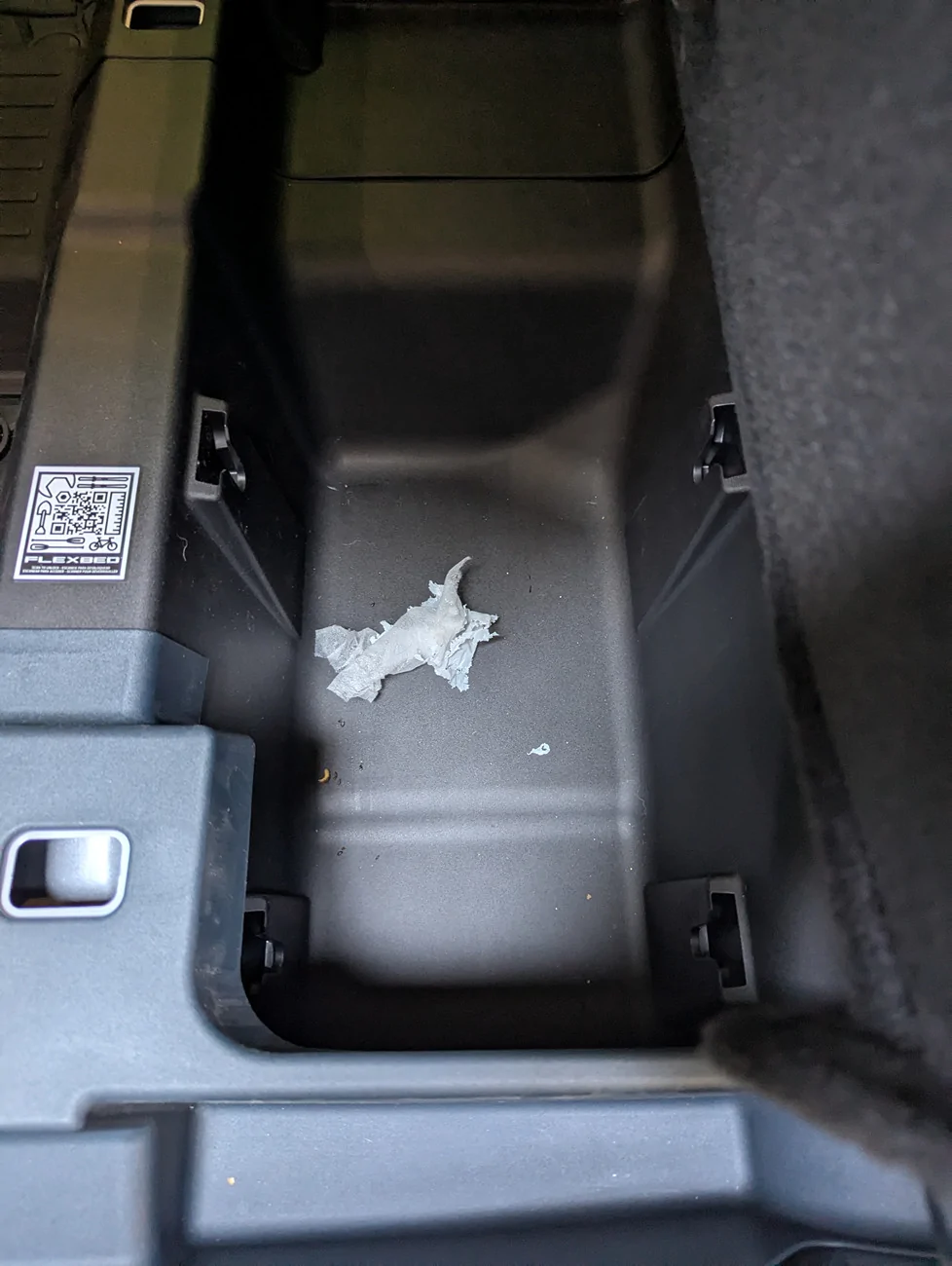

I'm pretty sure this vent is where I am getting mice entering the cab. I can see they've been in the under-seat bins and this vent looks to be the most likely point of entry. Now looking at adding some mesh to the inside to block it but allow air flow.

For my 2000 ranger and wife's 2016 Subaru, I inserted chickenwire within the air intake vents... they still caused damage elsewhere... but, it prevented the smell of death occurring inside....:puke: …the Mav seems to be a harder task...:question:

Sorry! Where are my manners LOL
I am awaiting on the 3/4” Plywood cut. It’s basically an empty space.
Sadly I can’t go to the back sear while I drive to figure out where the noise is coming from; either the foam pas behind the passenger seat or the vent in the center. Will try to plug the vent with some foam or clothing/fabric and update :)
Thank you for all the reply everyone.
Check cabin air filter I had a nest there. I think they are more likely to come through there poor design from ford check what I just posted today
