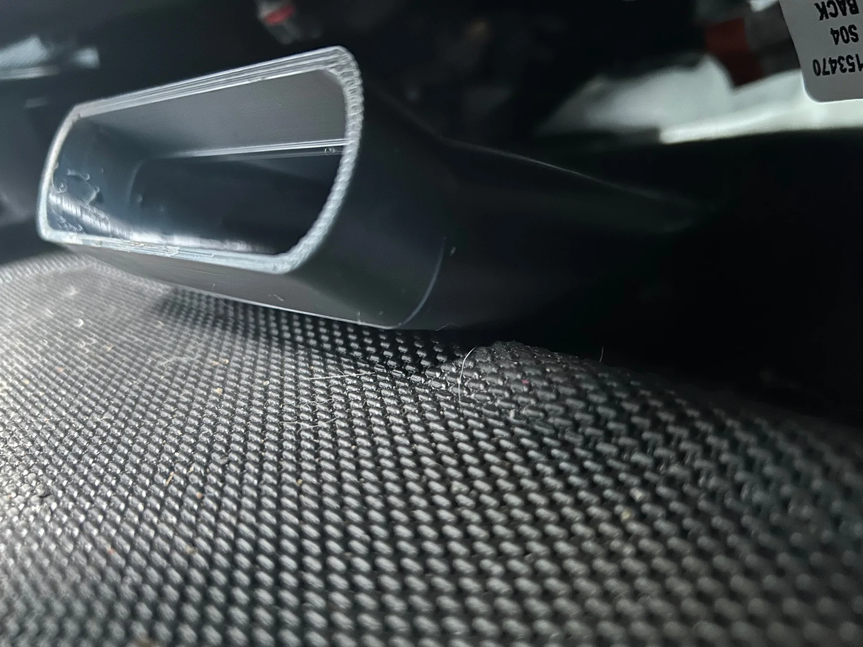

I had two sets 3d printed and used a heat gun to make one longer set for each side and getting them onto the ducts under the truck was a PIA, mostly due to carpet. But I also softened the ends before installing on the truck

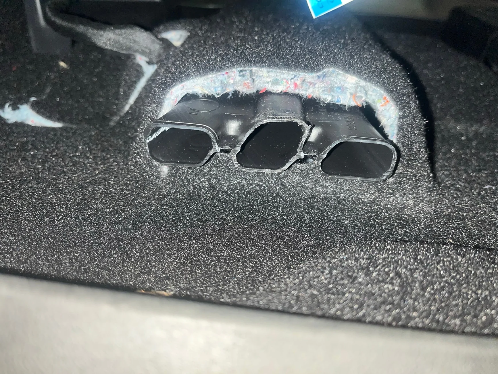

Don806 - I have a brother-in-law that has a 3D printer. What existing program is used to make the vents? I will also try to use a heat gun on the vent to soften to try to stick the vent cover from Maxzina on. The vent that is giving me the most trouble is the center vent as it sticks up higher than the other two vents as seen in the picture.

these are for F150, but they worked:
https://www.printables.com/model/935973-2021-f-150-rear-vent-extenders
guy made 4 pieces, so I used those to make 2 longer pieces. Heat gun and piece of wood to put them together and then heat gun on the end that attaches under the seat right before putting it on softened it up enough to expand it and then squeezed it (wearing thick gloves) and held in place. Getting it around the carpet was biggest issue.
Careful with that heat gun.
