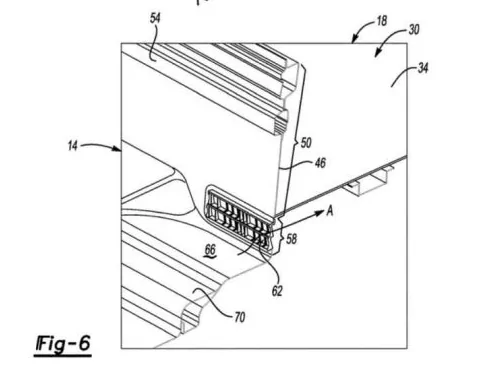

Can I ask fello Maverick owners who deleted their rear seat, how you solved this vent to be quiet but yet still functional?
I like the approach that @notfast is taking.
The rear seat not only acts as a sound barrier to the vent, but it also "buffers" the air moving through the cabin and out that vent. So, once you remove the seat, the air from the climate control or the windows is going to have a direct route through the cabin and right out through the vent, rather than around the rear seat in an indirect manner.
So, an angled box with one end open, sealed over the vent and stuffed with some medium-density foam as @notfast has suggested might just work as a buffer for noise and the rush of air through the vent.

It exits just below the front of the bed floor. I haven't actually crawled under to look at this to give any extra details about its accessibility, but I wouldn't be surprised if it's hidden behind a panel.

Just to clarify That is not the only vent. There is one behind both C pillar trim panels.

I'm sorry, I just assumed everyone knew the vent behind the rear seat was a one-way vent flap. Air cannot enter through it, only exit. If the air pressure inside the cab is higher than outside (like closing a door or turning on the fan for the vents), the flap will open to let the higher pressure out. Since it's a one-way flap, if the pressure is higher outside the cab, it cannot open, and the exiting air when open prevents any air from coming in.

Hey guys and gals,
Thank you in advance.
I got the chance to remove the rear sear for more cargo over this weekend.
But came to a problem, hope someone on this forum solved as it seems like a problem for everyone who removed their rear seat.
So after the rear seat removal. The vent on the back wall in the center (photo attached) opens due to the air flow coming when driving over 20kms per hour.
Apparently this vents out to the bottom of the truck so when the door closes it doesn’t break a window or what not.
The problem of this vent opening when driving is huge.. Road noise and also interior temperature wise.
