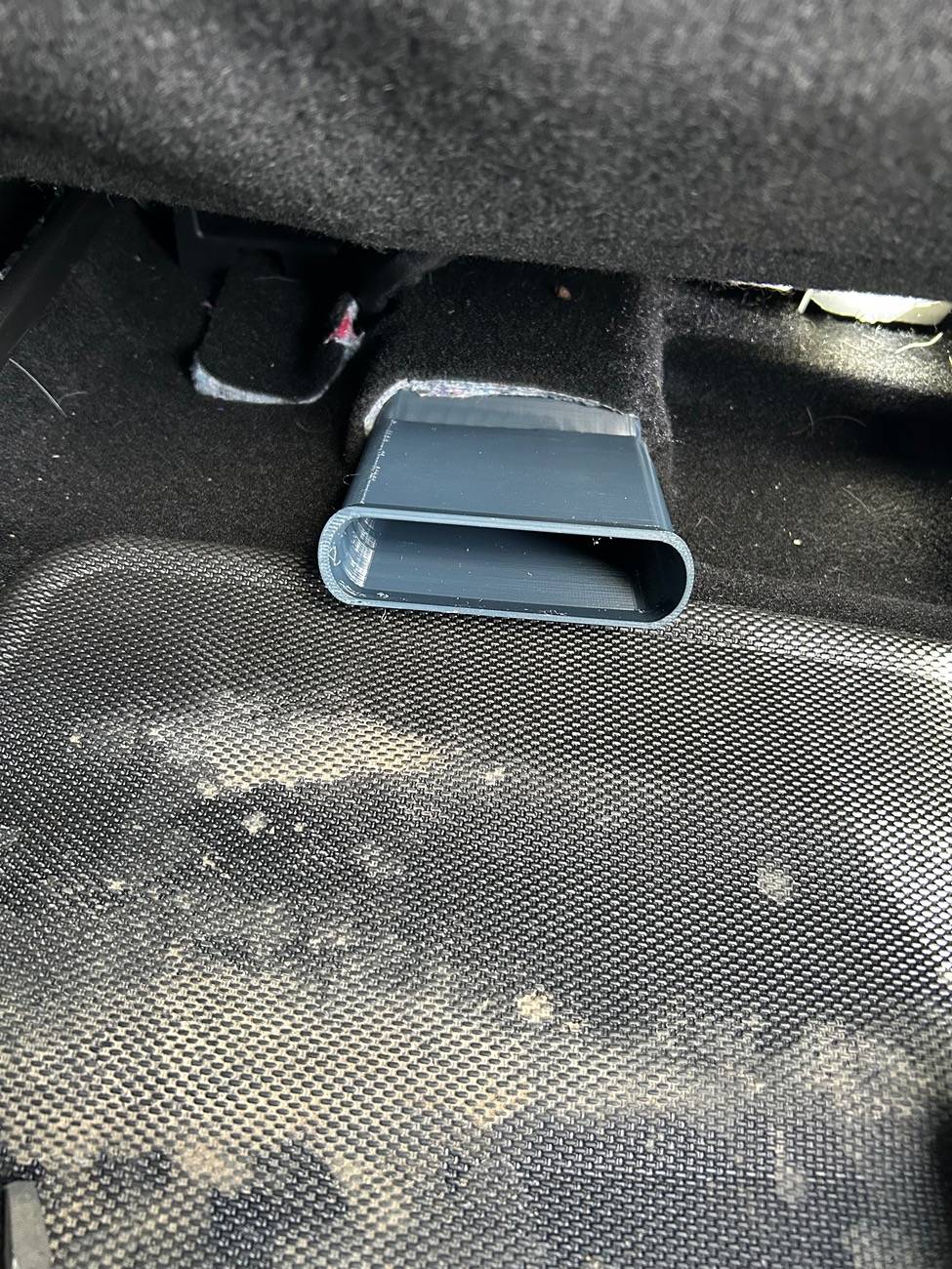

I installed some vent extenders this afternoon
Guy at work 3d printed them for me. Was kinda PIA getting them over the vents and inside the carpet, but they turned out fine. These were an F150 design, and without any mods would have fit in the maverick. I wanted them a little more snug so I traced the outline of the vents onto a piece of wood and carved it out with a dremel, then used a heat gun to soften the ends to shape them to fit tighter. I had two sets of them, so then combined two to make them longer, again using the heat gun to shape and mold one to fit inside the other. Still need to partially block off the front vents to get more air movement to the rear. That will come later with piece of fan-fold and hvac tape.

These turned out nice. I had more trouble trying to squeeze the extenders past the carpeting that partially obstructed the vents.
I had to use a screwdriver to get the carpet around it
Same here. Like I said earlier, it was the biggest installation obstacle.
