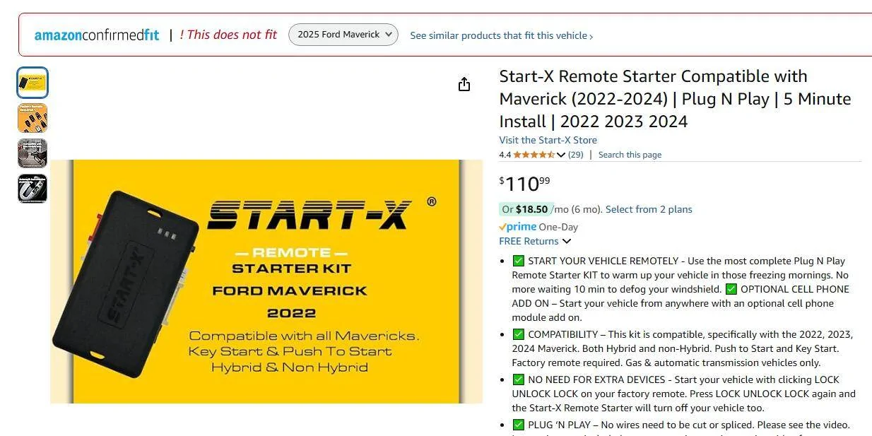

search google for "start X".. they sell a unit for about $100 that plugs into the back of the obd port and uses the existing key fob.. takes about 10 minutes to install and program..

The Perimeter Alarm and the Perimeter PLUS Alarm are two different systems. The Perimeter Alarm is standard on all vehicles.
I looked at that, but Amazon says it's not compatible with the 2025 Mavs.
Your right.. 2025 does not have a plug on the back of the odb port.. not sure if any company makes a remote start for the 2025, even ford..
They don't make one according to the email they sent me.
