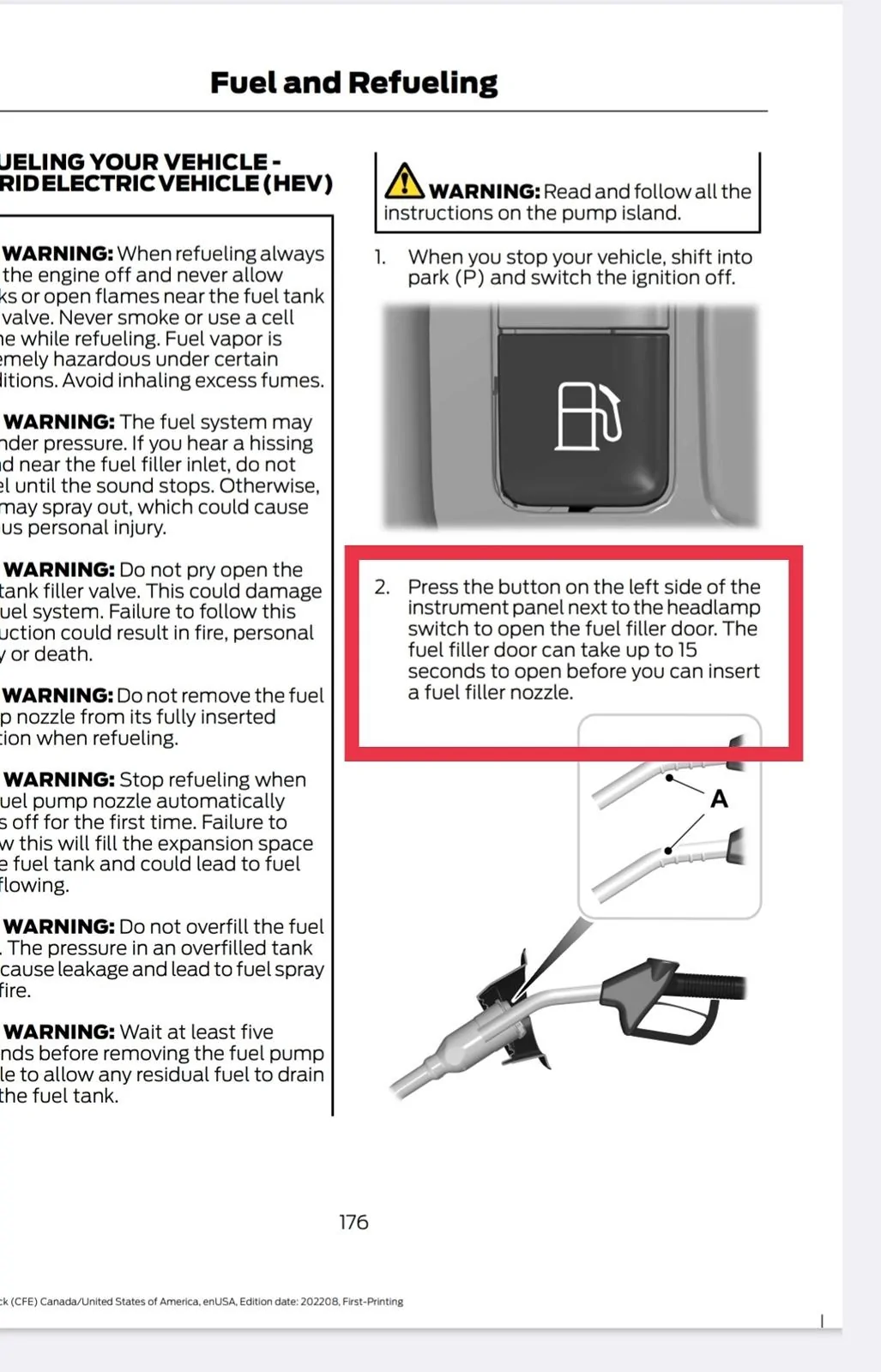

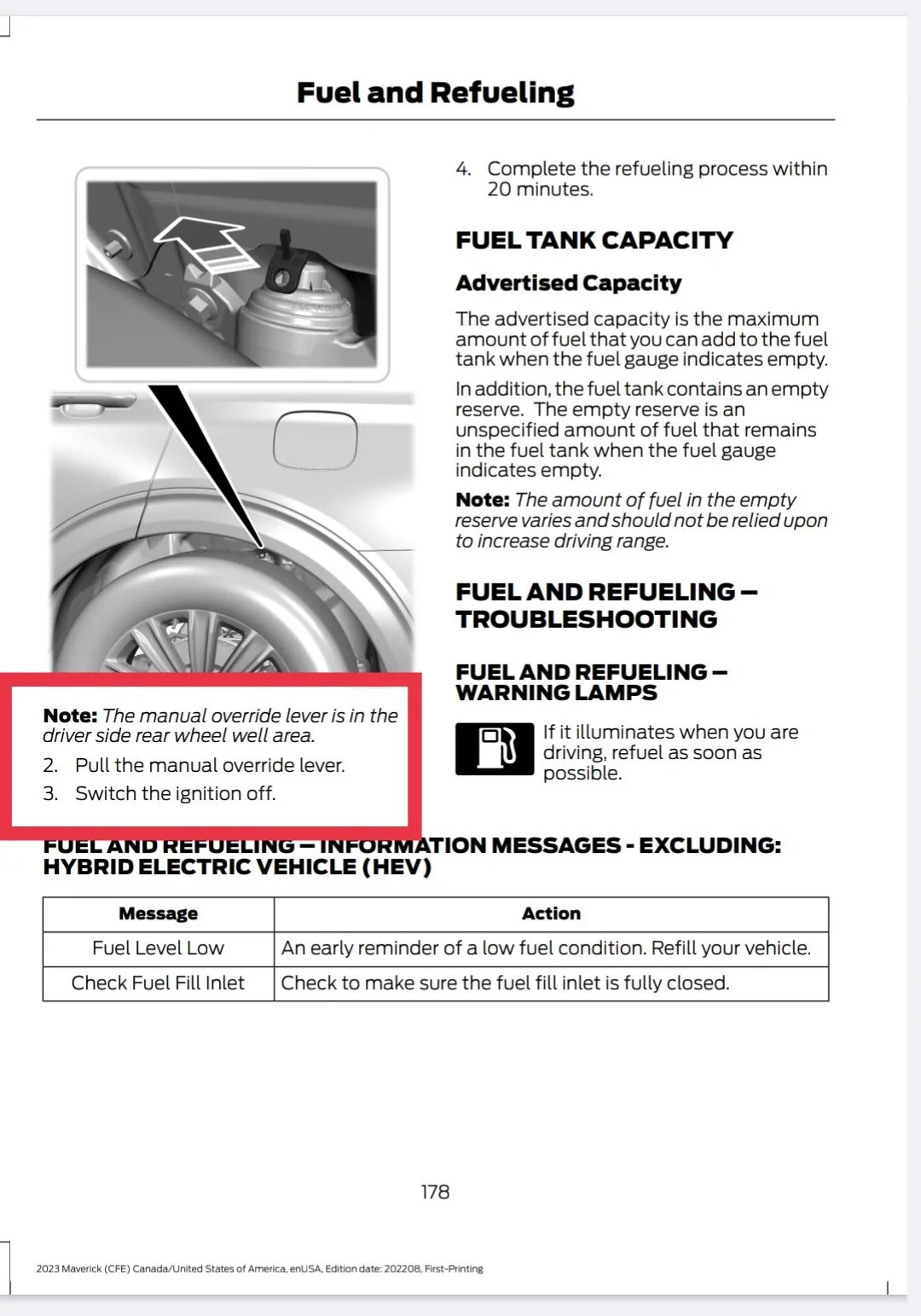

I had the same type of fuel door release system on my Chevy Volt. Therefore, I was used to waiting a few seconds for the system to depressurize.
Here are some screenshots of the manual that tell you exactly what to do and what to expect.
Ford Maverick Refueling Door Won't Open IMG_20240611_071523
Ford Maverick Refueling Door Won't Open IMG_20240611_072407
I hope this helps.
