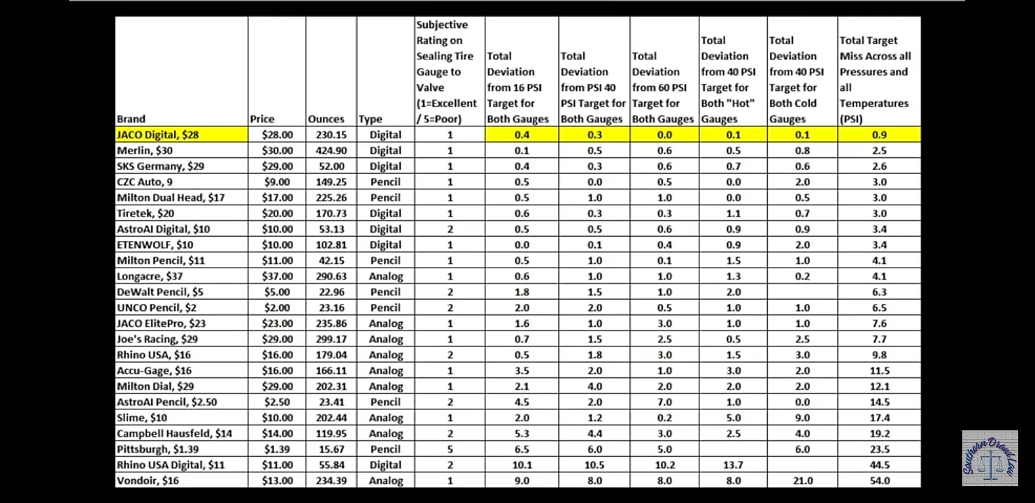

This is the one I use. It is excellent, and very accurate according to Project Farm. If you want quality as you say, it is worth the price, IMO. I've not experienced any analog gauge that was nearly as accurate as digital. I know you don't want to deal with batteries, but at least this one runs on common AAAs:
https://www.amazon.com/dp/B07VV78RZ1
I use the Jaco in the shop, but I keep a pencil guage in the truck that more-or-less shows the same pressure as the Jaco. Pencil gauges are great for portability, but are known to be inaccurate at temperature extremes.

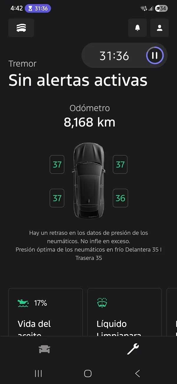

Ford app or dash can be off 1-2 PSI depending on it's mood
Try it
I set 4 tires at 37

First, thank to all for the replies. Second, I was laughing so hard at the DeWalt gauge 18 seconds in to the video that I had to pause it.
I am using the TPMS display to verify the pressures, thats why I no longer trust this cheap Slime gauge I'm using, it's consistently low by 4 PSI compared to the TPMS. It's not liquid filled and may actually be a bootleg.

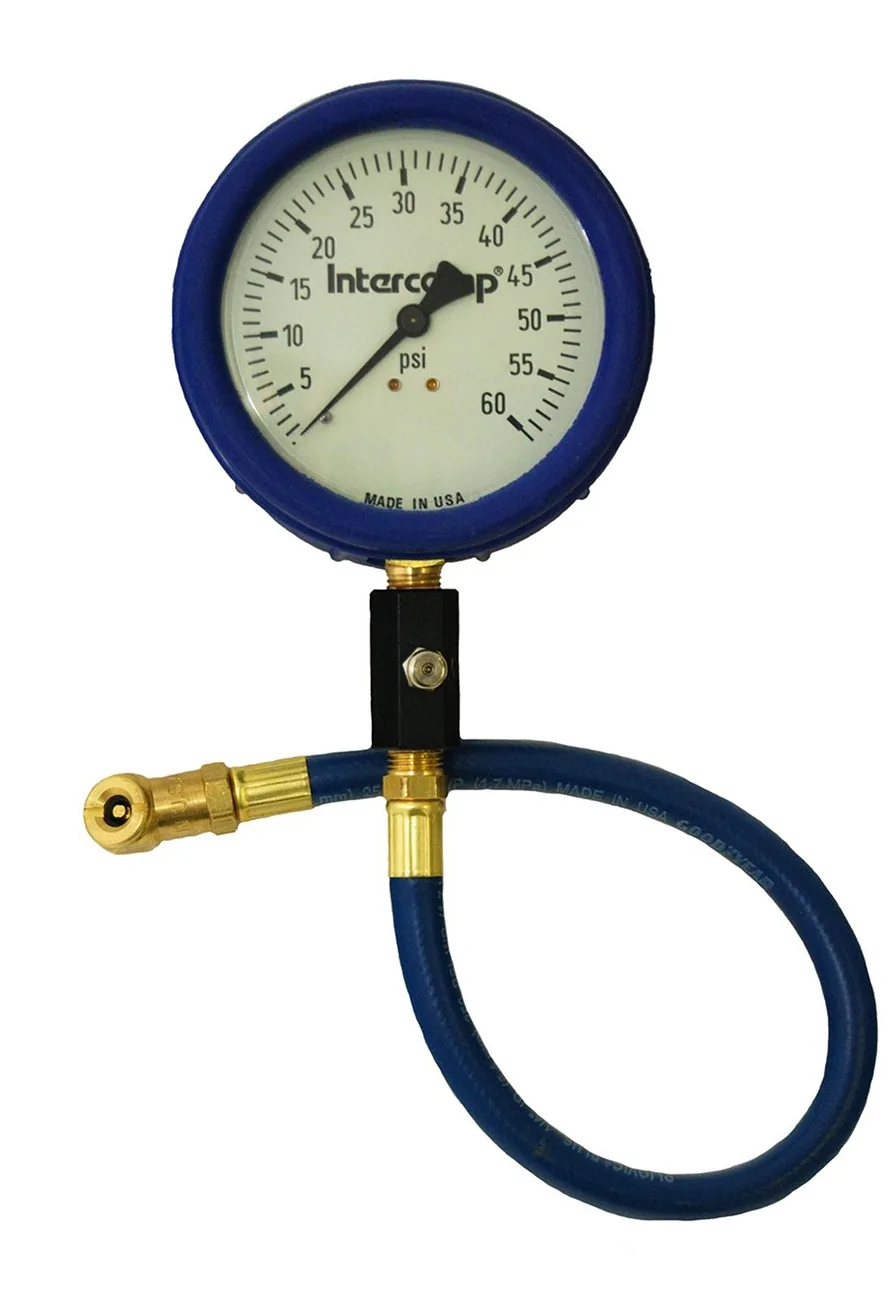

Highly recommend the Intercomp Racing Ultra Deluxe Gauge (Part # 360060).
I’ve owned one for more than 20 years. It’s absolutely heavy-duty and incredibly accurate. It runs right around $99.95, but it's a "buy it once for life" kind of tool. The 4" giant glow face is incredibly easy to read, and the 17" hose and thumb-bleed valve make adjusting pressures a breeze.
Intercomp Racing Glow Tire Pressure Gauges 360060
Part Number: ICP-360060
$99.95
Tire Pressure Gauge, Analog, 4 in. Diameter, Glow-in-the-Dark Face, 0-60 psi, 17 in. Hose, Bleed Valve, Each
