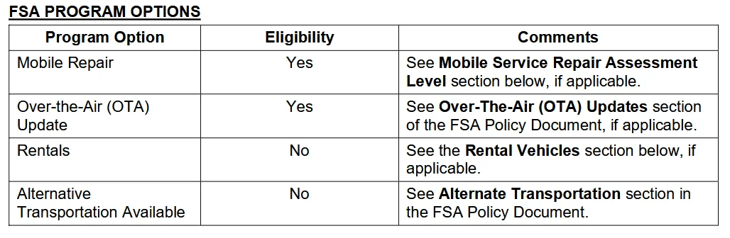

Its a quick little software update, I did one yesterday on an F150.
If you have automatic updates turned on then it should do it automatically.
Build dates affected for this recall-"Maverick 2025 Hermosillo April 11, 2024 through March 8, 2025"
"REASON FOR THIS EMISSIONS RECALL
The affected vehicles were manufactured with Powertrain Control Module (PCM) software that does not provide the required On-Board Diagnostics (OBD) warnings when the Intake Air Temperature (IAT) sensor is faulted with an irrationally low temperature, as required by regulation."
Ford Maverick Recall (Campaign 26E04) issued July 2026 - Powertrain Control Module - Software update needed. 1783787326133-r4
ZeroDay
Mar 24, 2026
64
124
Canada
2025 Maverick XLT Hybrid AWD, 1984 Volkswagen Jetta TD, 2007 Volvo V50 T5 AWD
Mine specifically says to schedule with my dealership and software is not available yet.
