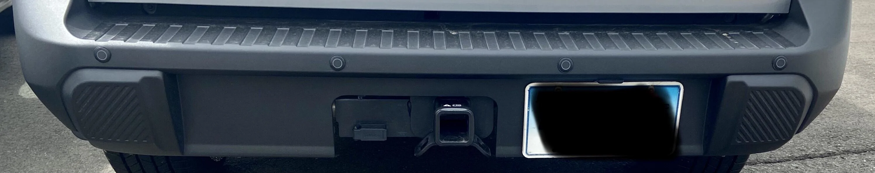

I’m looking at color matching my bumpers but I’ve seen you can paint the sensors and then it says you shouldn’t. I personally don’t care as to I don’t use them I tend to do old school look back and my mirrors. But on occasions that the wife takes it that’s another story she relies on those sensors and camera and even if I tell her to watch out chances are she’ll forget.
If I were to paint them I’m sure they wouldn’t work as well but will I hear a constant beep thinking I’m too close to something?
Is there any Ford vehicle that would plug in play that are already white?

Put some electrical or plastic tape on them and try it out?
The aftermarket set that I bought states in the installation instructions that they can be painted - don‘t know if OEM’s are the same.

just curious. Did you have to remove the bumper to install your sensors?

Nope.
Drilled in the vertical section

Can you provide pics on the hole locations?

Ford Maverick Rear sensors F80CEE44-6BC5-4C2E-A6A5-2014083D3270

What sensors did you use?
I’ve found part number 15k859 for the sensors. It looks like I can color match them so next I need to go under and see if all them are the same or if I need to get specific ones

How did you route wire to indicator / speaker in cab? Under truck, thru passage ways?

I ran them through the bed side and then into the cabin and mounted everything behind the right rear seat on the bulkhead.
