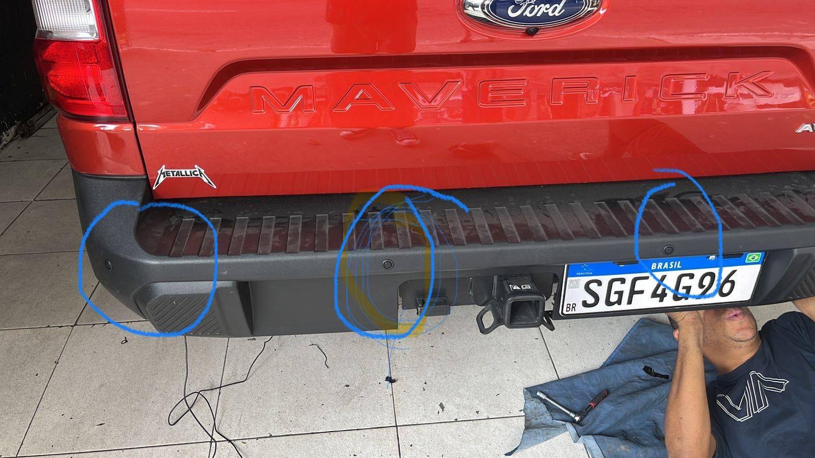

The maverick uses sonar , not the IR ones your used to seeing. The 2 sonar ones are located behind the bumper at 45deg angles on the corner
Man, I don't think you could be more wrong if you tried.
The common style are ultrasonic sonar (not IR) which the Maverick does use; they're located visibly in the surface of the bumper. On Lariats, 2025 with CP360 (all trims), and rare fleet order that optioned it.
The ones behind the bumper are for the CoPilot 360 BLIS/Cross-traffic detection and are radar.

What are you talking about two, there's a total of four one on each corner near each tail light and 1 to each side of the trailer hitch, for a total of four.
my 23 doesn’t have those, it uses radar on the corners. Must be a new system

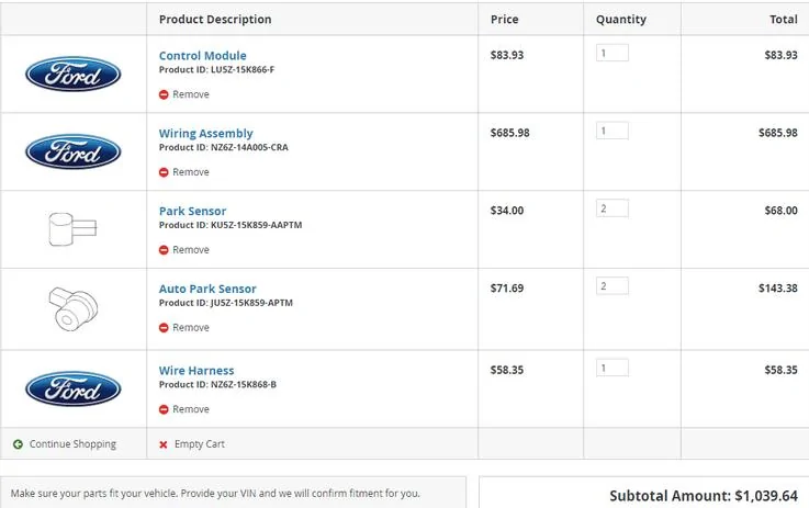

Rear Parking Aid, from: HELP NEEDED for rear parking Aid.
Automate
Wow, over 1K but most of it is in the full wiring harness which you could probably do without.
