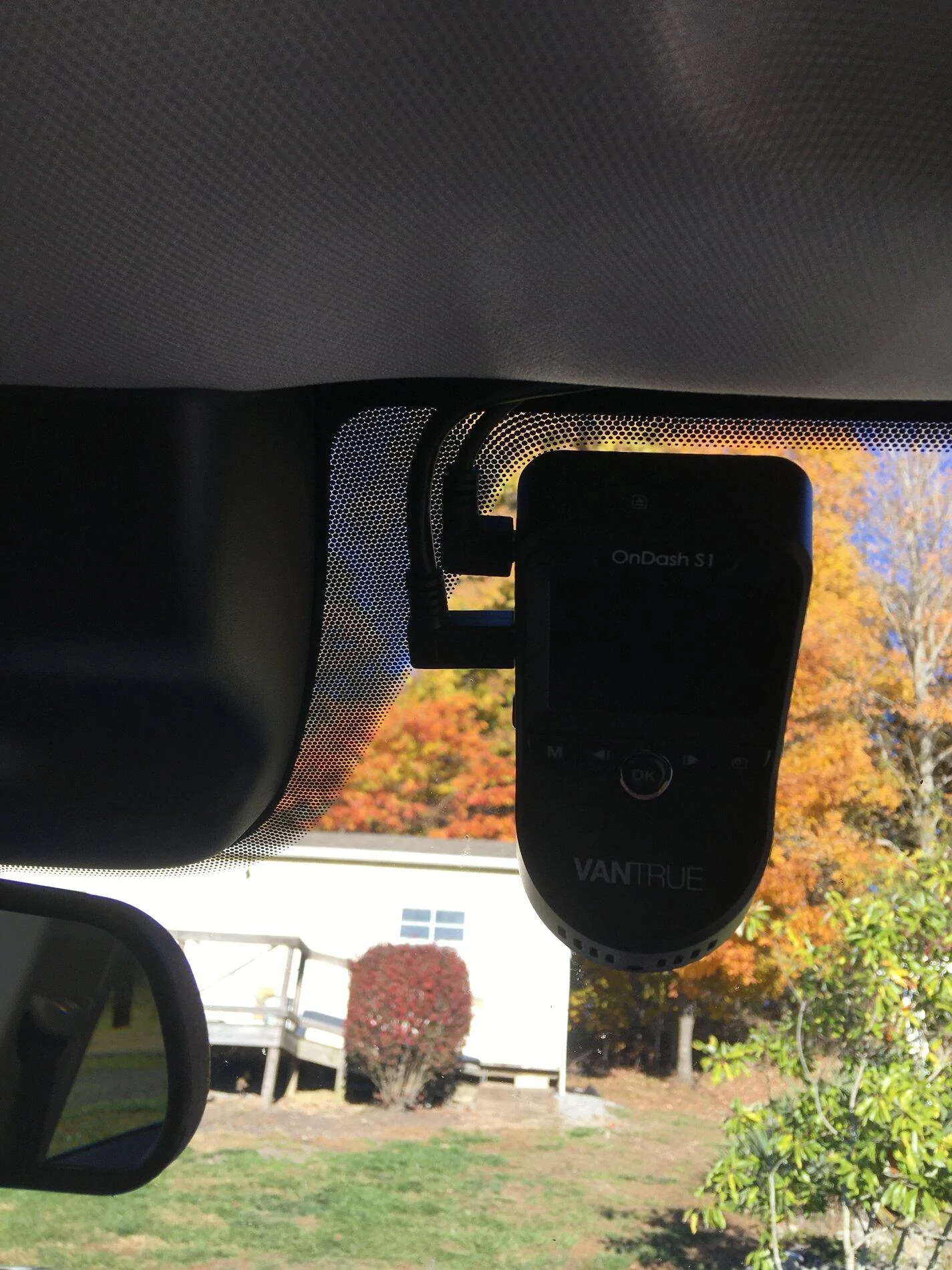

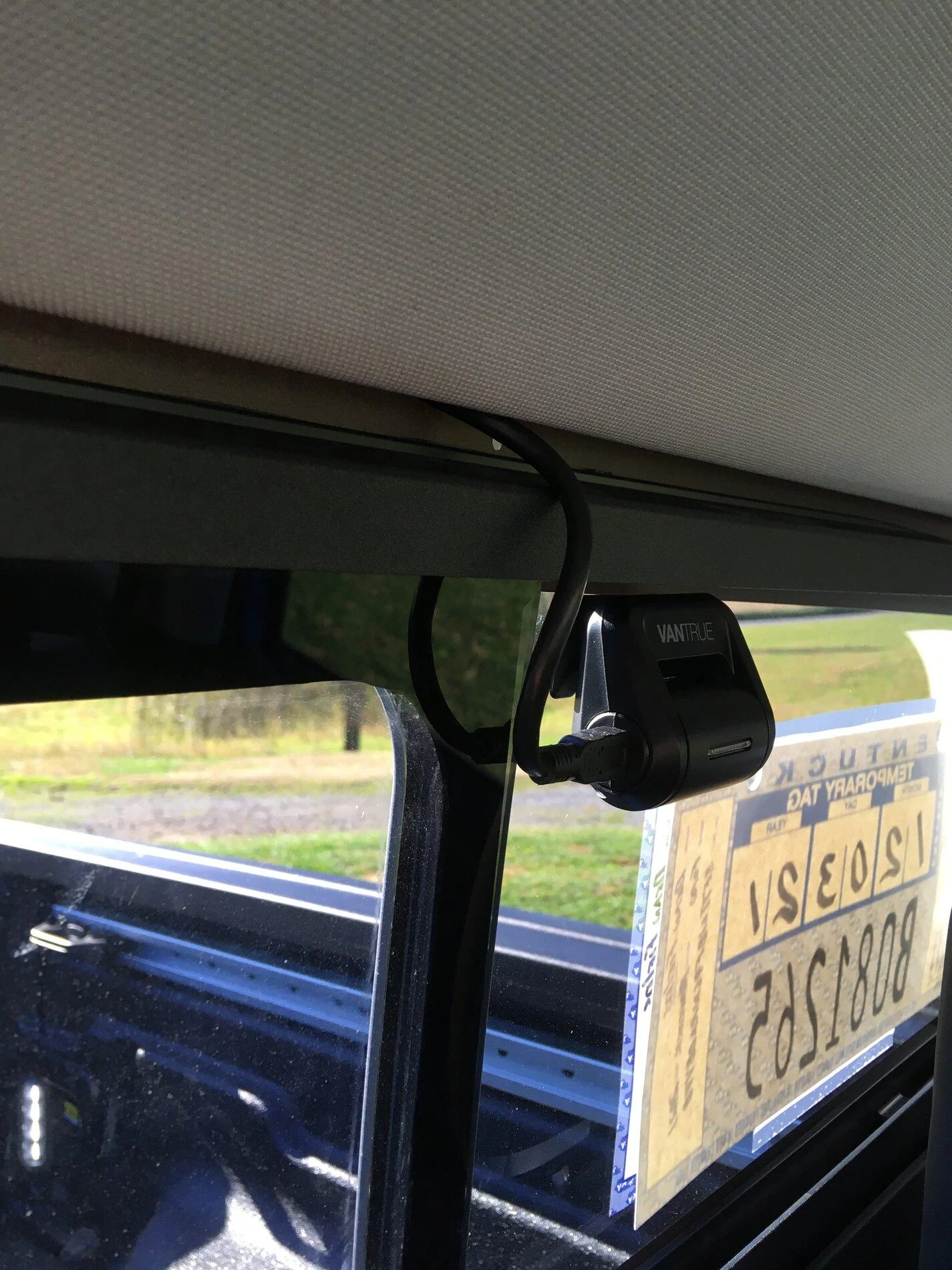

Are there any Maverick owners here who have installed a front and rear dashcam yet? I have one sitting in a box waiting for my Lariat to arrive and I'm curious about where to mount the rear-facing camera. My truck has the auto-sliding rear window and from pics I've seen there doesn't appear to be much room to mount a camera above it. I might have to place it in an offset position but I was hoping someone else on the forums might have done this already and can provide some insight. Thanks.
Ford Maverick Rear Dashcam Location? 5BE4DE97-37CB-41CC-A266-440A2DDA0392
Ford Maverick Rear Dashcam Location? C5DD94F2-44FA-44C6-BEDE-809FED2CCAB7
Ford Maverick Rear Dashcam Location? imag

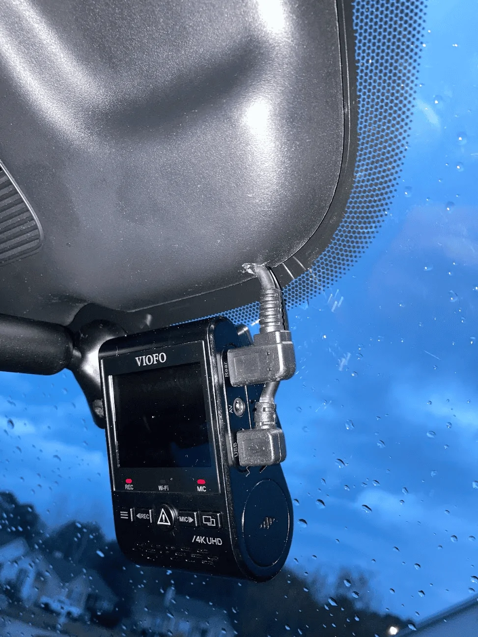

I'm installing a set of VIOFO A139.
I didn't choose rear window, so the back one is going to the top center. (wire is routed inside roof liner)
For the front unit, it's going to be on the left side of back-view mirror, since Viofo camera lens is offset to the right of unit. I did a dry fit, it's well hidden behind the mirror, doesn't obstruct my view.
Now i'm waiting for micro2 fuse tap to come in (amazon) than I can continue the install.

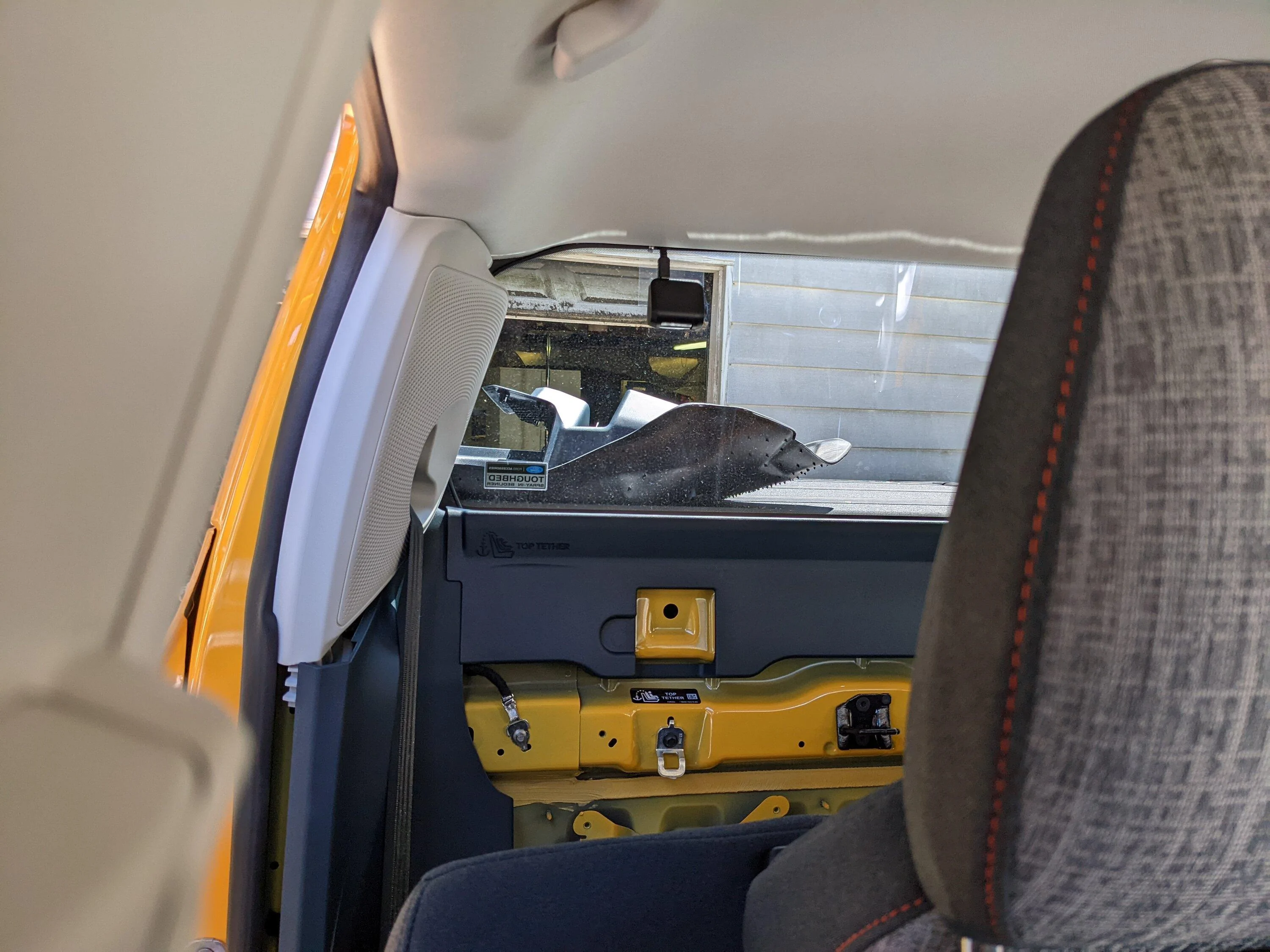

I don't have sliding rear window. But I put my rear one above the rear driver sides rear seat headrest. It is more out of the way looking through the rearview mirror and I was having trouble tucking the wire under the rear headliner A 129 pro duo for me.
It doesnt really throw off the rear video much either
Ford Maverick Rear Dashcam Location? PXL_20220619_190200750

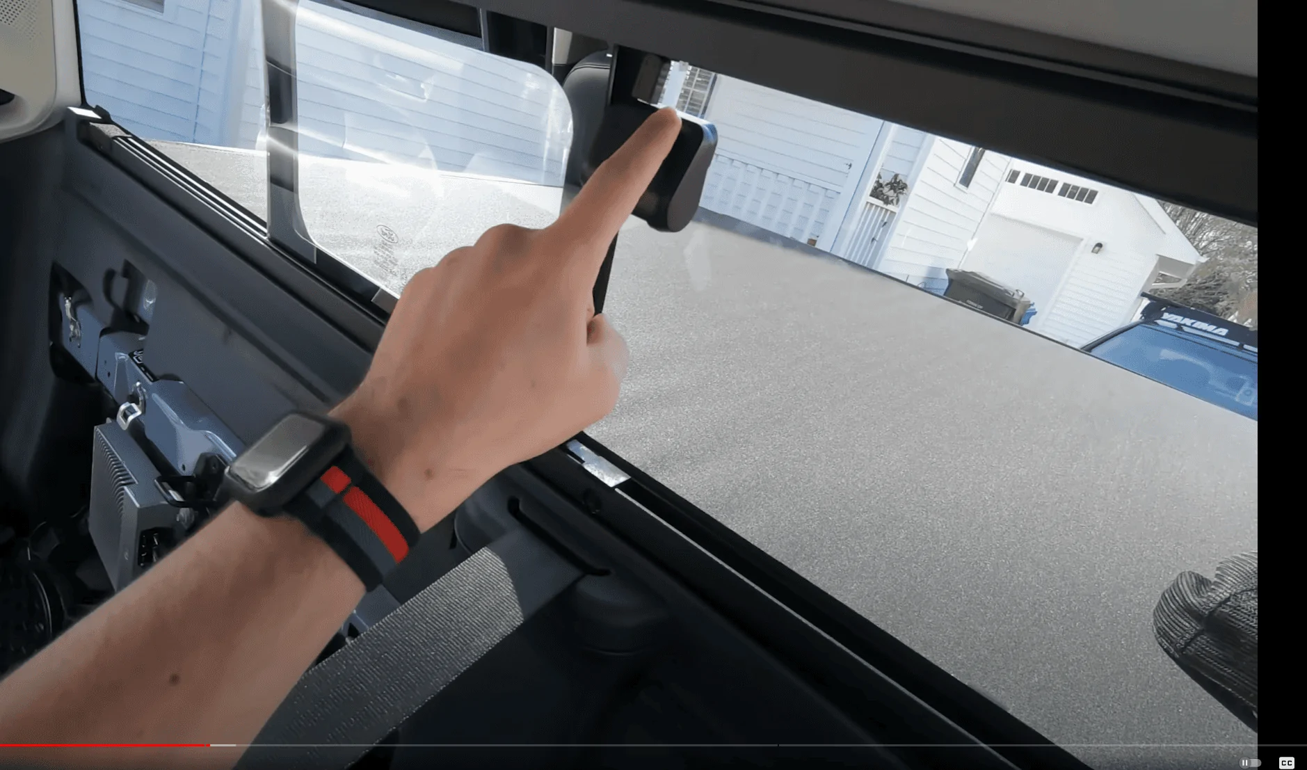

I made a video about hardwiring mine, the video is way too long but maybe you find a useful tidbit of info in there somewhere. For what it's worth I don't really notice the rear dashcam in normal driving, the rear window is so small you only use it for quick glances lol.
Here is an example 15 second clip of front and rear. Pollen was covering the car so it might seem a bit dusty heh. Front is 2160p (4k), rear is 1080p
