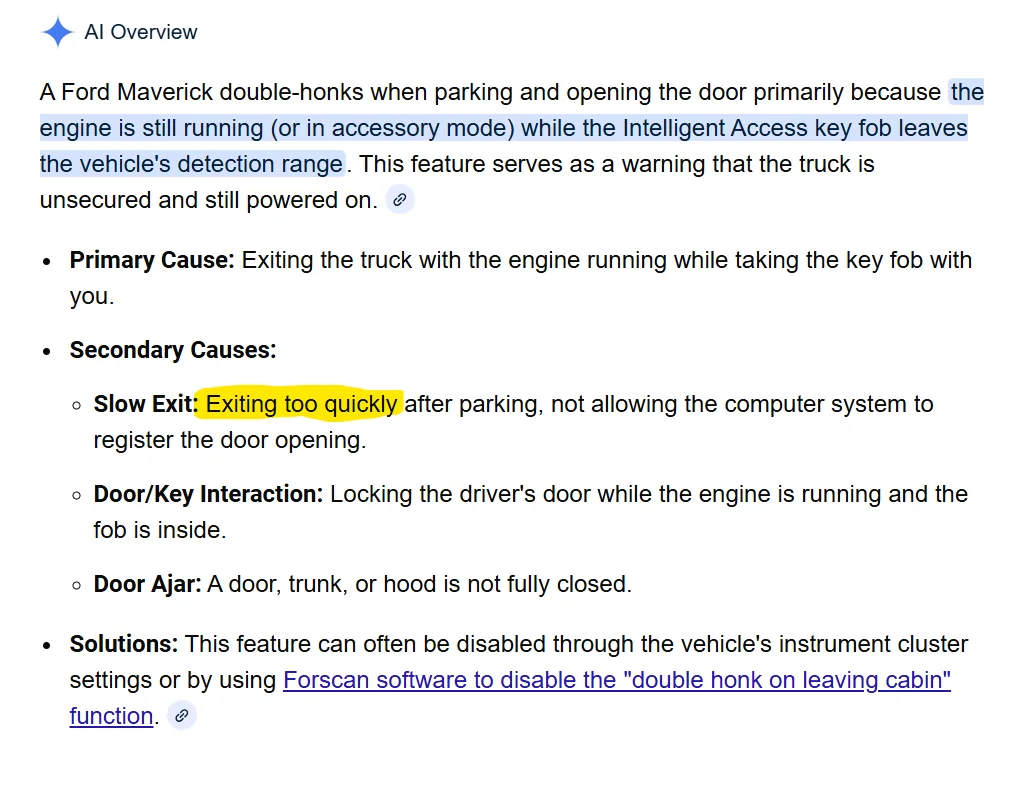

Well, I tried AI, the answer is not 100% worded right but it does support my theory. We may be opening the door to quickly after putting in "park".
