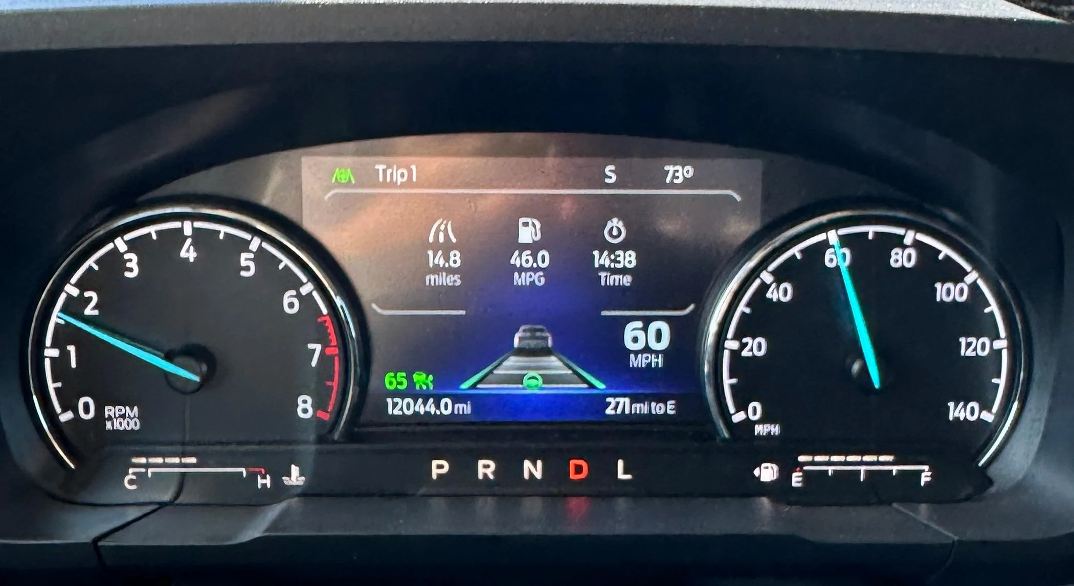

I don't know avout the phone but my radio was working very badly in many ways, freezing up, not remembering what station it was on etc. Took it to Sykora Ford in West, TX and they removed the operating system and reinstalled a new one. They also installed other updates to the main computer now the radio works perfectly and has no problem linking to my iphone 14. Driving back home from the dealer about 15 miles on I 35 I got 46mpg according to the dash computer. 2023 lariat, ecoboost, 4k tow, AWD.

Does that seem reasonable? 46 mpg for an EcoBoost? That's about what I get on my hybrid. I'd be curious to hear what you calculate it to be when you actually fill up the tank (if you actually calculate it manually).
