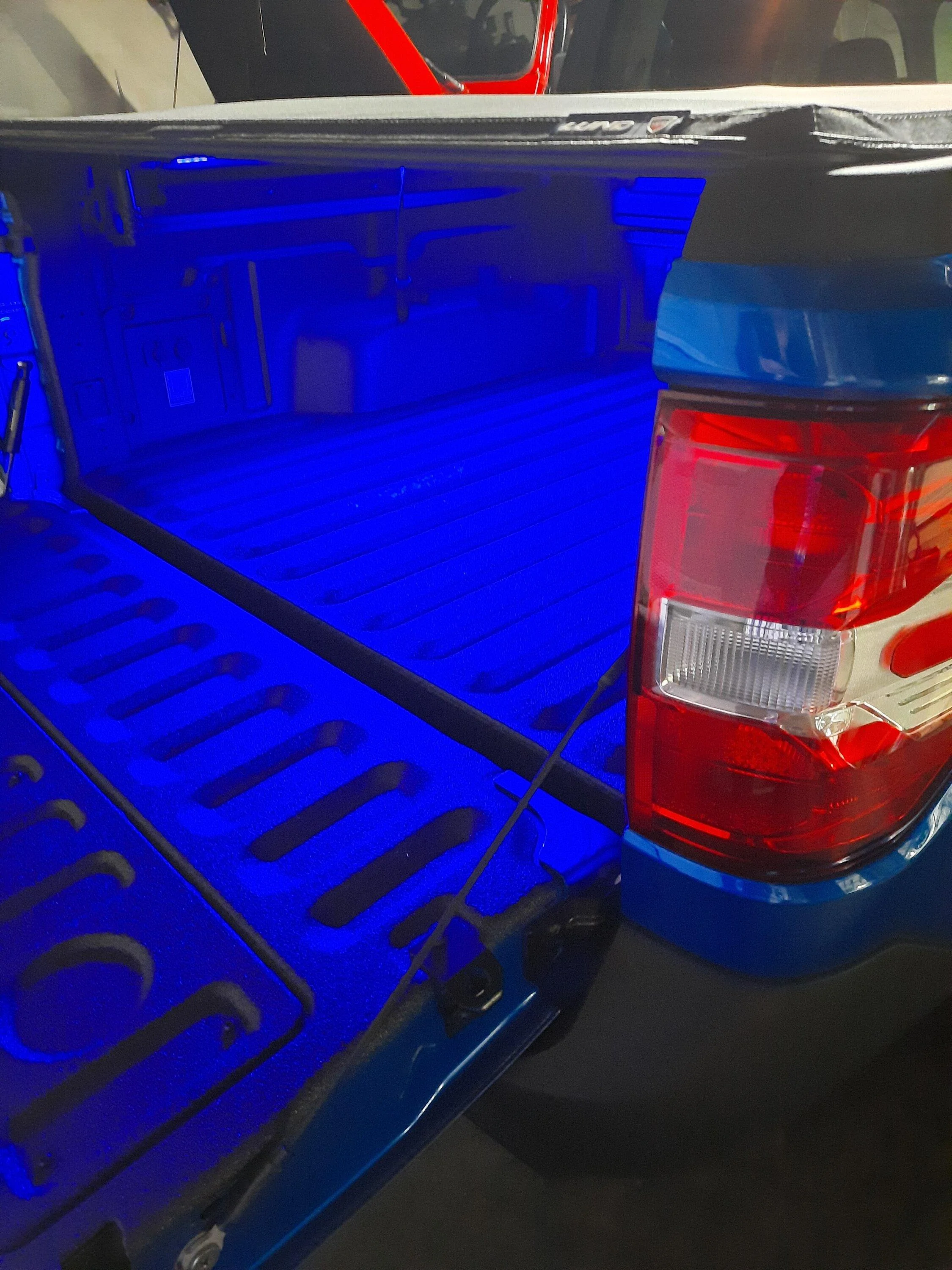

I want more picturesYeah, I was installing bed lighting LED strips and it stayed active till I finished

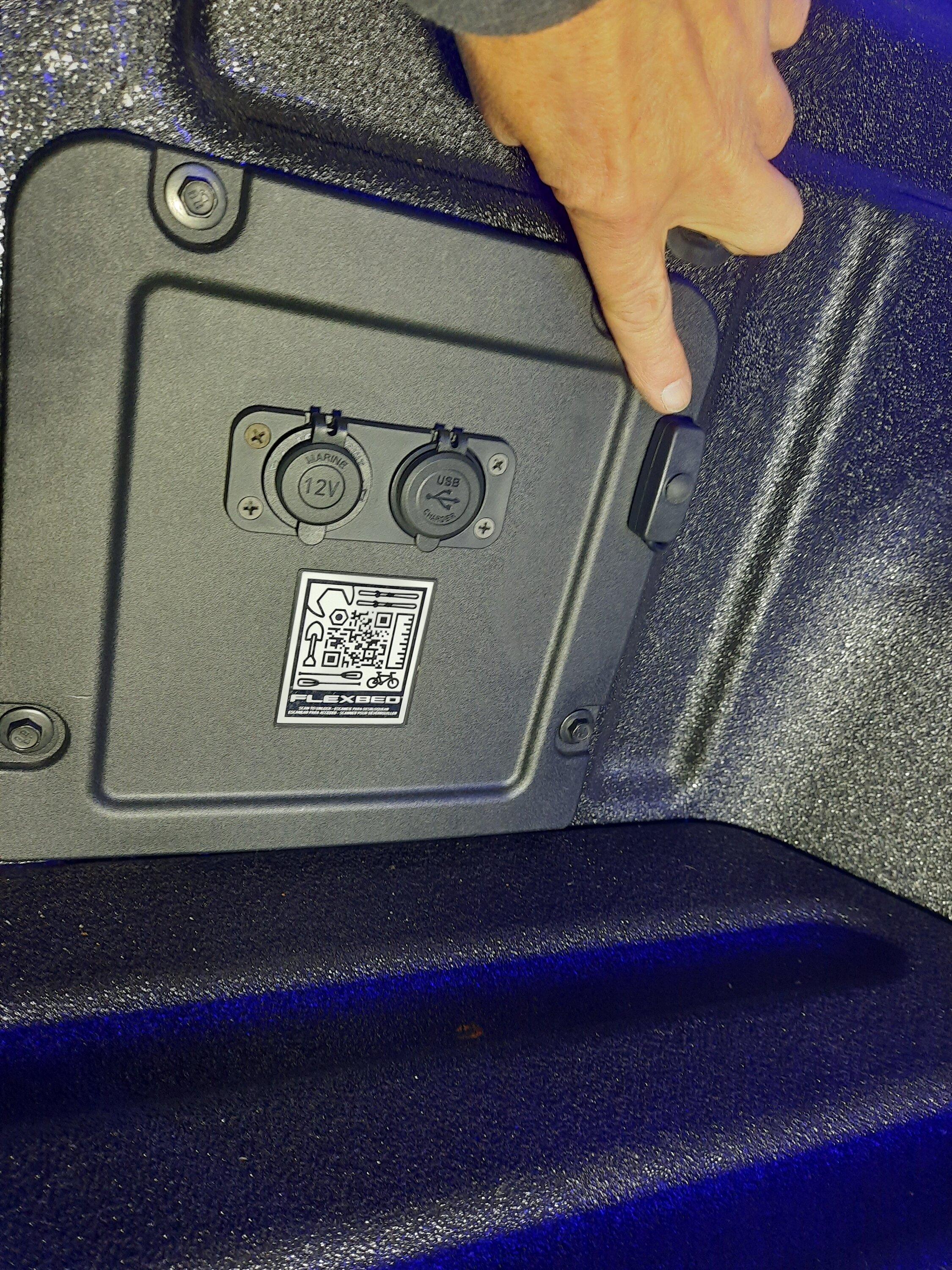

pointing at bed light switch beside usb n 12V power. Front DRL'sI want more pictures
do you happen to have links to the al the parts you used for the bed LEDs and the USB/12V power ?pointing at bed light switch beside usb n 12V power. Front DRL's
I believe that the On time can be changed in Forscan. Check other threads to confirm.Mine stayed active while installing led lights then turned off. I was confused and pulled the fuse and rewired the lights. Then found that they do indeed shutoff around 15-20 minutes

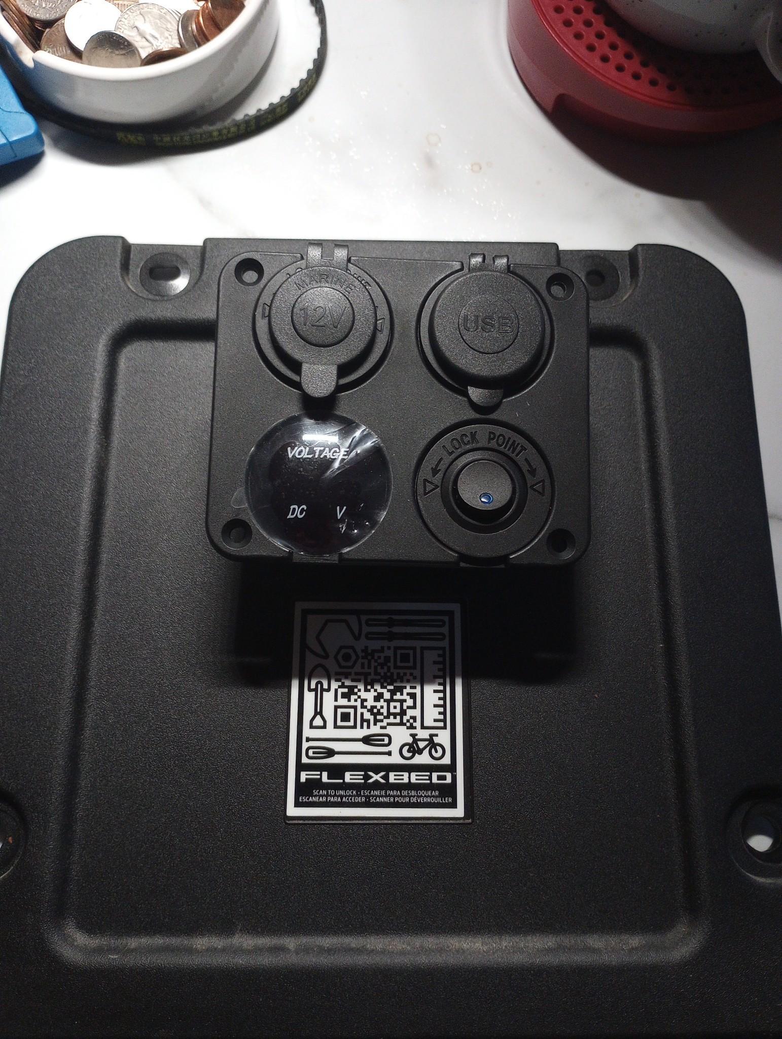

FWIW. So I just installed my USB, power point, volt meter and switch yesterday. I have an XL. After the install I thought I would test the 15-20 minute on time. I fould that mine goes off when the key is turned off. I also wired it to turn bed lighting on and off with that switch once I get them. The other 3 items are wired to come on, when power is applied when the truck is on.I'm thinking of using this auto-off-after-x-minutes feature to wire a lit switch to my DIY bedight project.
