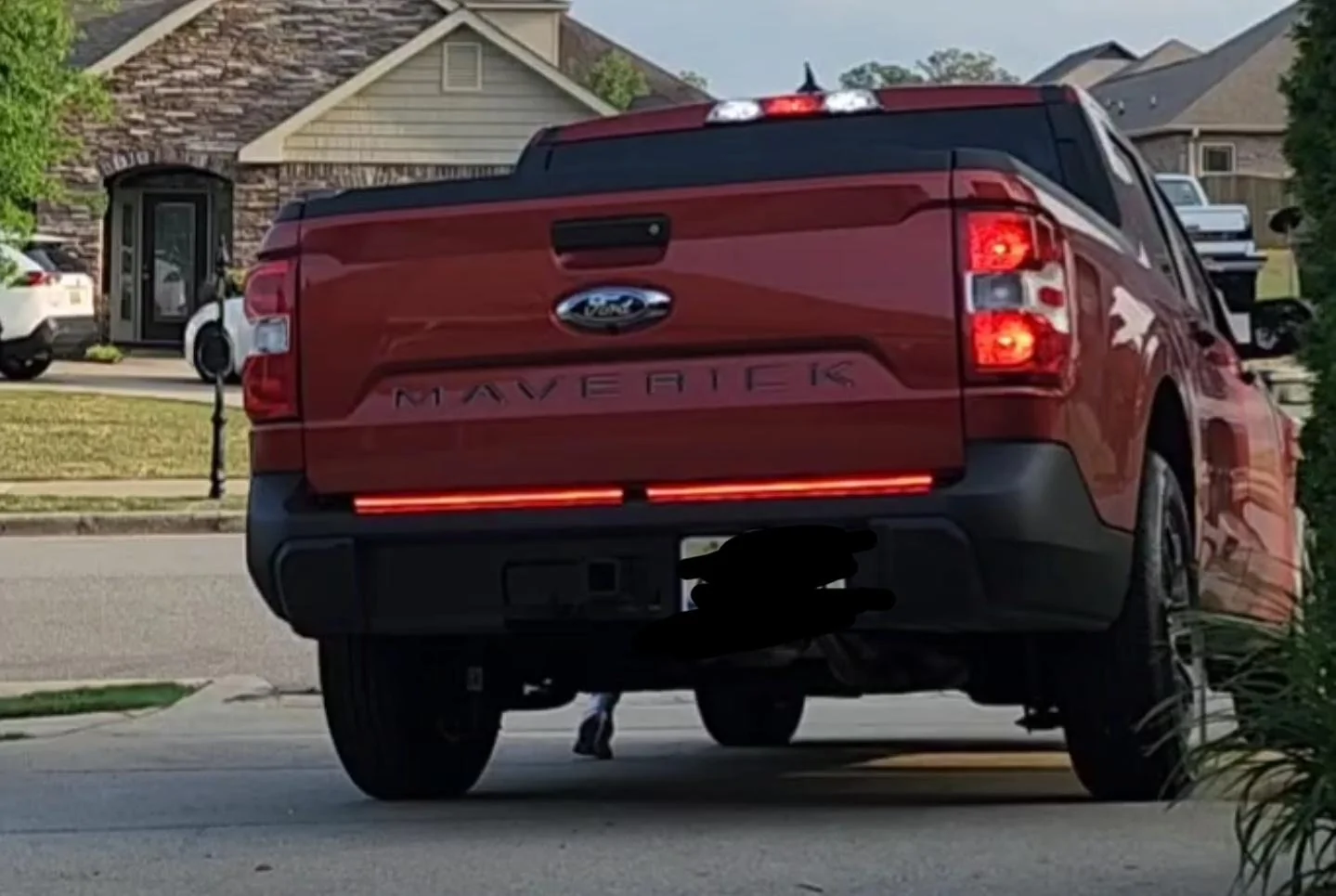

So this past week I had a similar situation. A driver pulled up beside me to tell me I had a tail light out on the drivers side. Had the wife stand behind the truck and found everything works except the tail light. If I turn the lights off and back on quickly it illuminates for a few seconds and then back off again.
I think I need to make an appointment to get my truck in again to have this looked at. Traveling currently and stumbled on this thread while researching.

I had the bar installed on my truck at the dealership. Going to take it back today due to the same issue. Do you remember which wire it was? Thanks
Ford Maverick Problems with tail lights Snapchat-2039968477
