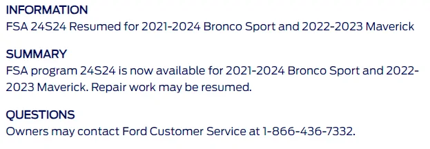

According to Consumer Reports, FSA 24S24 applies to:
• Ford Maverick pickup trucks manufactured between Feb. 3, 2021, and Oct. 28, 2022
This came out today to dealers:
